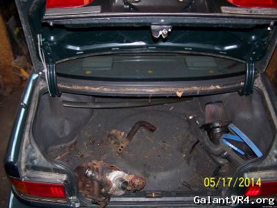

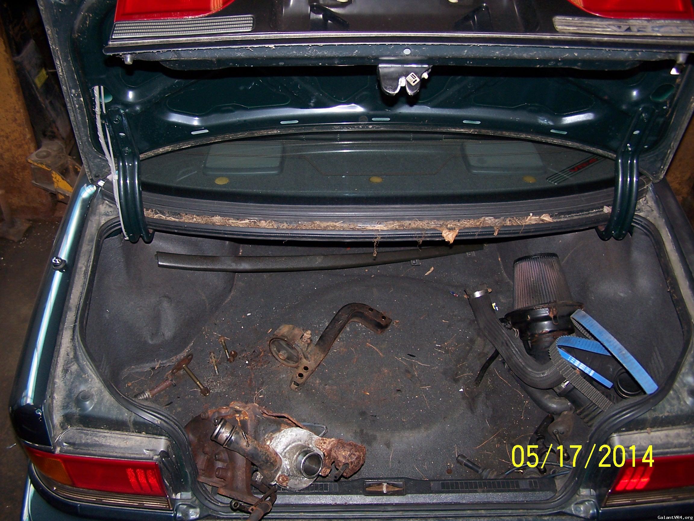

The car is completely un-modded and the head and various parts are in the trunk. I'll probably just grab a head off one of the N/A motors I have laying around and put it back together stock. The cylinders look amazingly clean considering the car was supposed to have been sitting like this for a year. It needs paintwork, and some metal patching on the bottom, but I think I'll have it ready for DD duty by the end of the summer.

So far I've had a head cleaned and milled for it at my local machine shop. Then I lapped the valves, and replaced the valve seals, and transferred the stock "C" cams from the Gvr-4 head. I've spent a lot of time digging engine parts out of the trunk, cleaning them, media blasting them, and painting them. The car is filthy with mouse droppings in the dash and HVAC system, and 20+ years of grease in the engine bay.

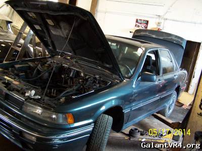

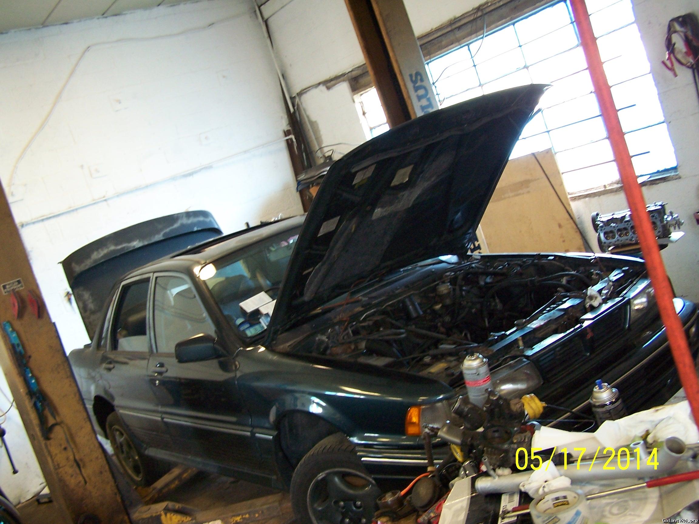

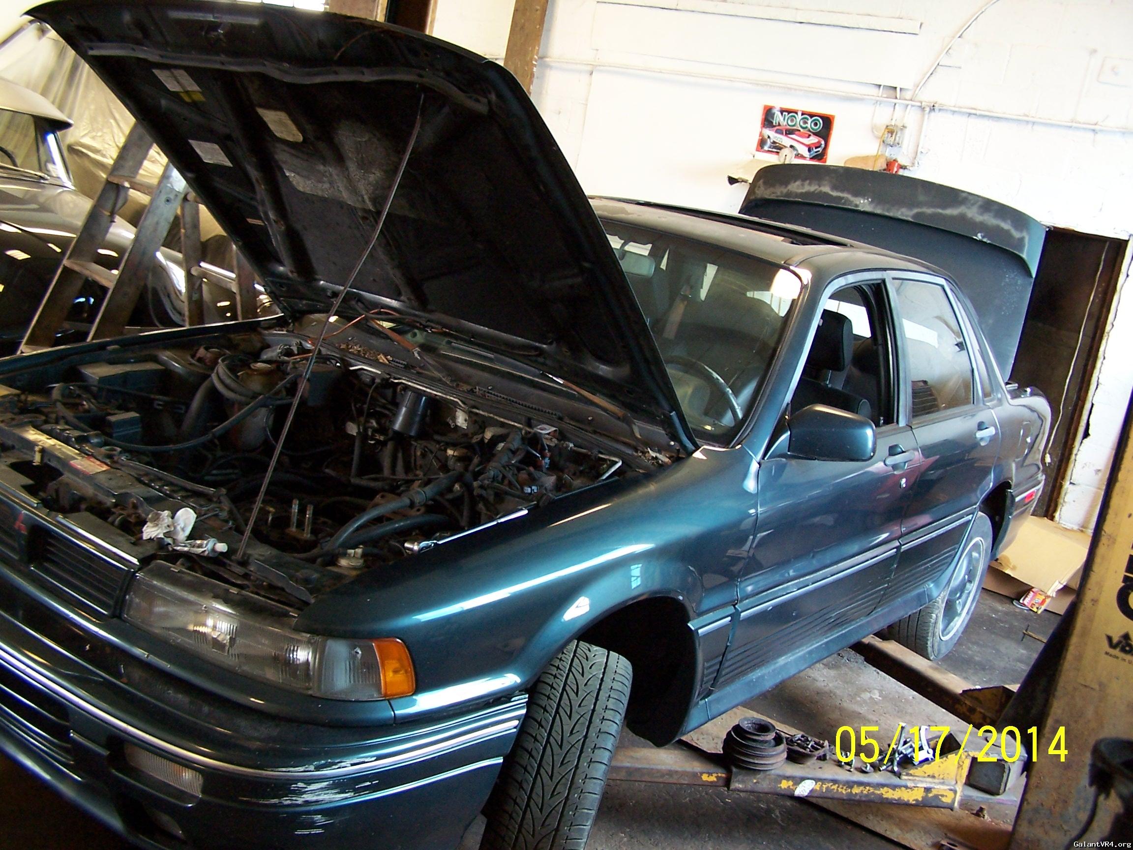

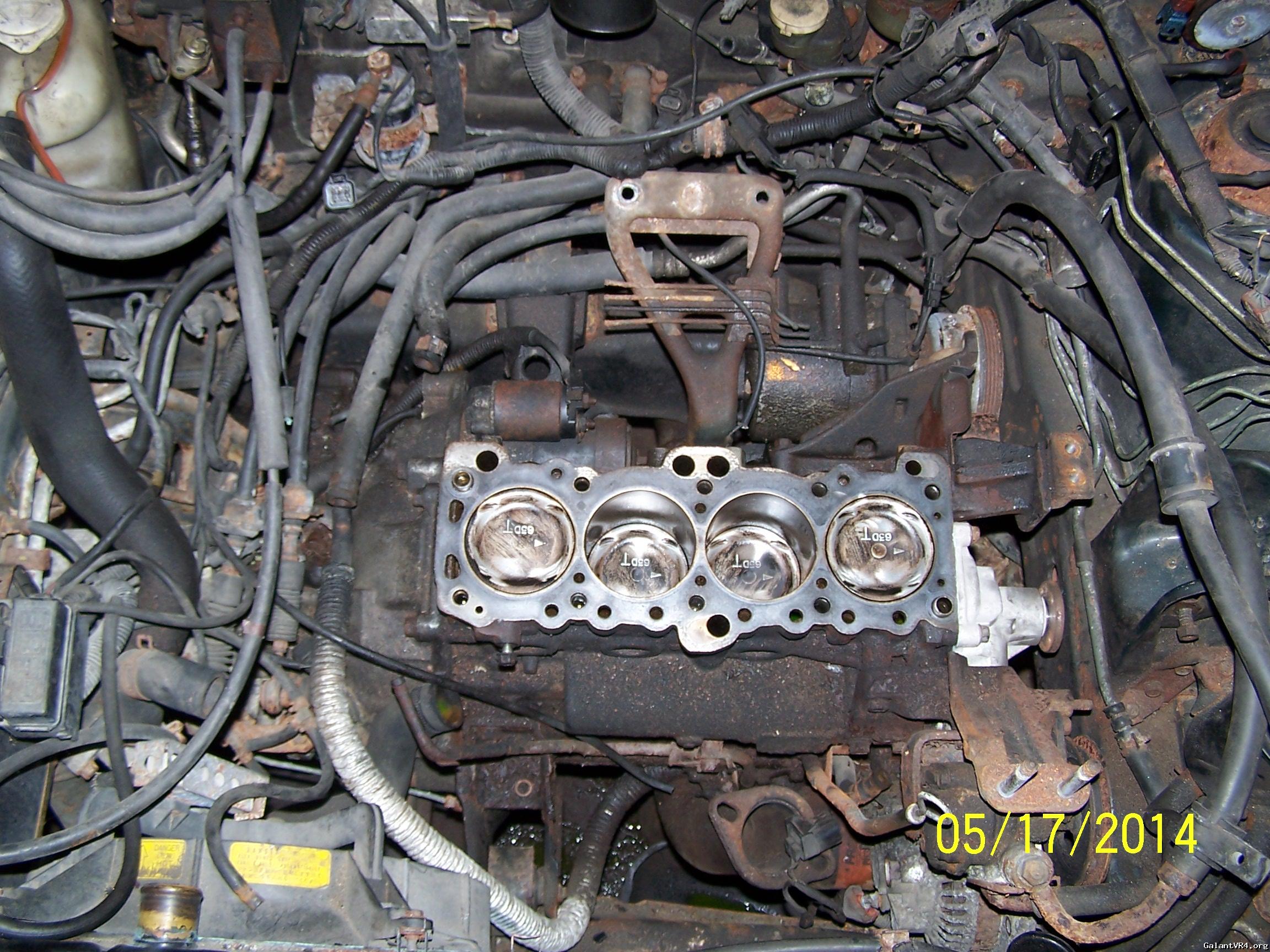

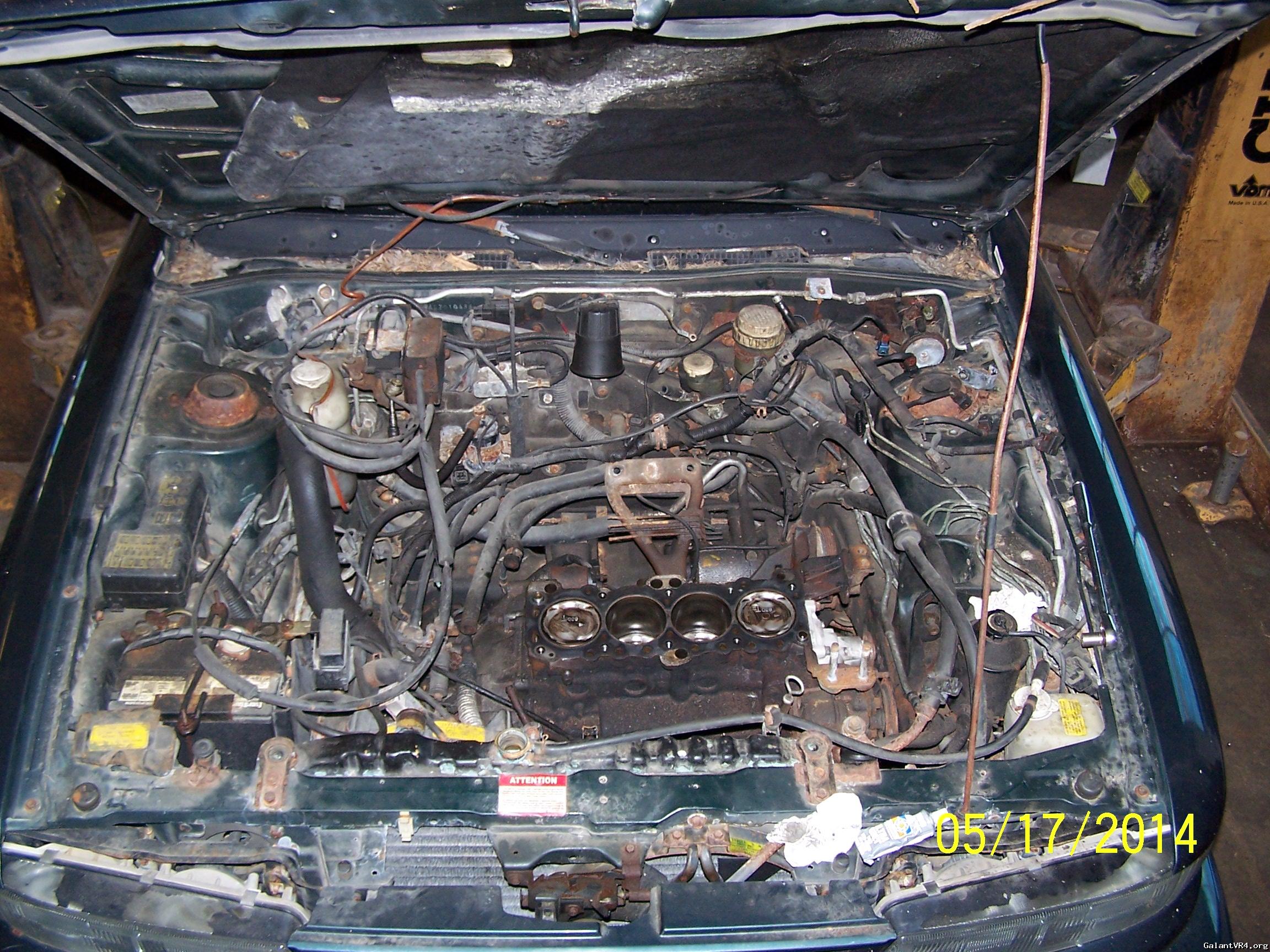

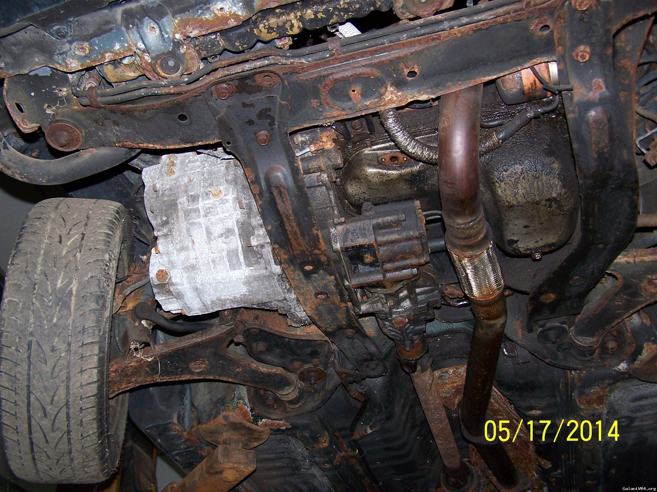

Here's how the engine bay looks; all I've done so far in this picture has been pull off the lower timing cover, and water pipe, and replace the water pump. I've also cleaned the cylinders, and oiled the rings.

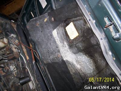

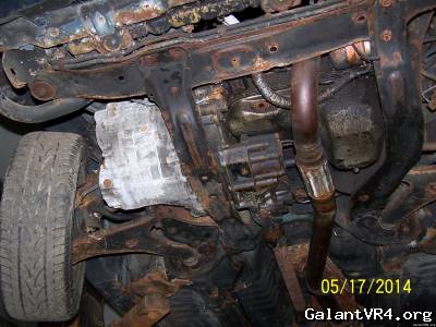

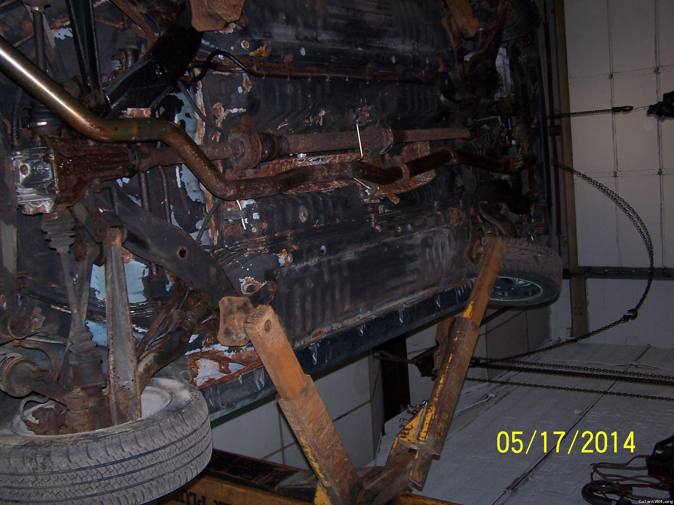

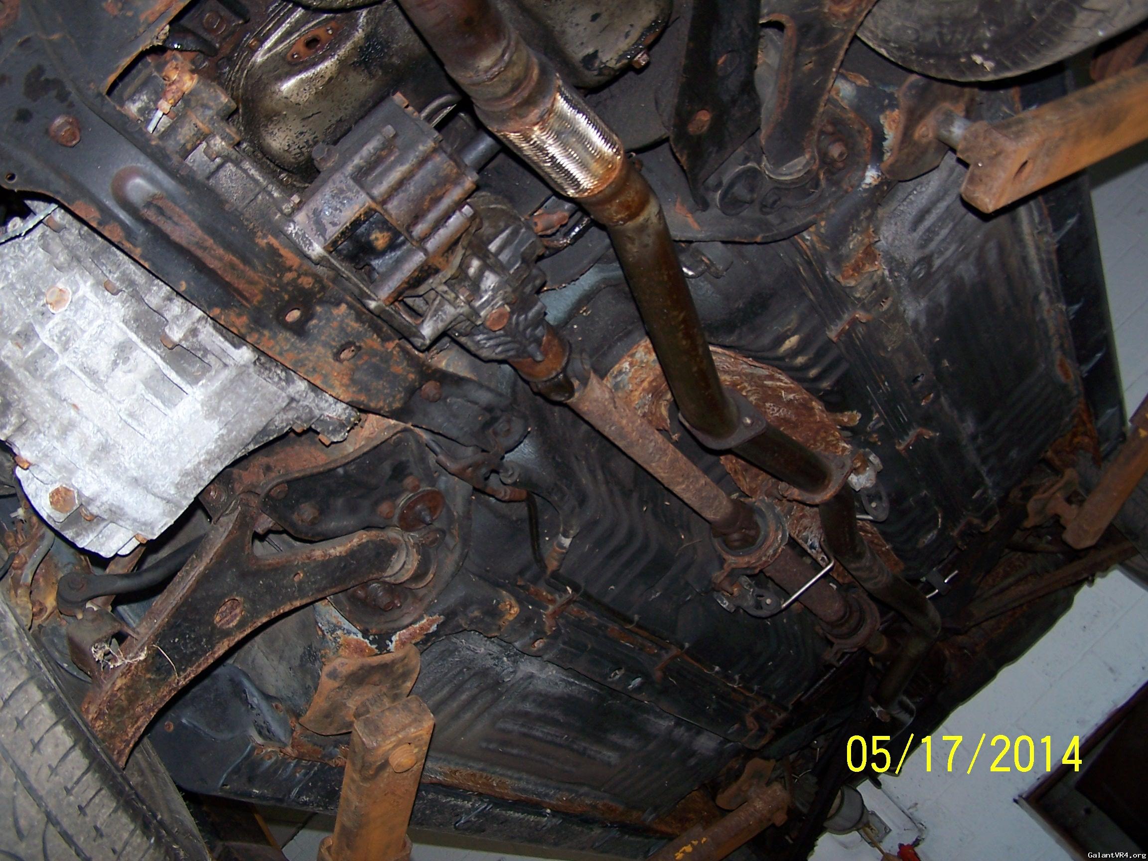

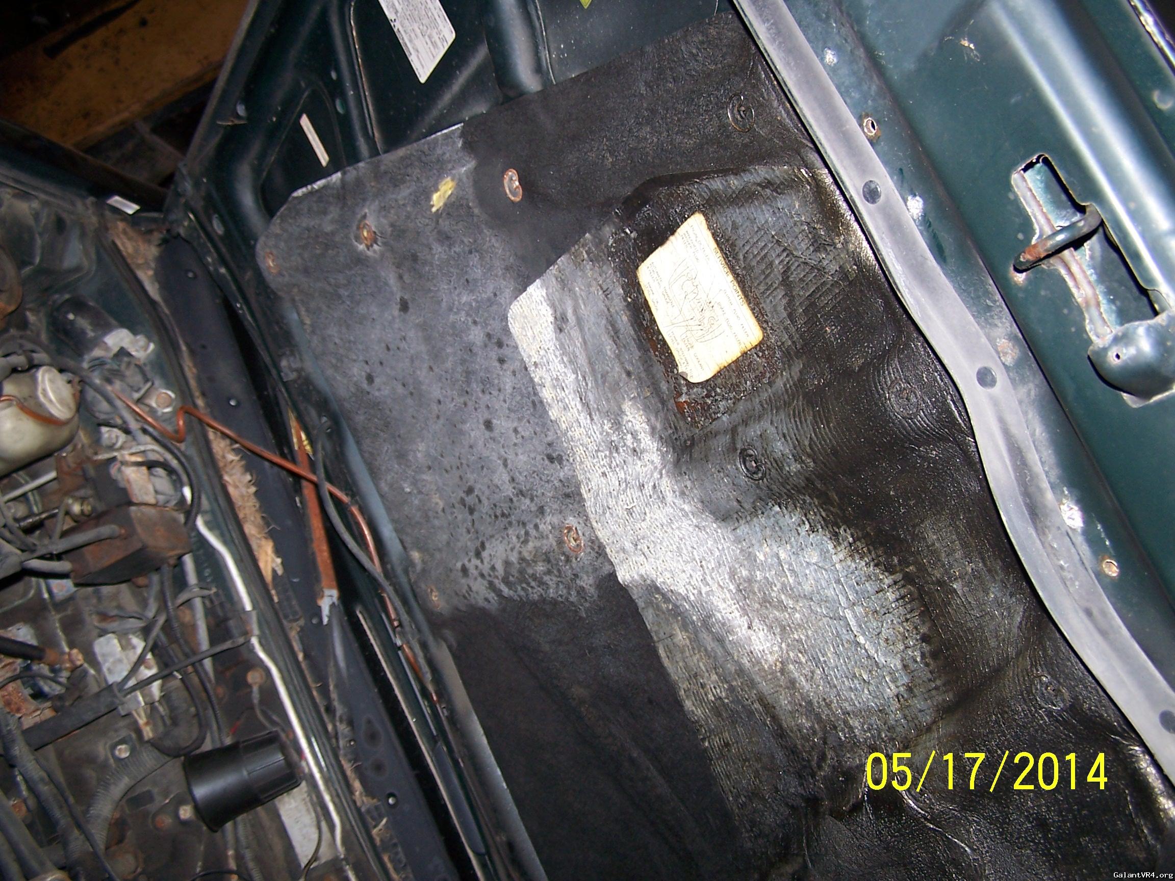

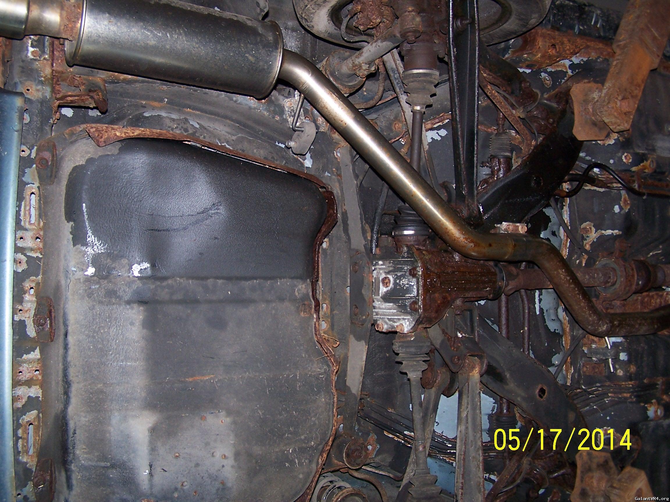

The body is easily salvageable, but needs some welding just in front of the rear wheels.

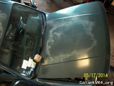

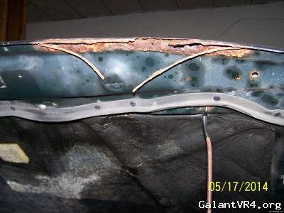

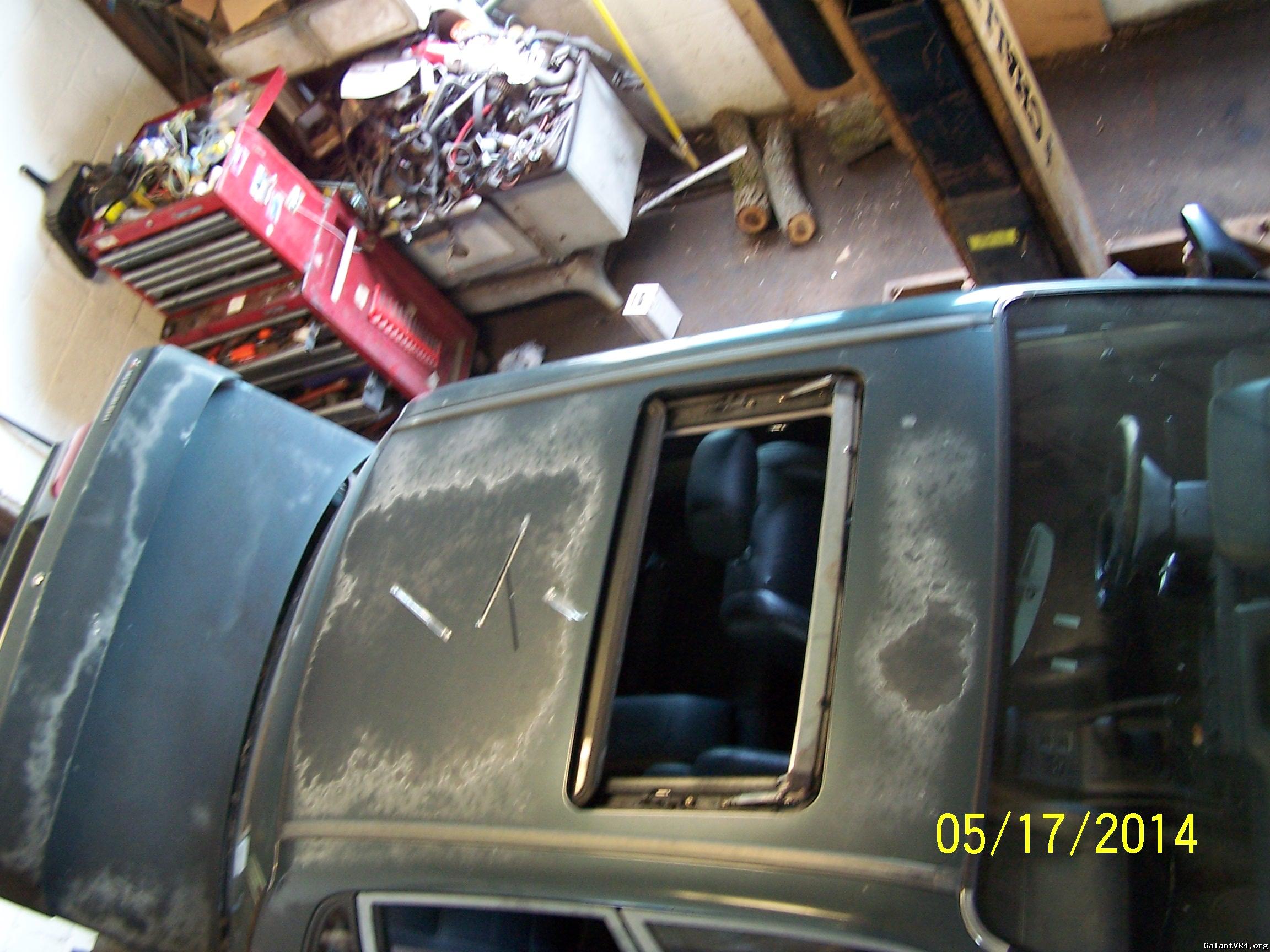

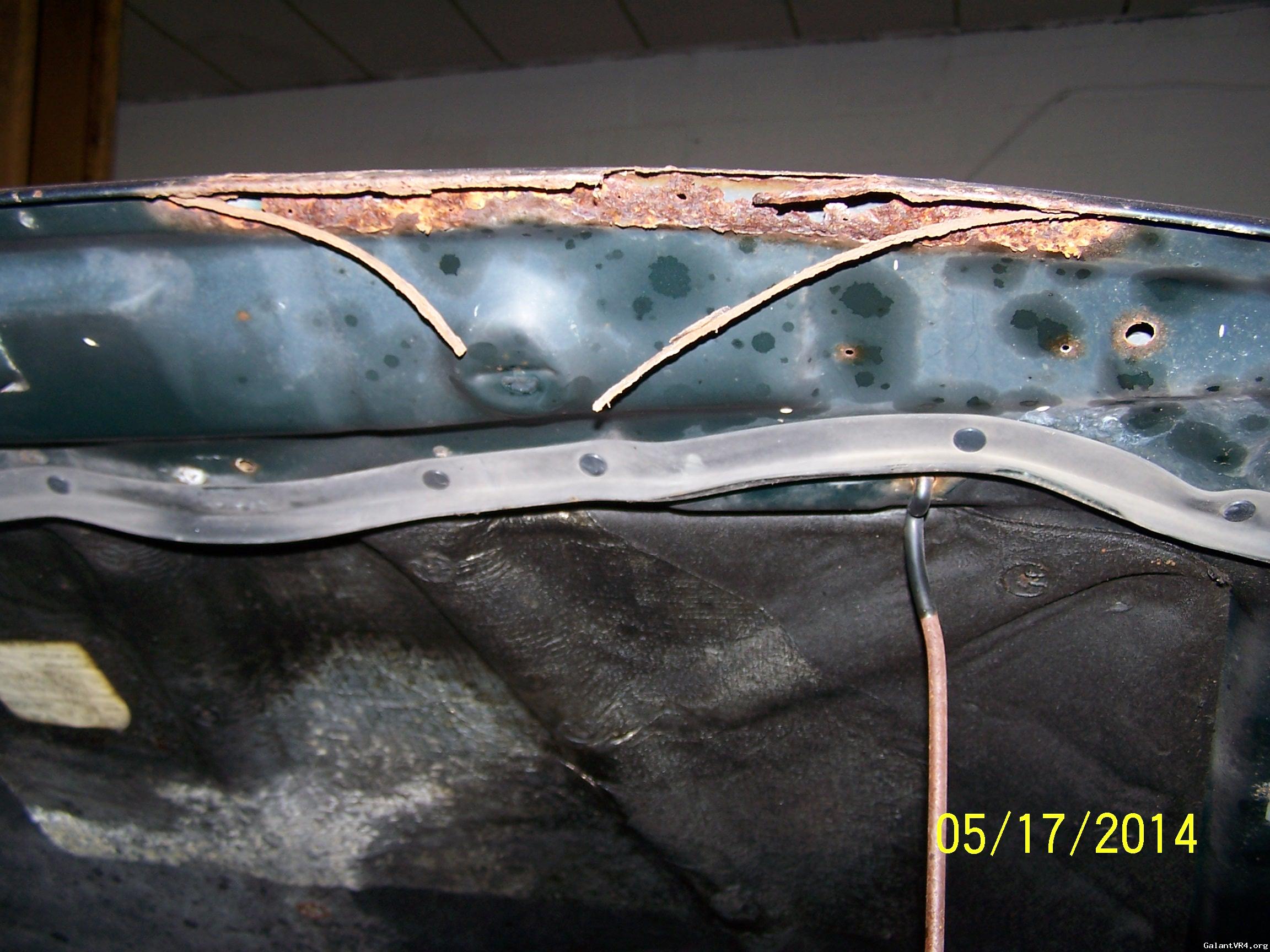

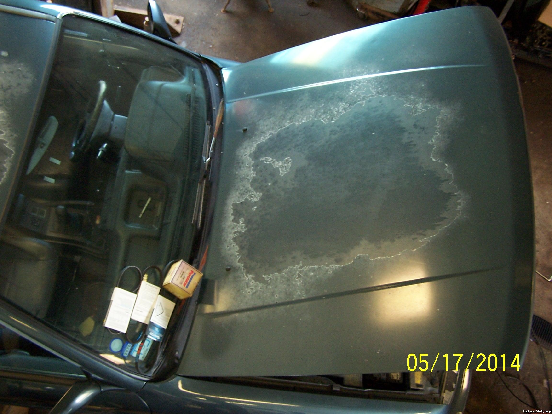

Up top there's barely any rust to be found, but it has quite a few door dings, peeling clear, and one badly rotted spot on the hood.

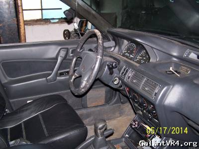

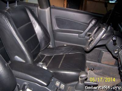

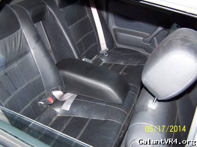

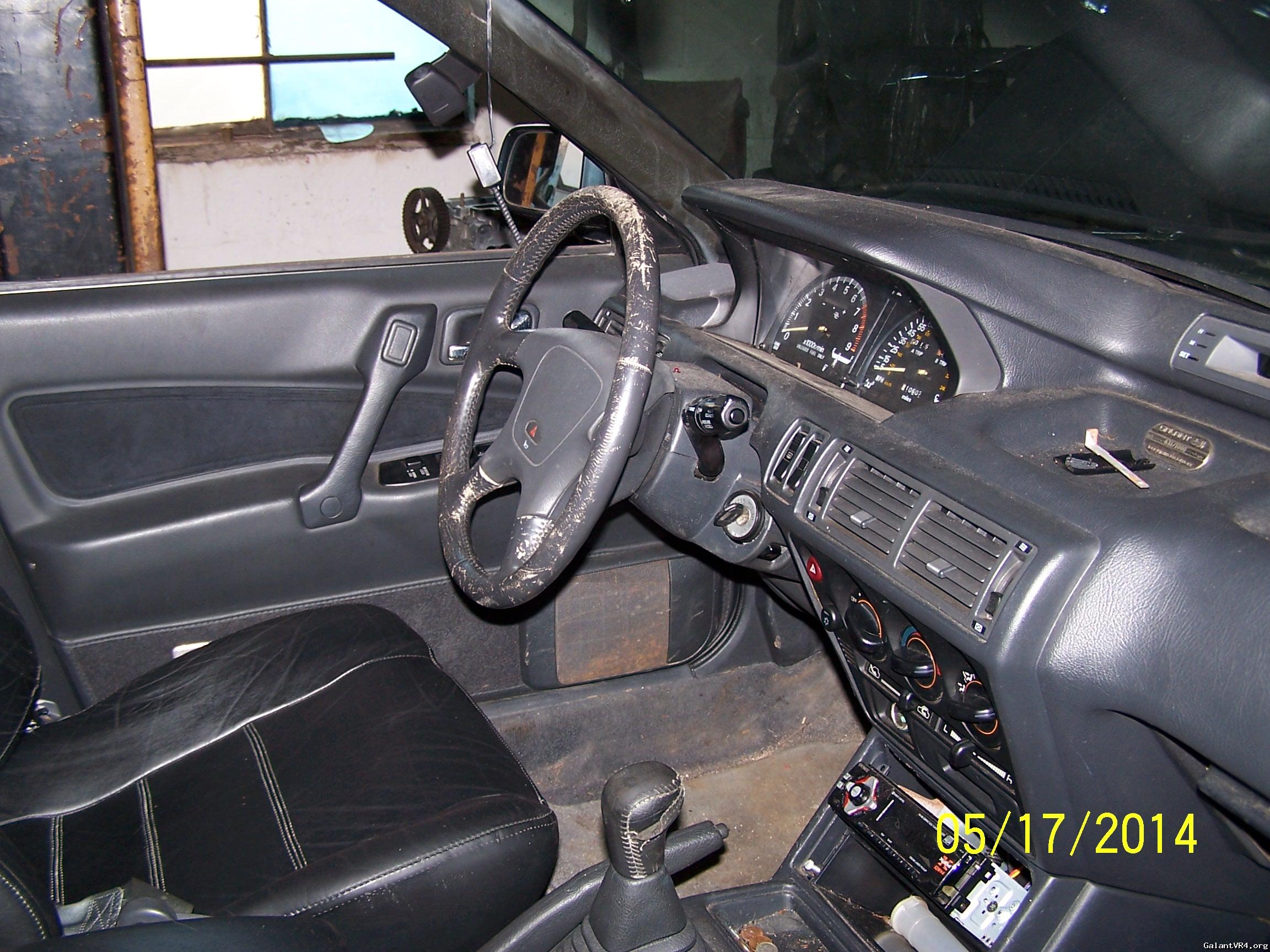

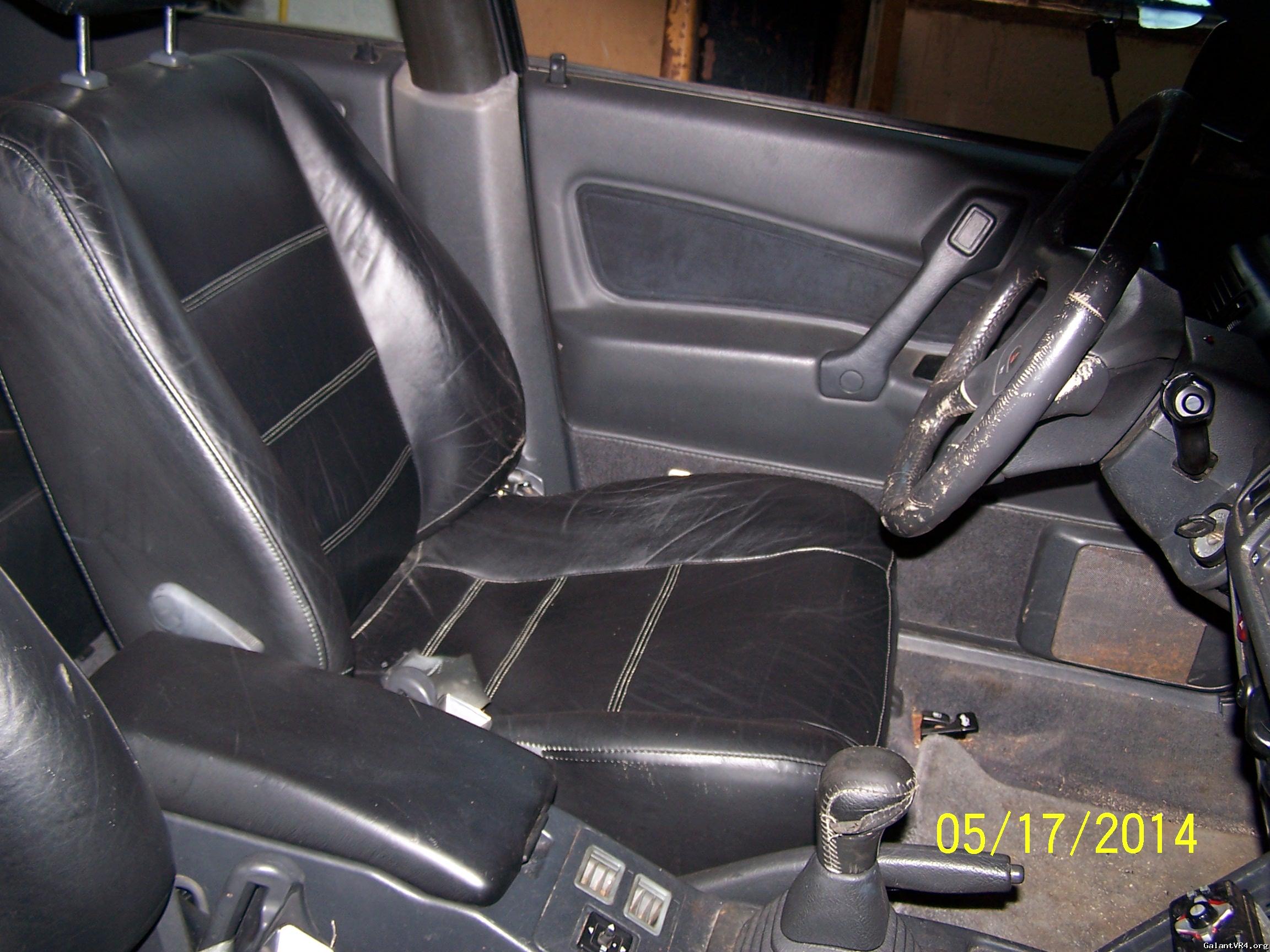

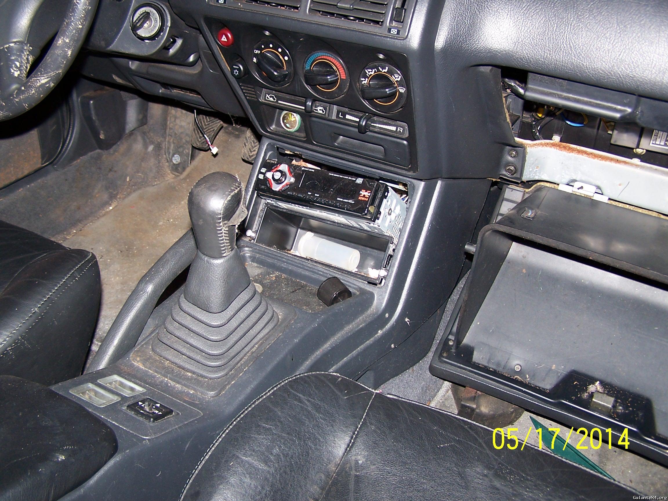

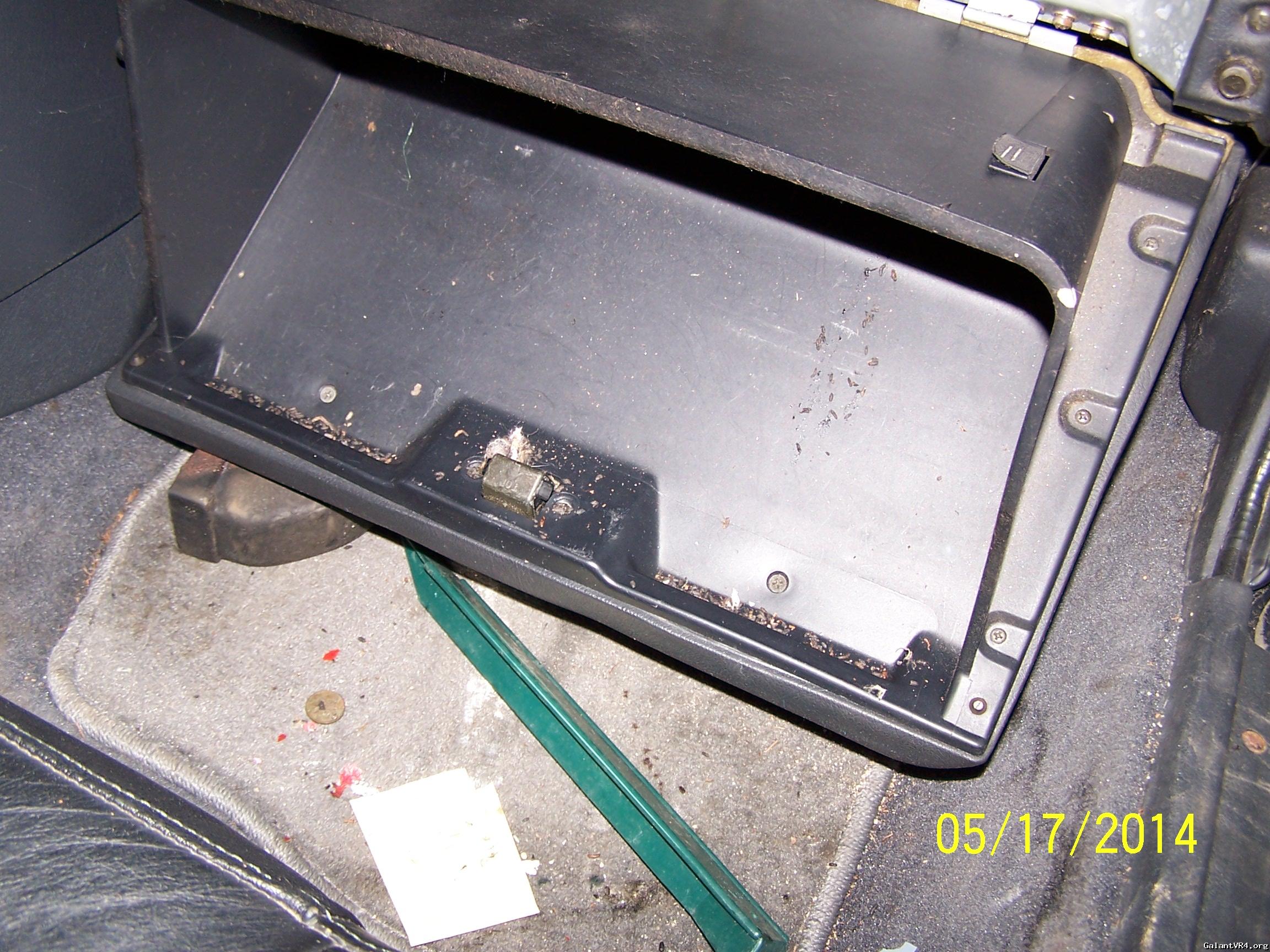

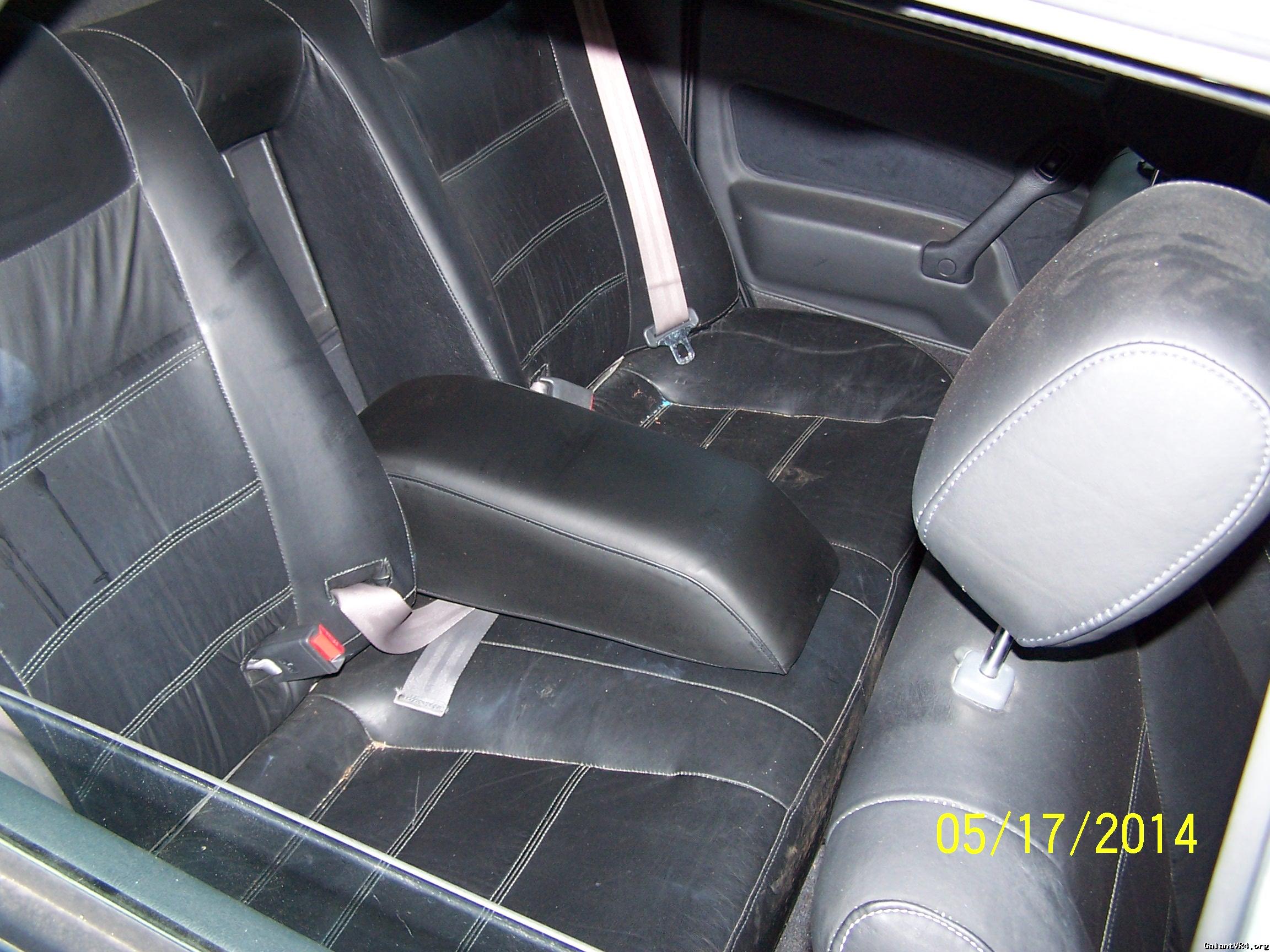

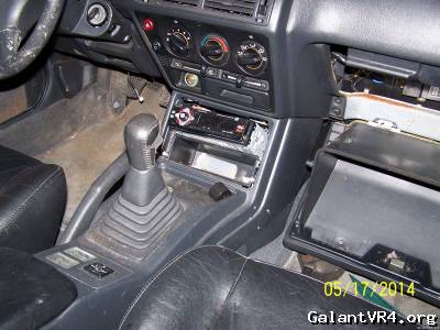

The interior is one of this cars most redeeming qualities, and the glove box came fully stocked with more rodent feces than I'll ever need.
