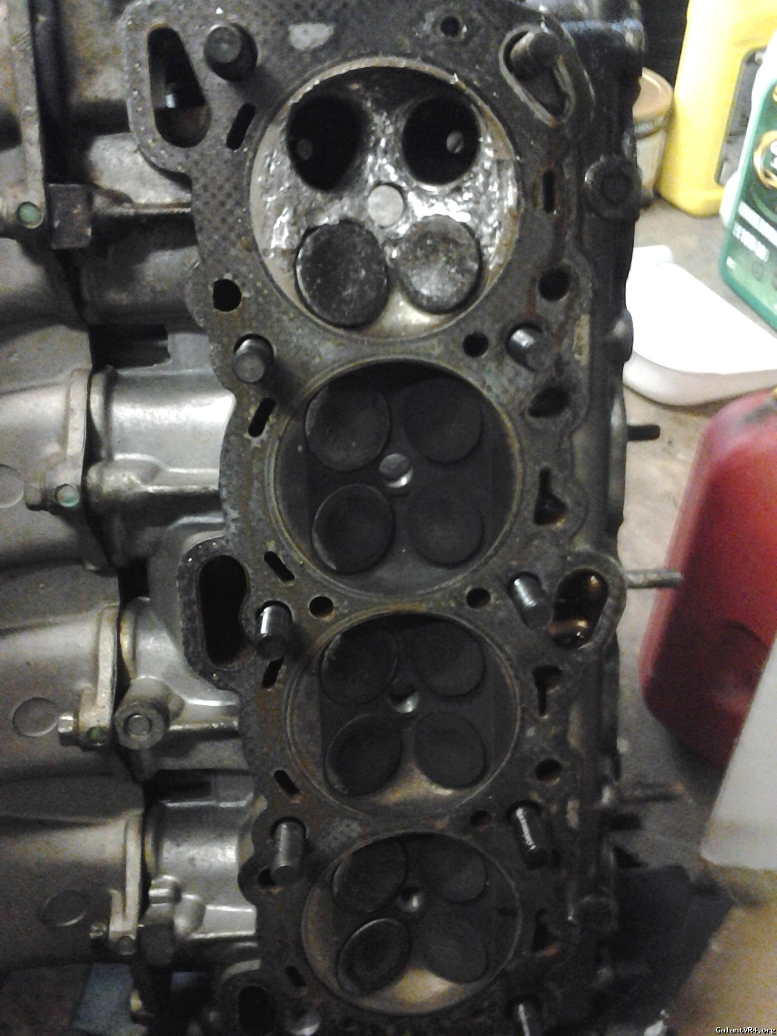

I'm not exactly sure what happened. When I pulled the covers off the timing belt, the belt was off a few teeth, but I didn't think enough to bend the valves. I took a look down cylinder #1 spark plug hole and could actually see the valve it was bent so bad! So I'm not sure it it was a result of the timing belt being off or if the valve was "sucked". I'm suspecting the latter. Valve cover is coming off next, so we will see. I'm hoping the bottom end is still in ok shape.

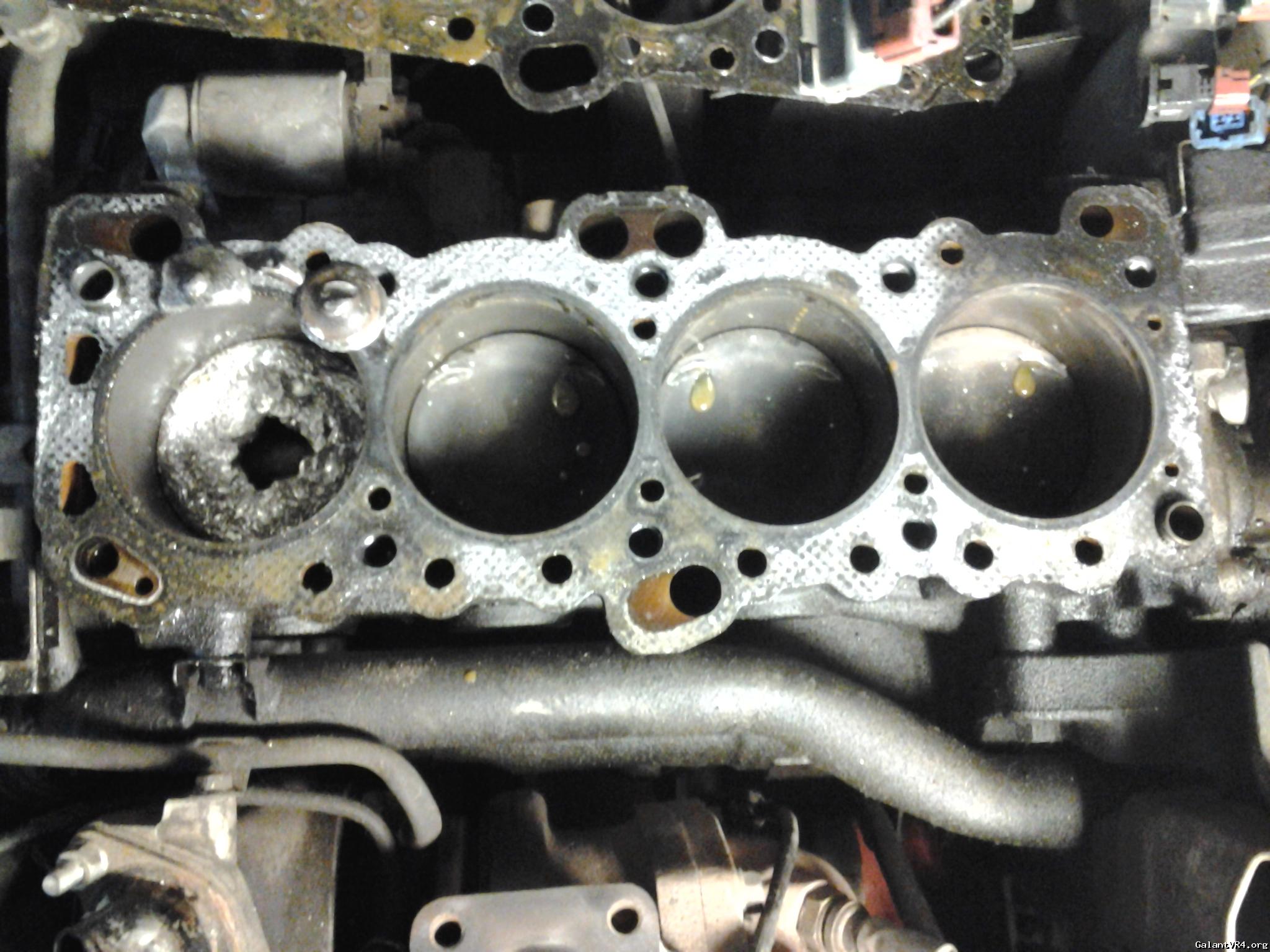

Found out why the car won't run today. I'll be needing a new cylinder head and maybe a new block. I have no idea how this happened.
Welcome,congrats on both the new baby and vr. I bring my kids to school in my car all the time they love to boost.
Wow,that looks like the guy who you got it from dropped something in there and didn't realize it and ran it check the turbo for metal or messed up blades.
