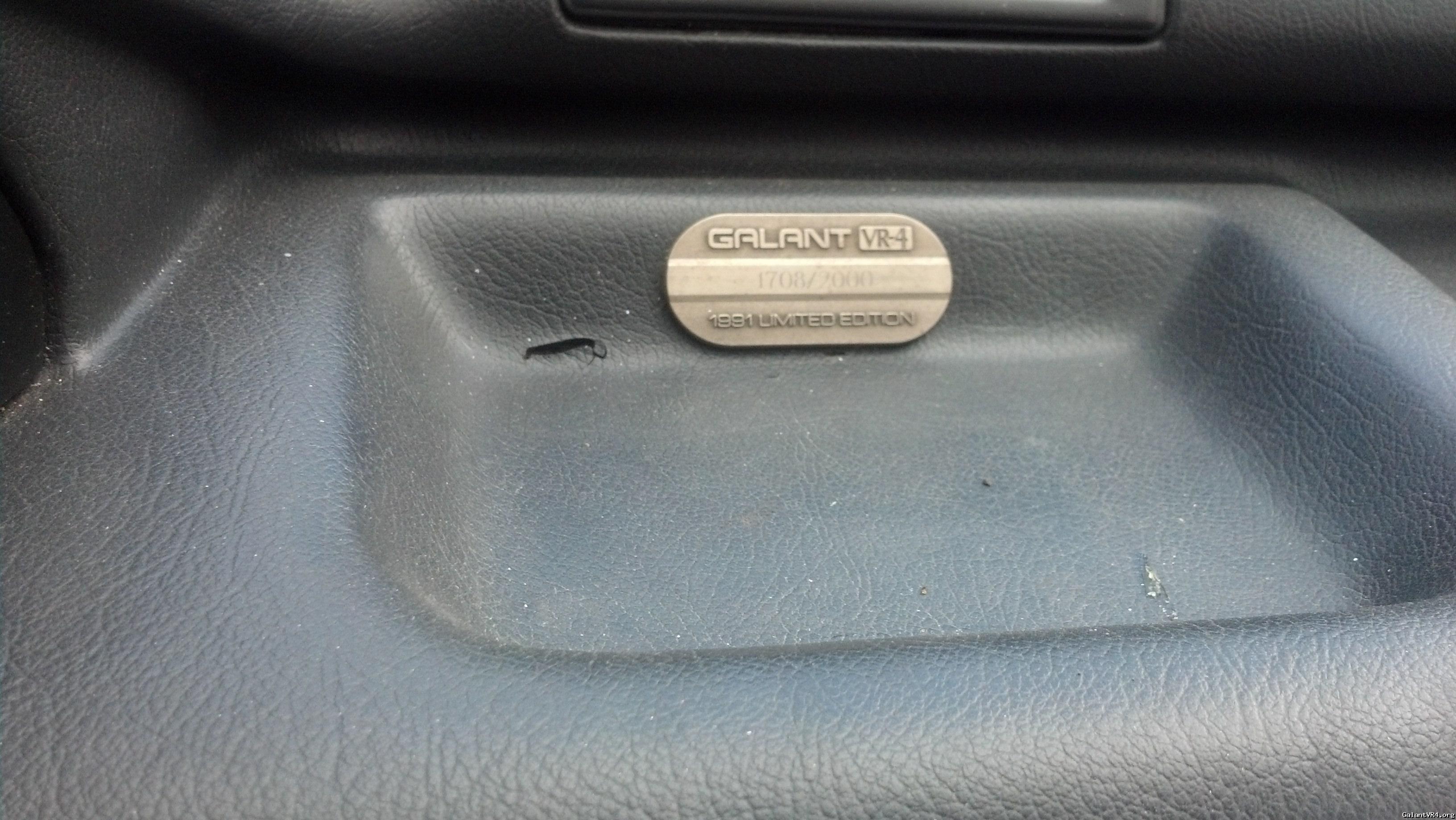

My Name is Colby. First off this is my first forum and first sports car. I bought #1708 in January of this year in Denver Colorado off of Craig's List. Below is the List of Mods and what ad said:
"1991 Galant VR4 1708/2000

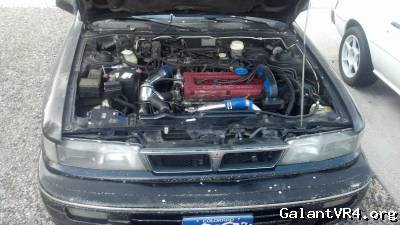

Here are Some pics of the Car:
So I made a road trip from Western Colorado over to take a look at it. I of course already had every intention of buying this car fixing it in a parking lot and driving it back. So we arrived I paid for the car as broken went to auto parts store bought a new larger battery and BAM! Car starts right up /ubbthreads/images/graemlins/smile.gif After letting it warm up me and my best friend boosted around the block a few times and then went to gas station checked oil tires and fueled up. We were kind of trying to hurry because a large winter storm was coming in.

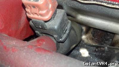

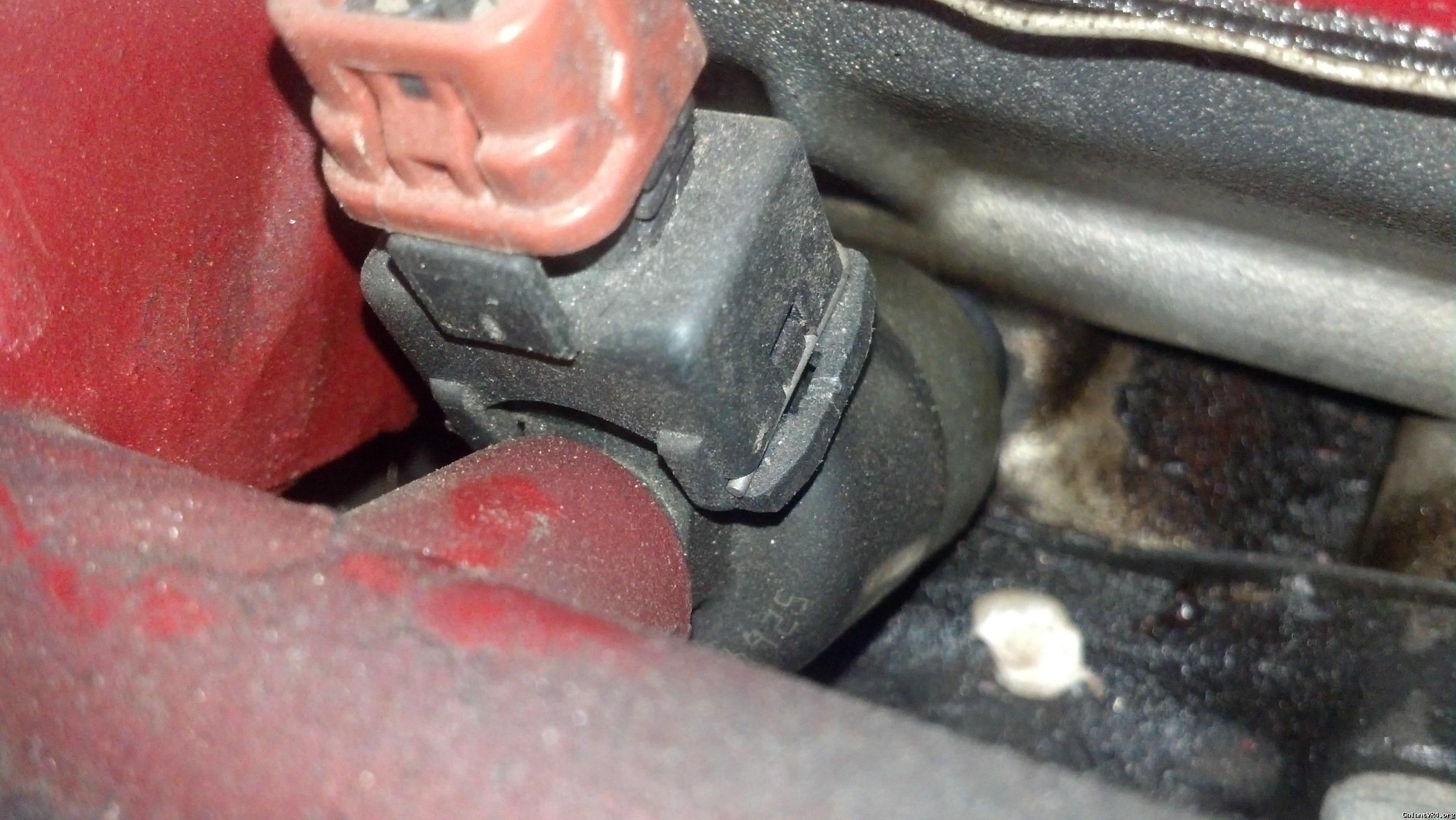

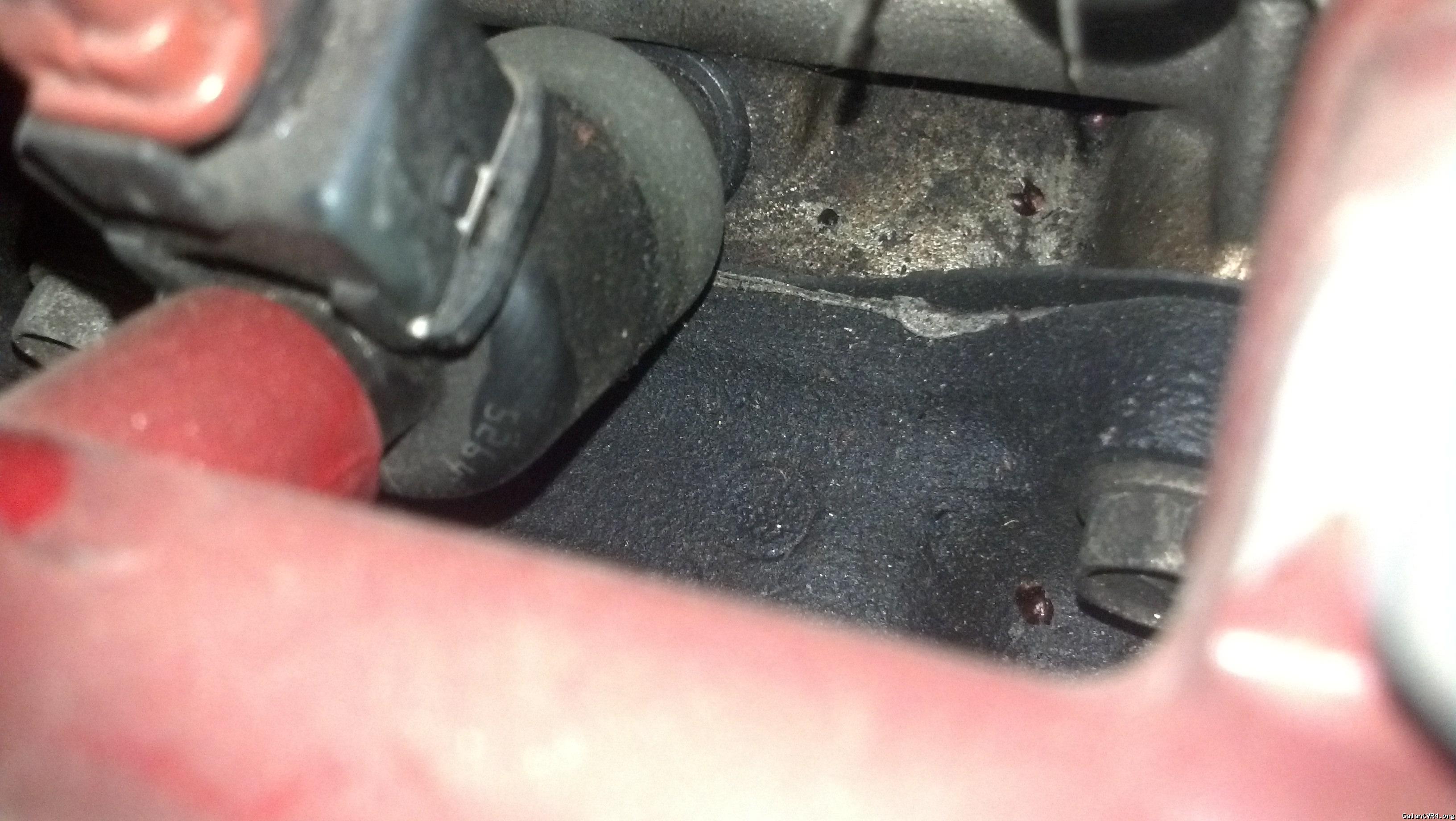

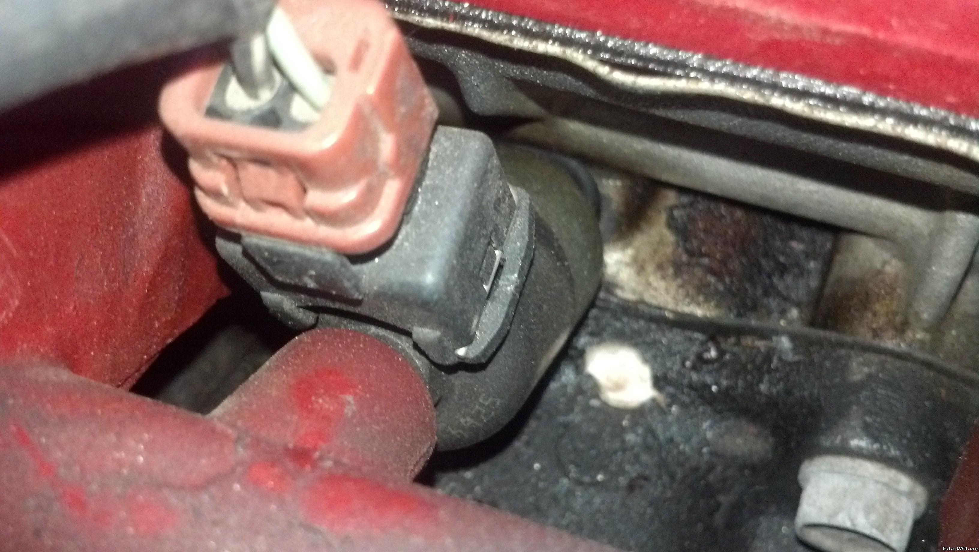

Also I am preparing to order the upgrade for DSMlink V3 and I am trying to figure out the maker of my fuel injectors(is this important)?...Pic is below
Does Anyone know what brand these are?
BluFalcon
Jan 20, 2002
1,312
Wichita, KS
They look like Delphi injectors. Dunno how to ID the flow rate other than pulling them out and see if there's information etched somewhere on the body. If there's a part number stamped on it, you might be able to cross reference the number and figure out the flow rate.

there PTE's and if there said to be 660cc there actually 680cc. i dont know the serial number on your because i cant see it. unplug one of the injectors and spin it around there is a number on the top of the injector, it will look like this, 9293 1711814 thats a PTE/Delphi 680cc injector. thats what my 680cc say on them that are in 1078. you can actually see the 5264 as the begining on yours. turn it a bit more and get the rest of the number and just type that number into the google search bar and it will bring it up. as for the leather seats, im moving to california soon and i want to get rid of the leather seats i have, for cloth ones. so take some pictures of yours and ill take pictures of mine and if we agree then when i drive out there i will stop by and trade seats with you.
May 15, 2013
23
Clifton, Colorado
Thanks Guys! I will get in there and rotate the injectors to get the rest of the serial number, When I just looked up 5264 I was getting way to much info back to cross ref the #, hopefully the non-displayed # will give it away...

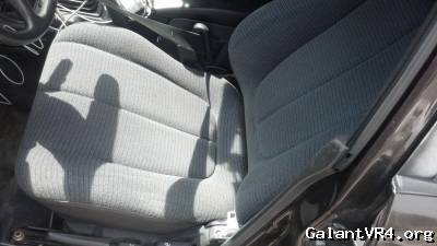

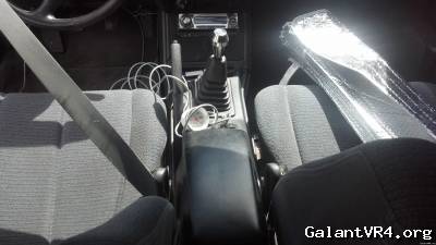

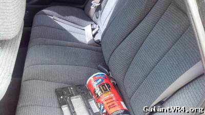

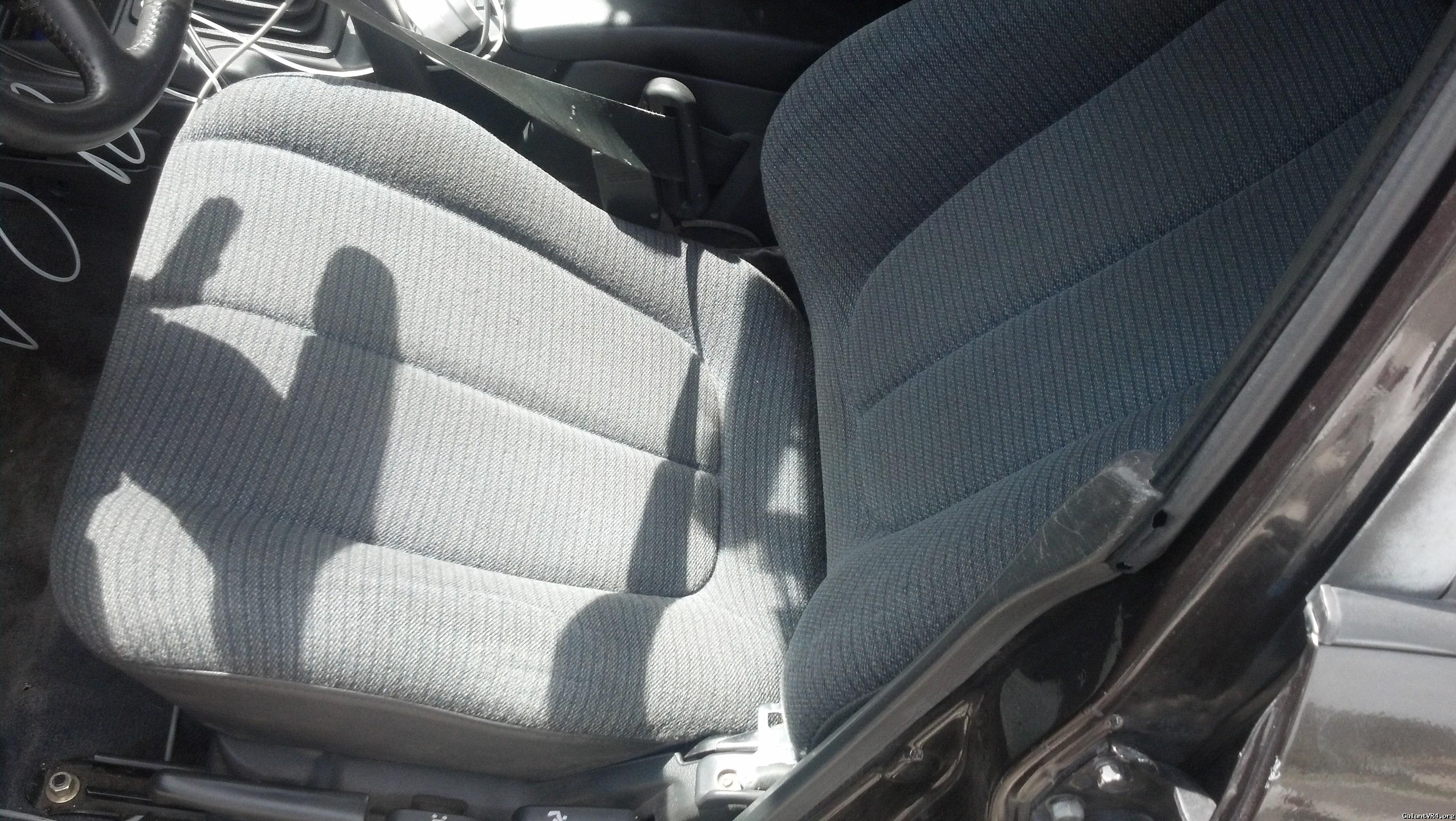

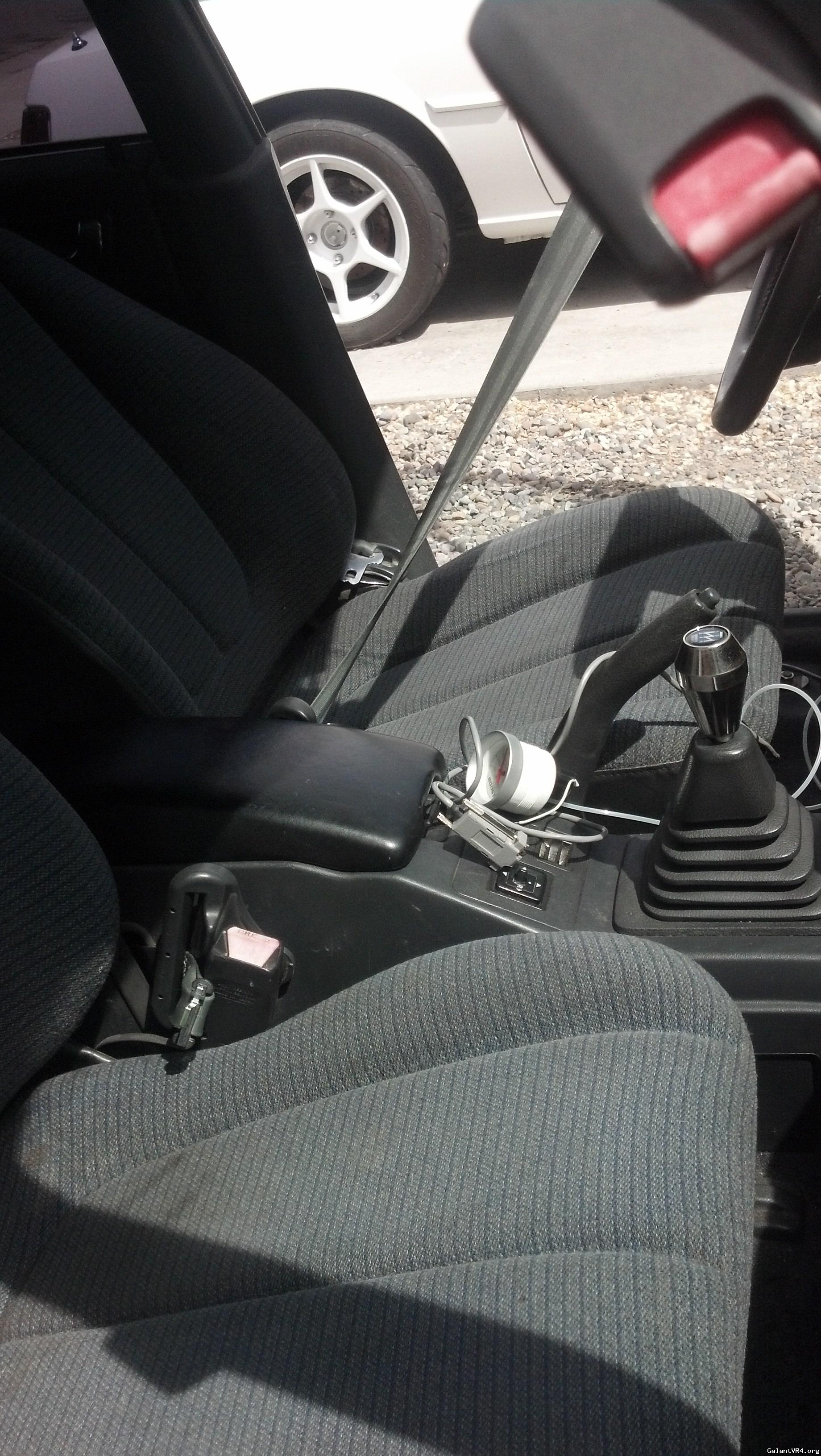

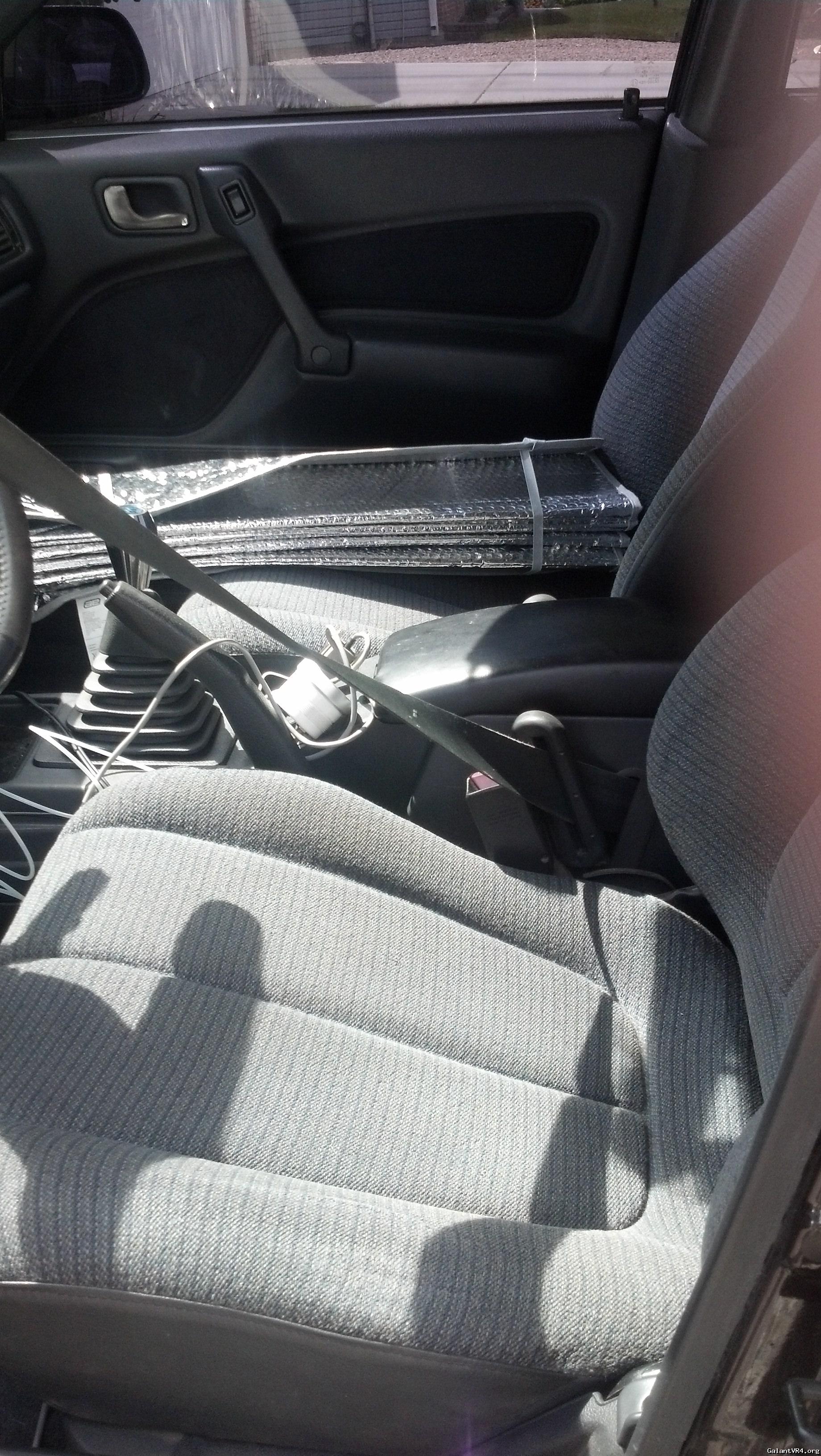

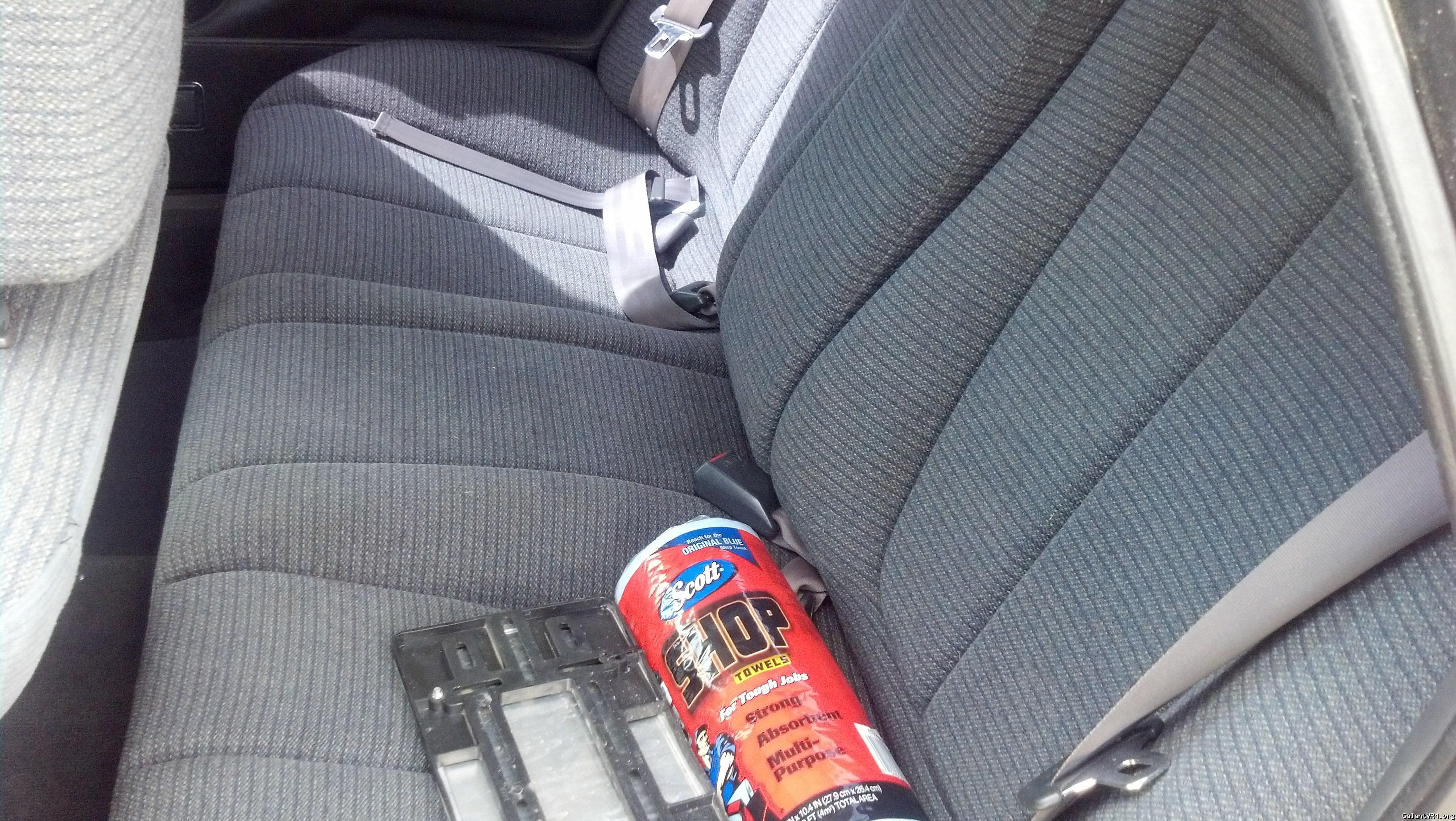

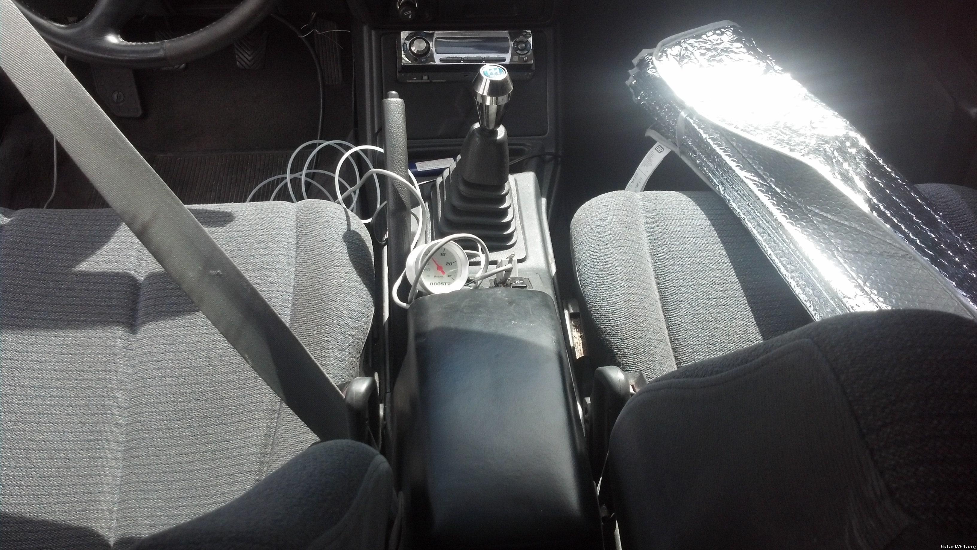

Below are some pictures of the interior:
None of the seats have any rips or tears but there are some faint stains on passenger seat.

Quoting jnava:
Interesting cloth seats. /ubbthreads/images/graemlins/smile.gif
They are the same seats as the JDM VR-4, and I believe the GGSX and/or the GGSR. Very very comfortable seats, especially the rear! I wish the leather seats were as comfortable.

Quoting fuel:
Quoting jnava:
They also came in the Eagle 2000 GTX's. /ubbthreads/images/graemlins/cool.gif
They are by far the most comfortable seats I've ever had in any car.

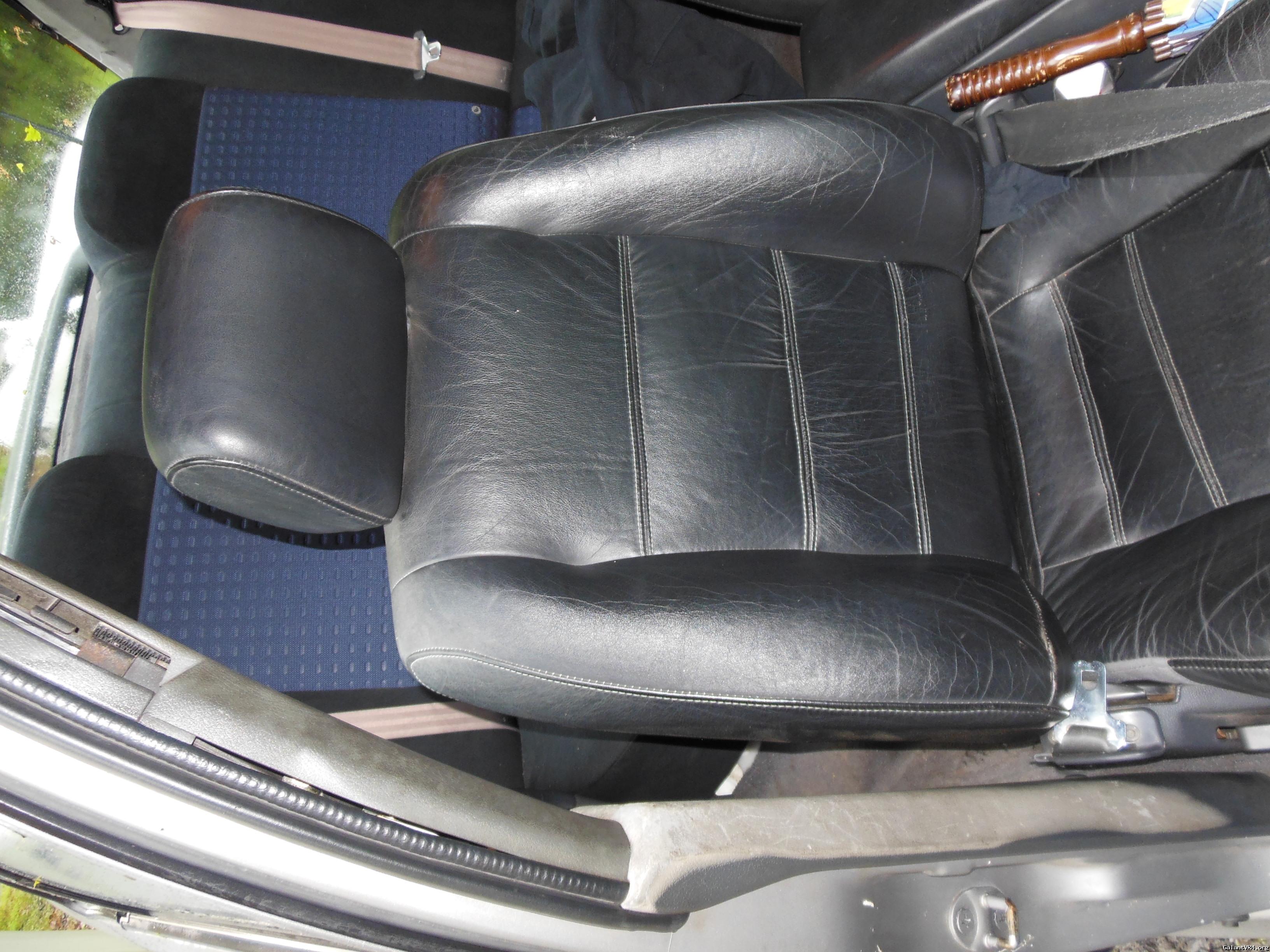

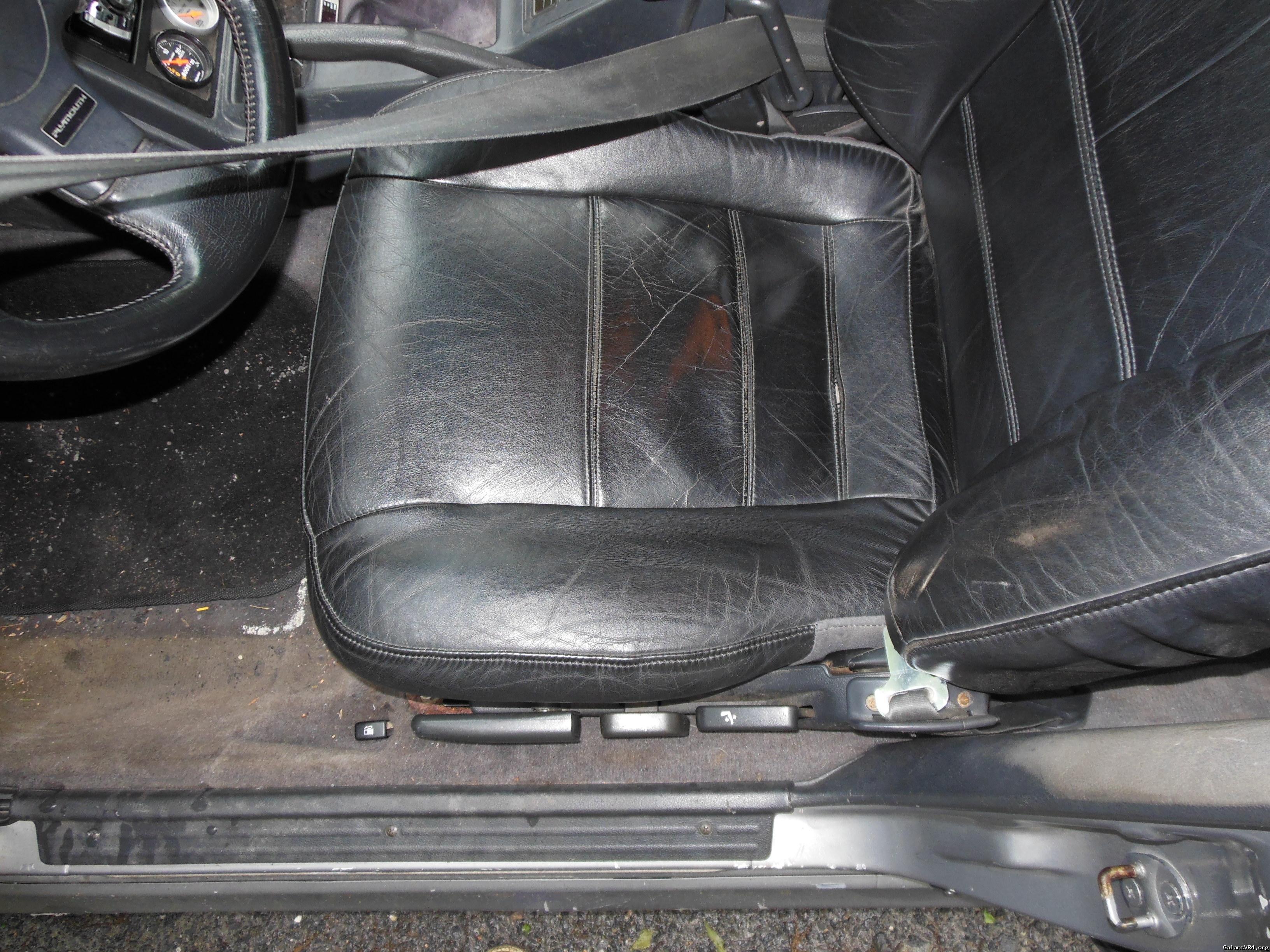

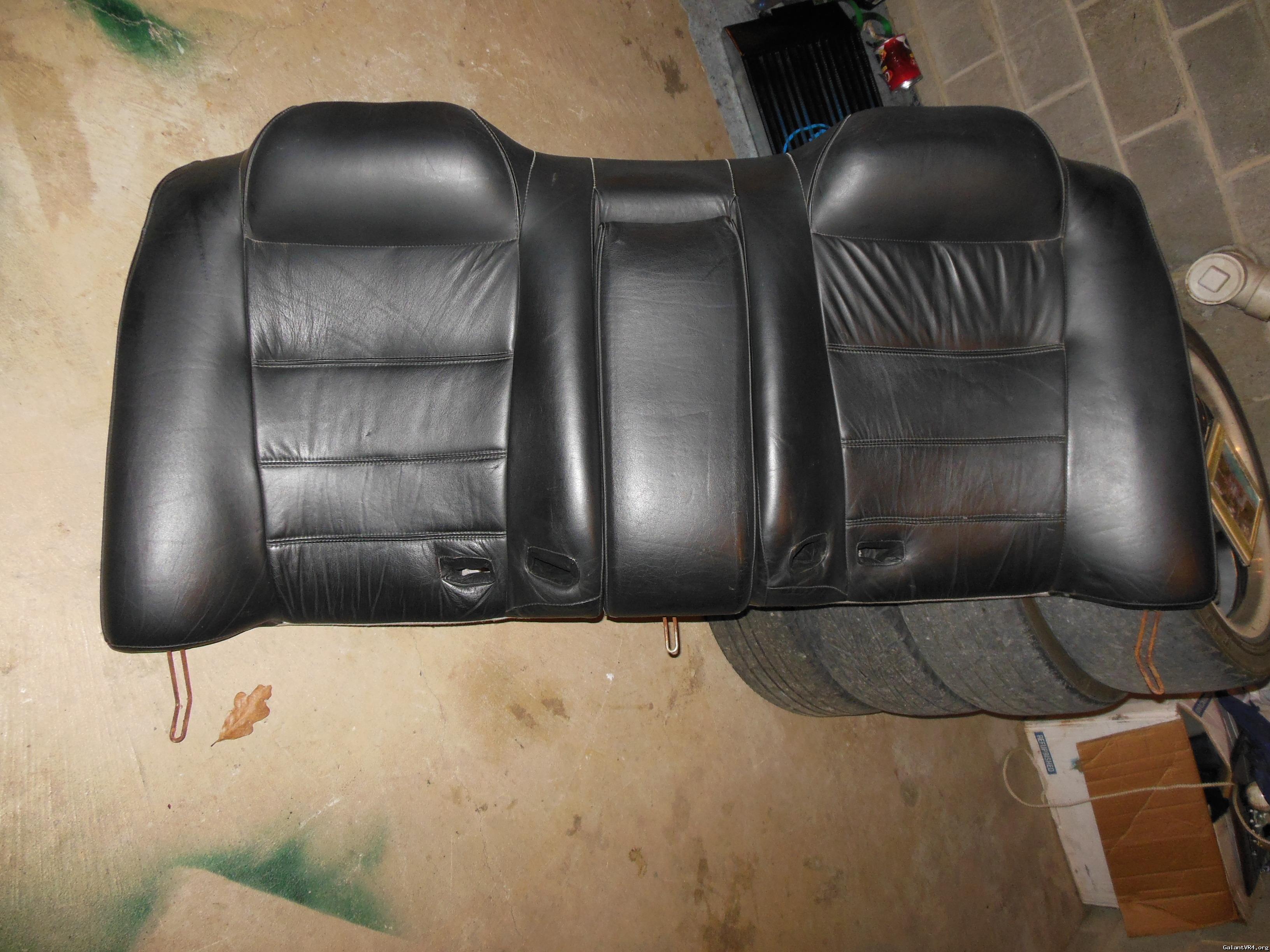

-Transparetdsm, your seats look like they are in pretty good condition, I would be down to trade if it works out. My cloth seats do have some stains just as a remainder ,... don't want you to get surprised or anything when you see them. When are you planning on moving?

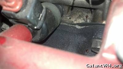

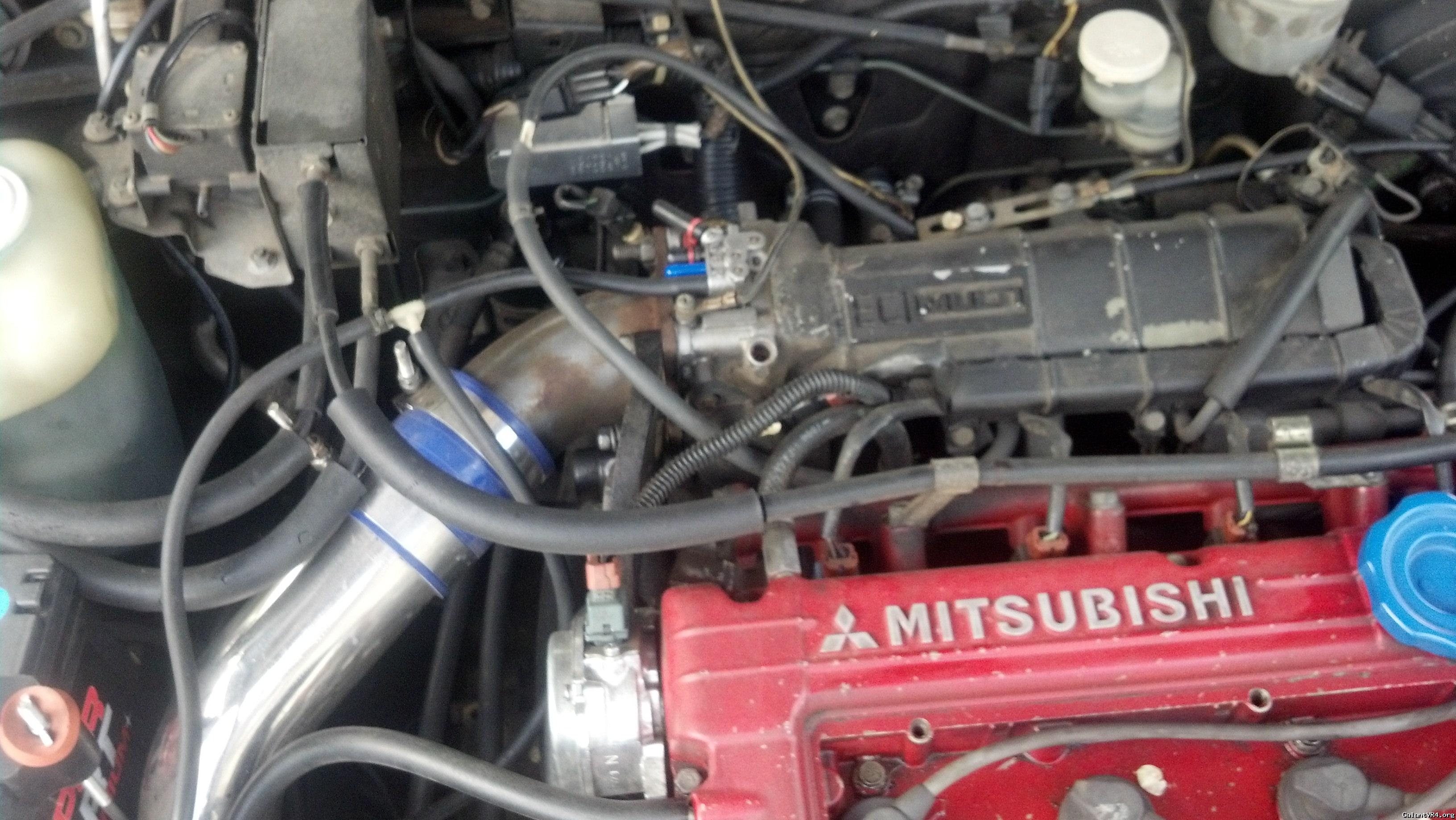

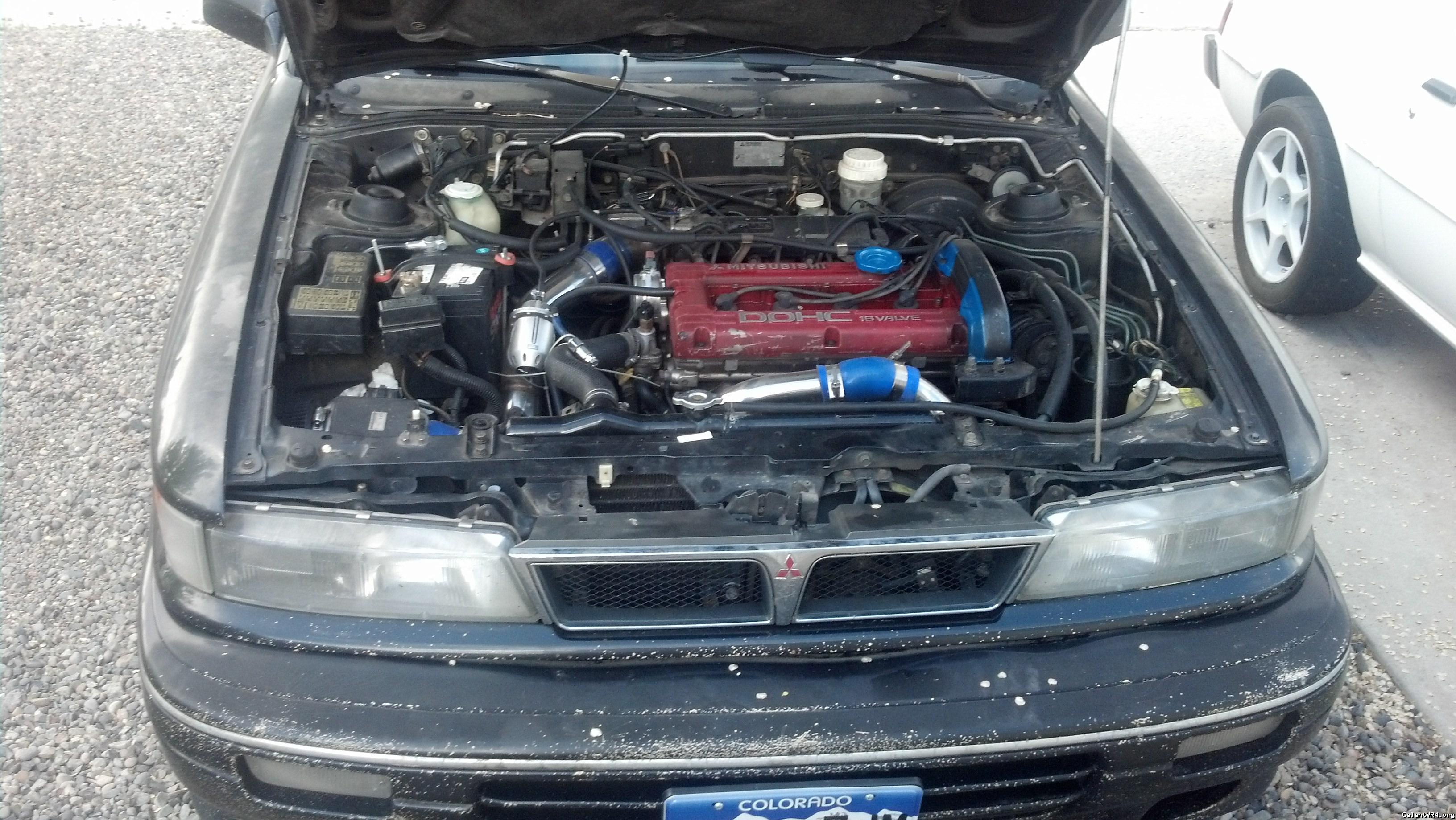

From the experienced readers, I have do have some oil residue that builds up on intercooler piping and valve cover, you can see the weird sheen on it. Would an oil catch can reduce this occurrence? what are other advantages to oil catch cans is there?

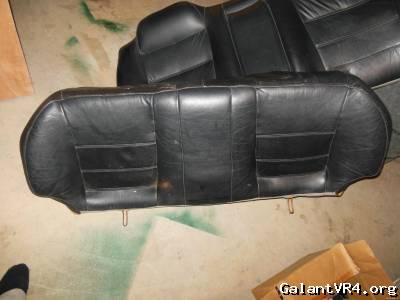

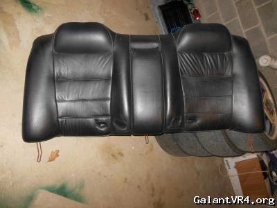

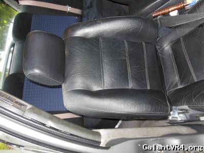

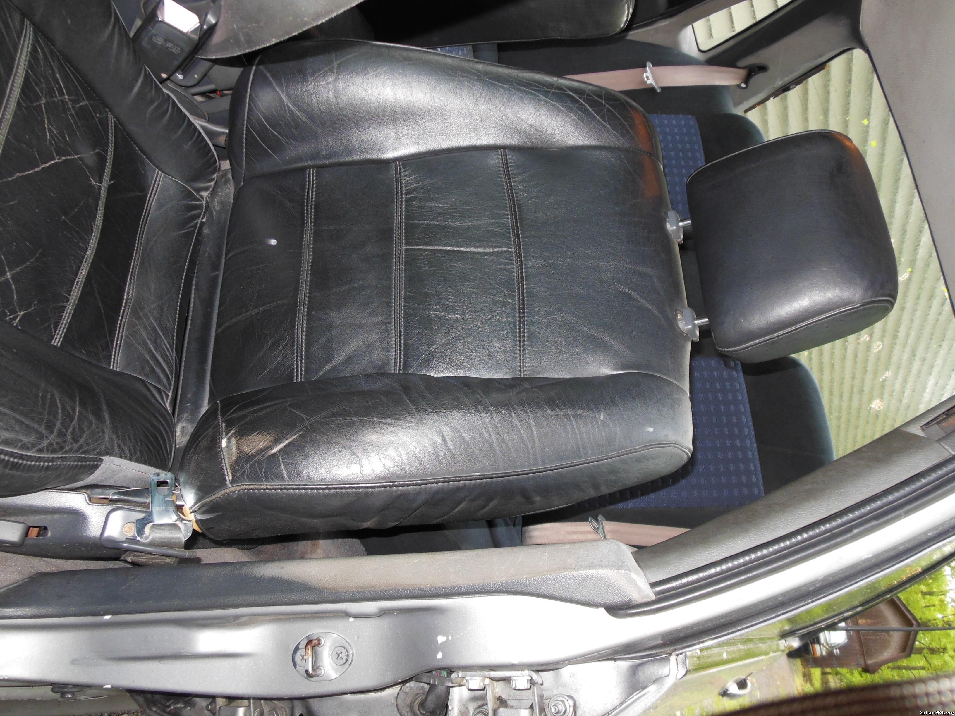

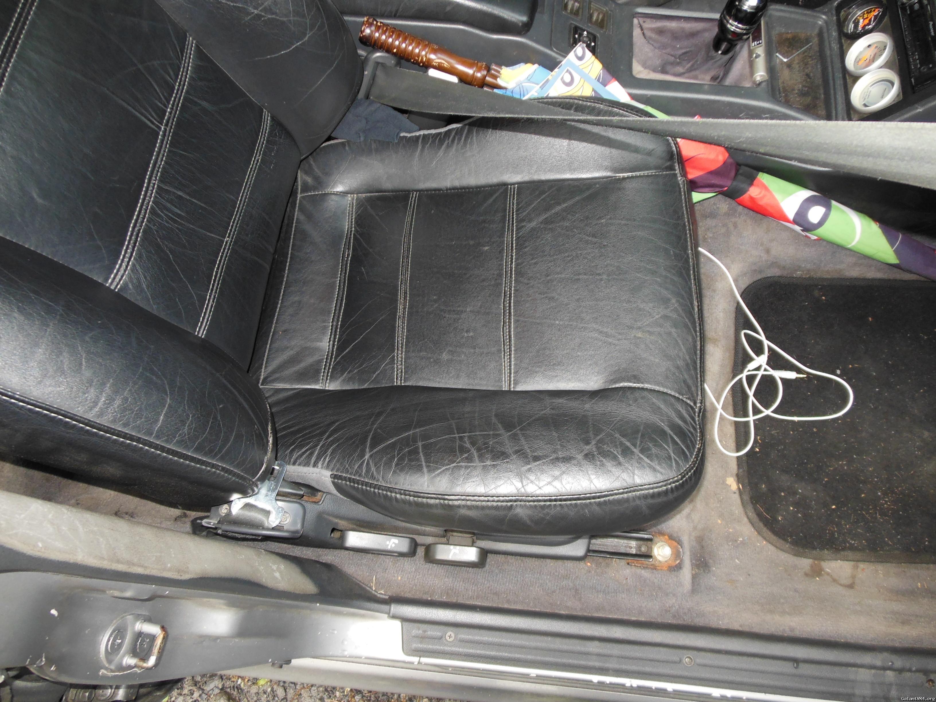

stains are ok, i will actually only be taking the fronts, i have evo 8's in the rear, but i do have the rear leathers that are in the picture and i will be bringing them with me.
Send me a PM on the bolt's i will go look today and find the bolts you need, i have them in a bin in my basement.
oil catch can allow you to run both of the vents off the valve cover into one single can, avoiding having oil sent into your intake pipe and intake manifold, like the stock routing is set up, and that stops it from blowing oil into the top of the pistons and through the compressor housing into the inside of the intercooler piping. i do not think this would help your problem.
your oil leak that is giving the valve cover and outside of the intercooler pipe the oil residue is maybe a valve cover gasket. i cant be sure because im not physically there to look at it, but that is your likely culprit.
