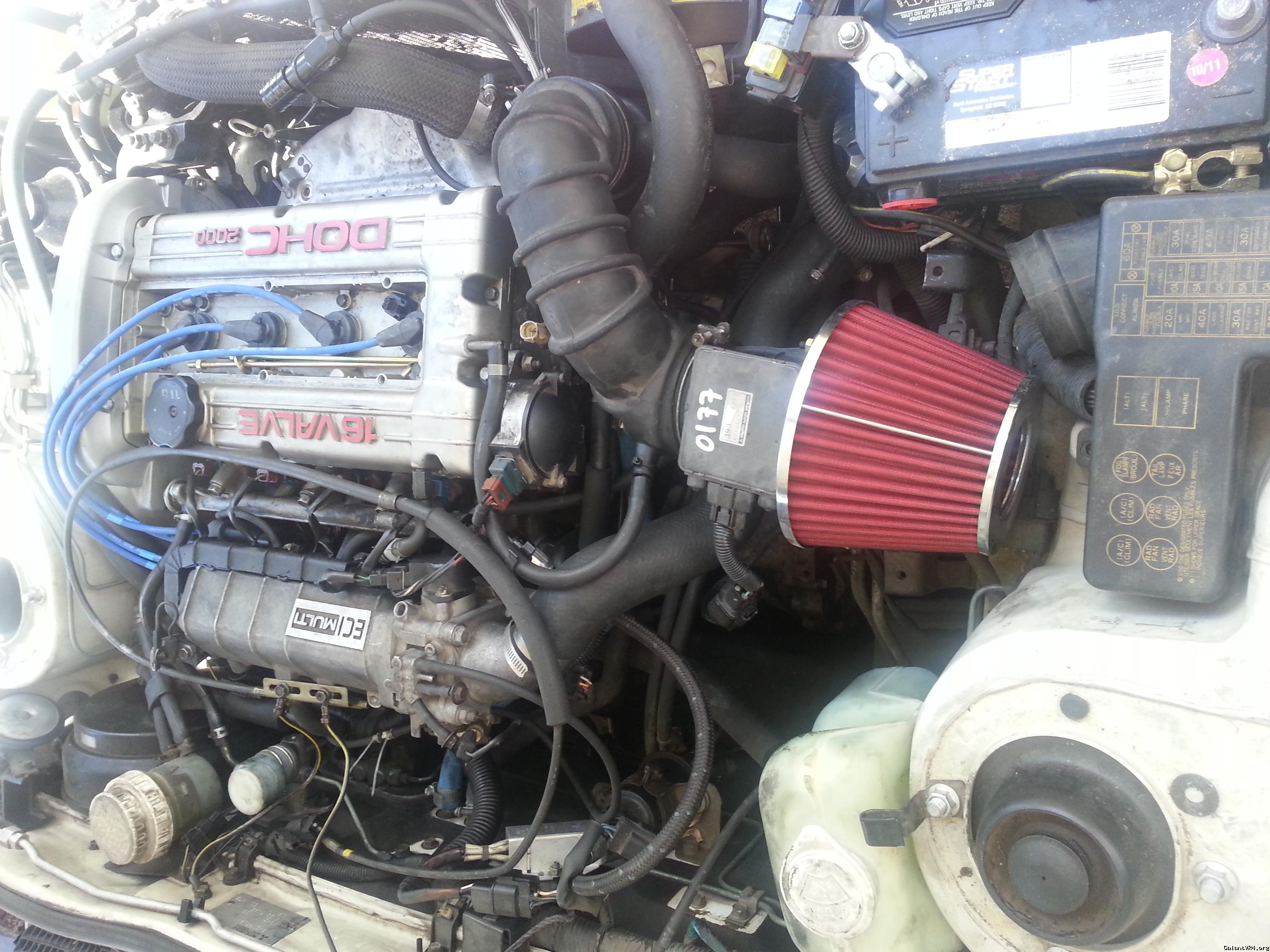

I realized I haven't posted any pix in a while, so here's one of the engine bay.
Since the last pic, I got rid of cruise, have EVO8 MAF & injectors, E16G, 2G manifold & O2 housing, 3" turboback, Forge BOV, MBC (set at 8psi so far).
