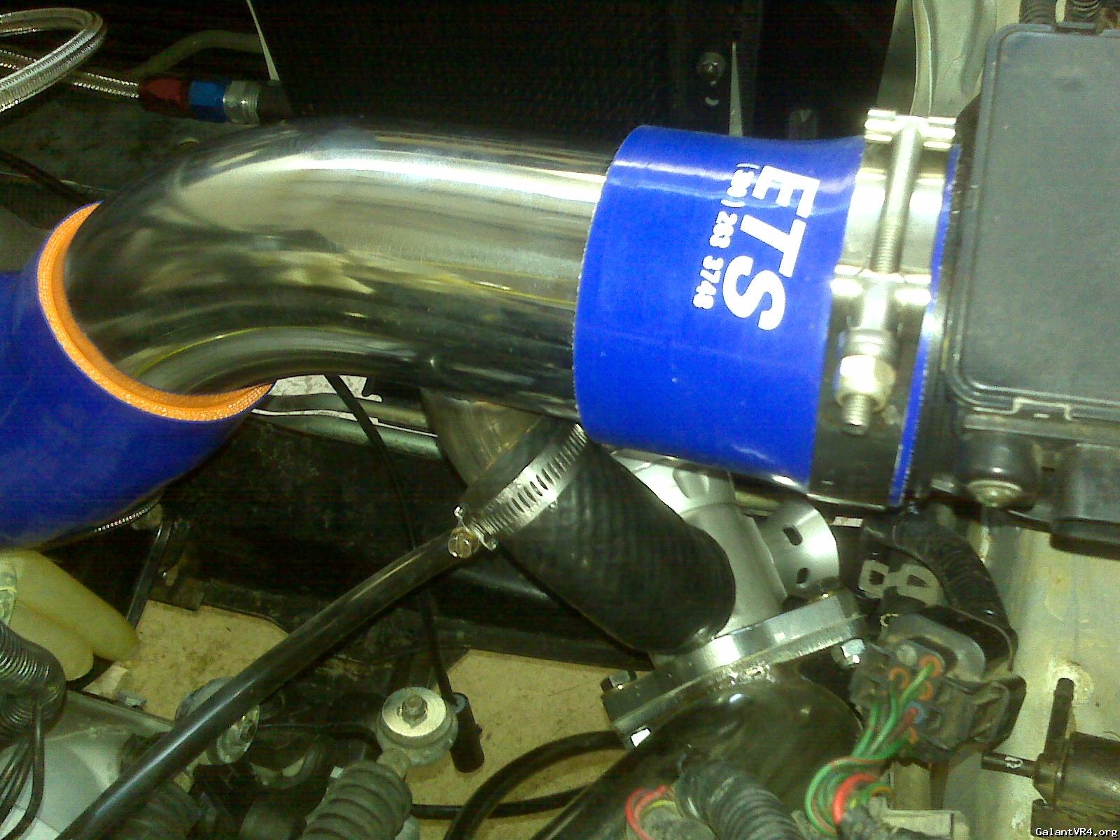

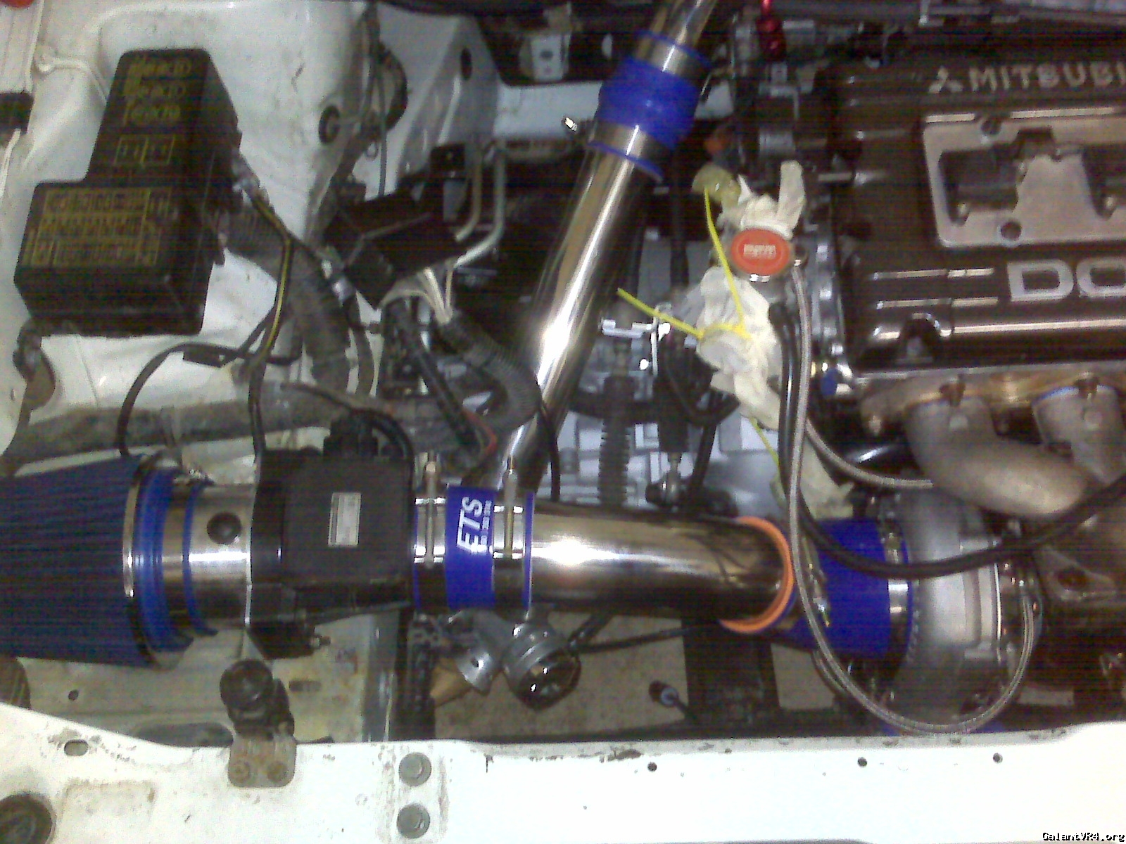

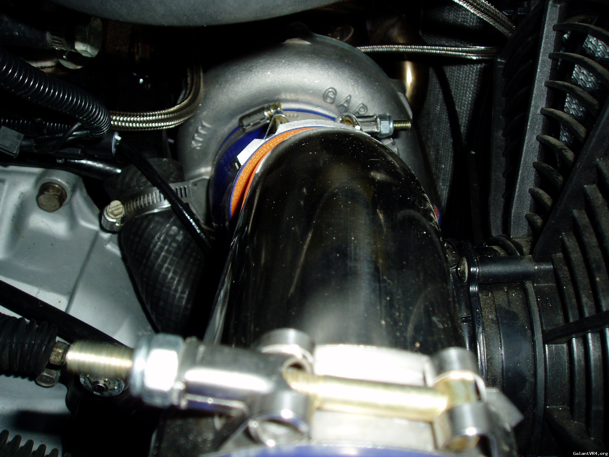

I had ETS make me a new intake since the battery got moved back to the trunk. This should help lower the intake temps since it will draw cooler air than the stock style intake. Since I'm still running a 3G mas this is a 3" pipe with recirculation fitting but there's room for a 4" pipe for those running speed density setups. The fitment was really tight but pretty damn good for a shot in the dark as they didn't have a Galant there to fabricate this. The car isn't running again yet but it's almost there. Just thought I'd share since these will be available to the public. Let me know what you guys think.

what are you using from the mas to filter? it looks pretty good. and I imagine that the rest of your setup is also ets?

jesse,
I noticed the 2 braided lines goin to the t-stat housing?
aren't those the oil lines or are you just not done hooking them up yet?

Jeff, that is just a cheap adapter plate that a local parts place carries for $26, works great! And yes, the rest of the FMIC kit is ETS's Galant kit with stainless pipes and a 3.5" thick black anodized core.
Conrad, the ss line going to the t-stat housing is for water feed to the turbo. There's another ss line coming from the water pipe. The other one hanging out in there is the oil feed to the turbo that isn't hooked up the the head yet.

Jon, you're right. There is a 3"-4" 45* reducer on the turbo, then a 45* pipe with rolled bead ends and a recirculation fitting for the BOV. It's a fairly simple setup.
I thought that was a 4-3in reducer. Have you noticed any lag from that set up? I did the same on my t66 and noticed like 3-400 RPM slower spool!
I haven't run it yet. I highly doubt there will be any spool difference on a 30R, especially since there is a 3G MAS restricting the air. It will probably spool slightly faster if I ditched the MAS and went speed density. At that point I'd use the 4" pipe.
