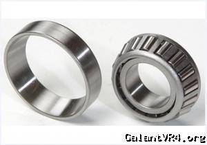

unfortunately, i dont have the old drums... they went out on trash day like a month ago, and i didnt really know till they were gone... which sucks. the bearing that i was talking about is this one--
i dont have the first ring, but i have the second one. the roller/ball bearing.
