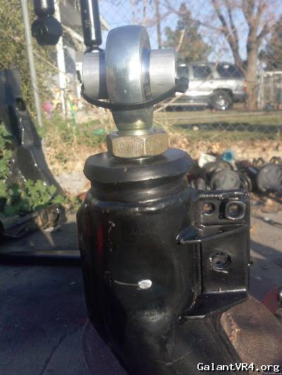

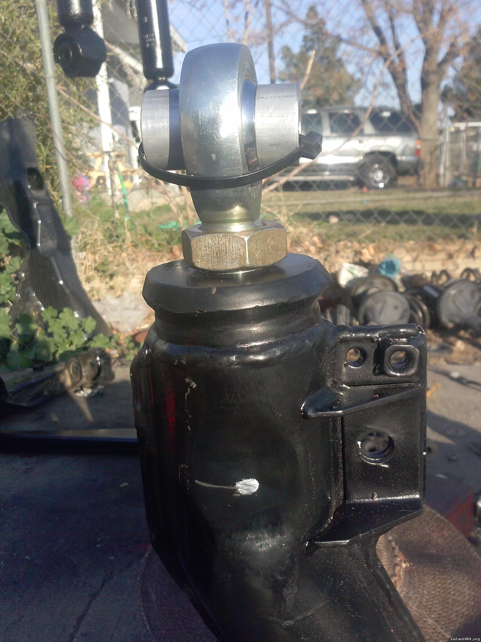

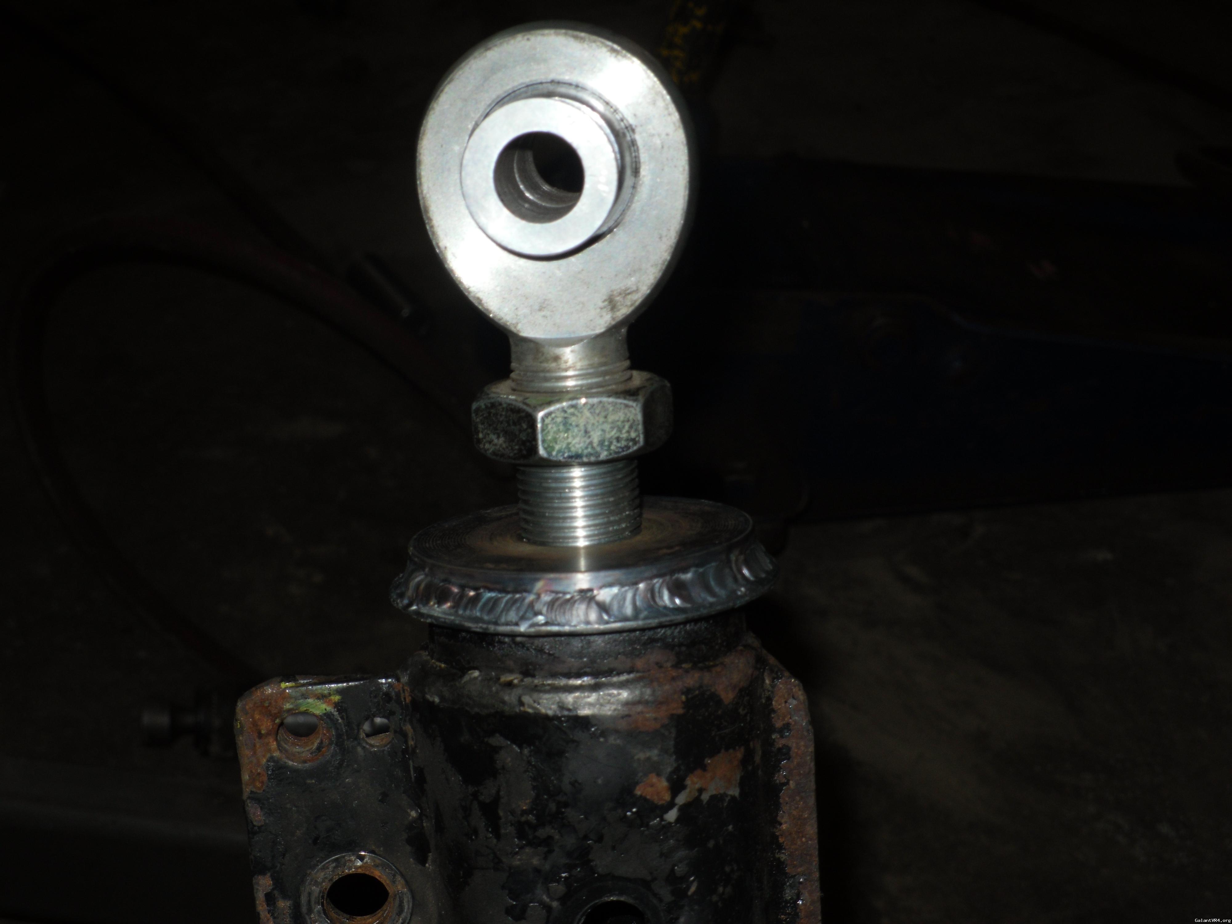

Having trouble figuring out on were to adjust it the white dot is were the hole used to be. I watched the video plenty of times but its being fast forward so kind of hard to really see the exact location click

before they removed the old rubber bushing they marked from centre of bolt hole down 4 inches and marked it on the trailing arm, then they had a datum to work with when reassembling them, using the old bolt hole as a reference is no good if you didn't find a measurement before disassembly.
if all rear trailing arms are the same or similiar you could find out what that measurement is (from centre of bushing bolt hole to the hole in the trailing arm
and set them up to that, as he said you will need an alignment anyway so you will be able to get it close enough, hope that helps.

I installed mine and I screwed the heim all the way in and then back out 10 full turns. I was able to set the rear toe with no problem. If someone brings me a car like this I charge $90 an hour. Most track car alignments are between $300-$400. That includes setting the ride height and corner weights and then setting the alignment. We have to charge for hour time or we can't stay in business. I can't spend 3 hrs on a car and charge $65. I also know what I am doing so I can do it with minimal amount of time to get it right.

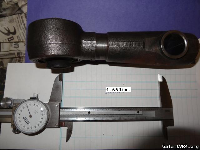

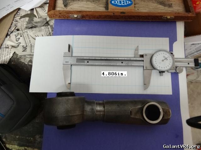

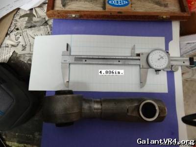

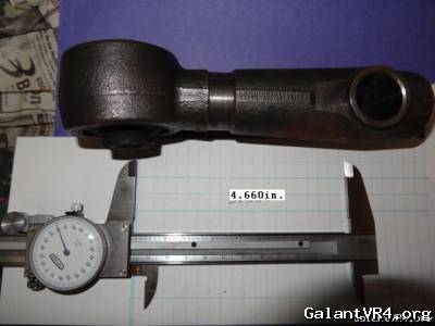

467
Mar 16, 2001
923
Royal Oaks, Ca 45 min S of San Jose
Here are some measurements that might help. There are two because the bushing hole is angled. Average to get centerline. The caliper doesn't look aligned with the holes due to parallax of the camera lens, but I took a lot of care to get close measurements. Hopefully it will get you back in the ballpark.
