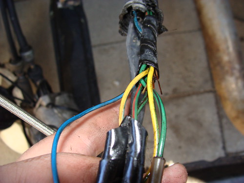

As the title says im in some need of help. I have a group of wires that i need help identifying i don't have ac any more and would like to eliminate those wires so my question is which wires do i need to keep and which ones do i need to get rid of.

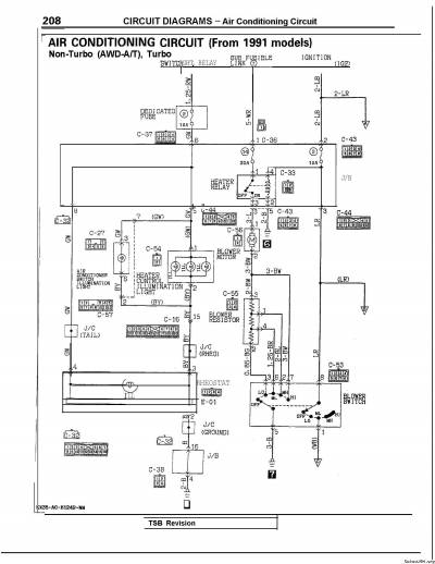

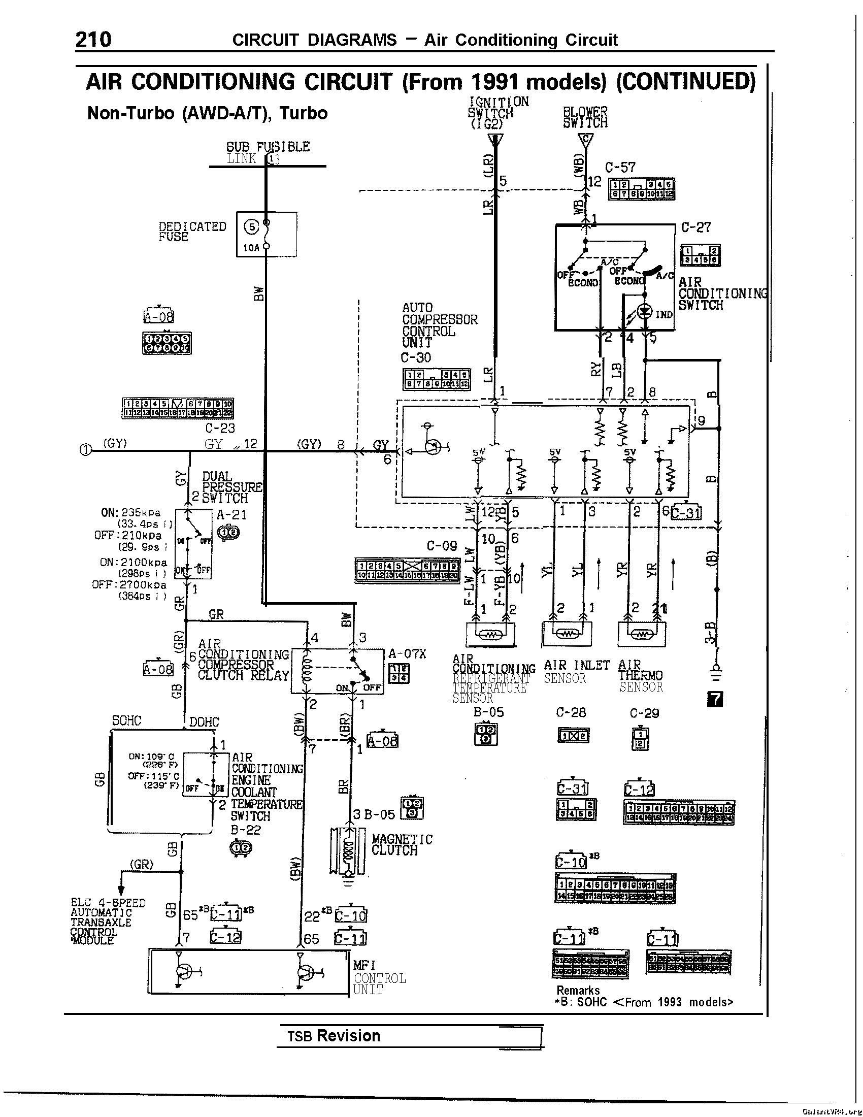

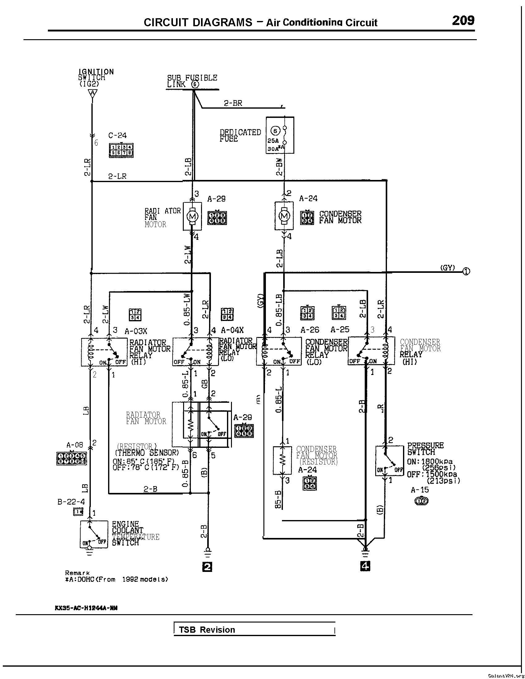

Heres the AC wiring diagrams for it. Just went through and did the samething myself, but dont recall what was what.
Struc
Nov 24, 2008
764
Oconomowoc, WI
Blue/Black, single wire sensor, A/C Condenser Fan, Normally open
Green/Red and Green/Black, 2 wire sensor, A/C Clutch lockout, Normally closed
Green/Black and Yellow/Green, 2 wire sensor, ECU Temperature sensor, variable ohm reading
Yellow/Green, single wire sensor, Cluster temp gauge, variable ohm reading.
