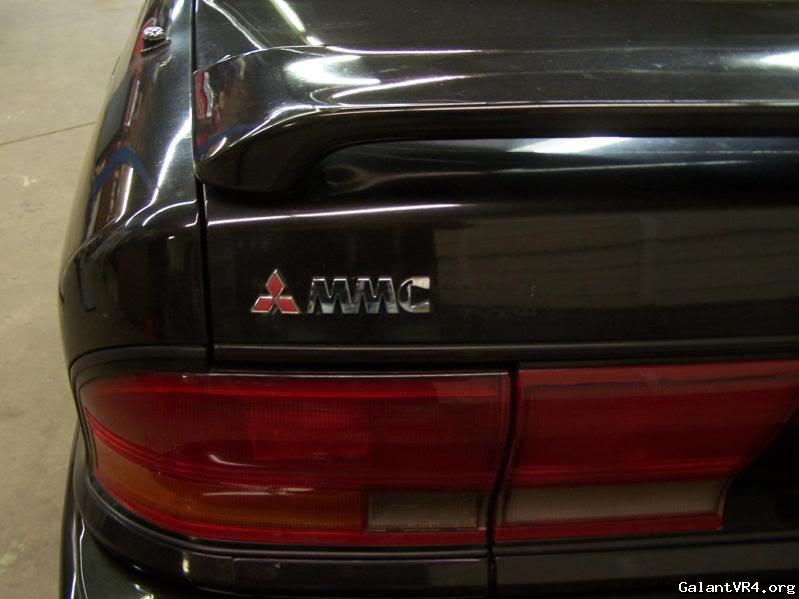

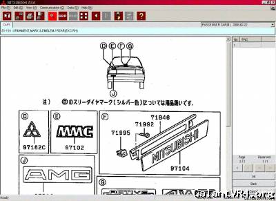

I'm getting my car repainted and need to find the part number for the 3 Diamond Mitsu logo badge that goes along with the JDM MMC badge.I know you can get the right one from Options Auto Salon, but I can order it cheaper directly from the dealer with a shop discount. I did some poking around CAPS and found one from a Diamante (PN: MR155945) but have no idea if this is even close to the right size. Options is listing the 3 Diamond badge dimensions as: 1 1/4 W - 1 1/8 H. If anyone could help, it'd be appreciated. Thanks.
I don't know if it is 100% the correct one but I used the diamond emblem from a 7g Galant with my MMC badge and it looks exactly like the one in the picture. It was the perfect size.

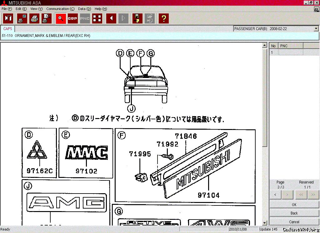

D) MARK, THREE-DIA
RED W/ADHESIVE
MB619214
SILVER (Option Code X92)
MZ554521
Silver is found on some JDM VR4s produced between 1989.03.1 - 1989.09.3 and some E35A Galant Viento (1.8L FWD) produced between 1990.05.3 - 1990.07.3 and 1990.08.3 - 1992.03.3.
E) MARK, MMC
CHROME/COOL ARGMET (I sh*t you not!)
MB594684
