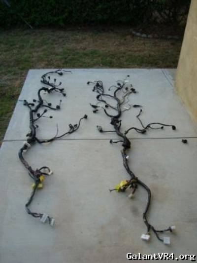

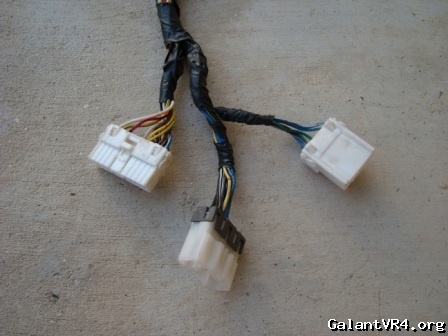

I pulled the G-GSX ECU harness and layed it out next to my 91 GVR4 harness.
I was looking over both harnesses to see if I could rape some connectors from the G-GSX harness to the GVR4 harness, just because some of the turbo harness connectors are damaged.

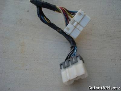

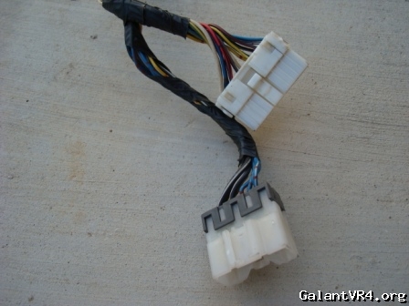

Anyway I notice an extra connector on the GVR4 harness that is not on the G-GSX harness.
G-GSX
GVR4
Anybody know what the hell that extra connector is for? (Im pretty sure the Big one is for the Gauge cluster)
Do I even need it to make my conversion work properly

its probably an interior/dash harness. could be cruise control maybe some other factory option the gsx did not have, abs maybe??
Ya ABS, my G-GSX does not have ABS.
I did not even think about that /ubbthreads/images/graemlins/banghead.gif

you will find a few things...
alarm, ABS, boost gauge, tail light wiring may be different and then of course underhood connections.
