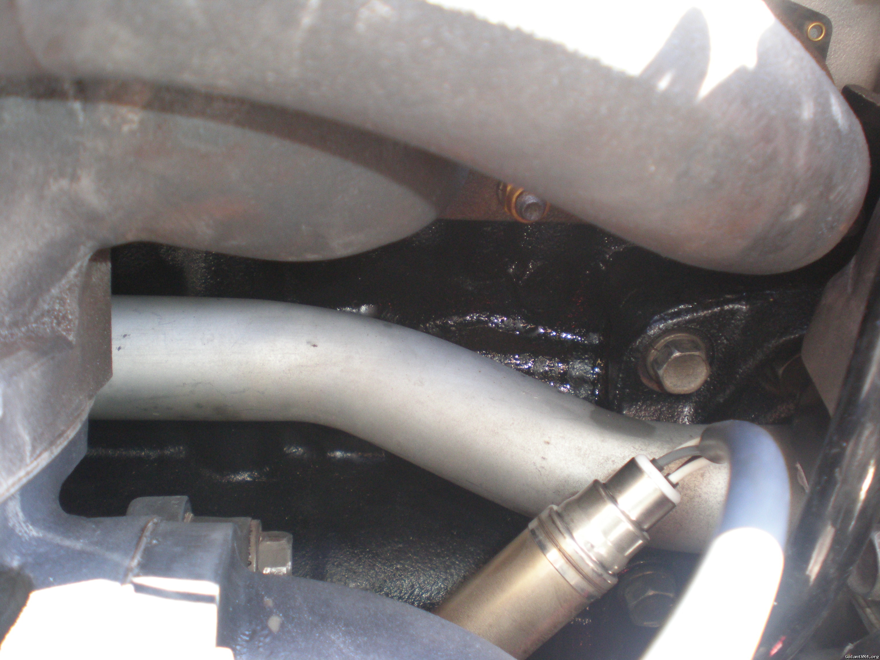

Mystery oil leak....any one?
So here's the info on it....new rebuilt engine, fresh MLS head gasket, block decked, head perfect. oil seems to be coming from under the exhaust manifold on the right side. Thought it might be coming from the head gasket or one of the head studs??? Car runs perfect...no smoke, nor does it overheat. Pushing 23psi of boost with no problems.

IIRC one or more of the EM studs goes into or near an oil galley.
You may need to R&R with some thread sealant if someone can confirm this...

Had that happen once when oil was getting past the piston rings. Considering it's a freshly rebuilt engine I doubt that this is the case, but it is a possibility. Maybe the rings aren't seating right?
I believe KTM is right, the center stud on the lower plain goe straight through to an oil galley... If the aluminium starts to stip out of the head you may have trouble. Happened to me, but I was lucky. Ran a tap into the head a few times to clean it up and Hi-temp permanent Loctyte'ed it w/ new SSStuds.com. the center stud was leacking, but the trail of oil was coming off the exhaust gasket near the power steering pump.

Buschur Racing did the head and if I remember they put that tread sealant on all the studs. But i had the head cleaned recently...the hot tank could have removed the sealant?? When the engine cools down if I put my hand up under the exhaust mani I do feel oil on the back side of the exhaust gasket towards the middle. I think the stud in the middle is leaking like you guys said. It is hard to believe that all that oil would be coming from the head gasket. I will take the mani off and have a look.
IMO... Definatly run a tap through (8m x 1.25) but you need the head off to the alu. shavings don't go on a fantastic voyage through the oil return system. Also remember there are like 30 different types of Loctyte

besides Alu (head), carbon steel (manifold), and SS (studs) all have completely different expantion rates... So the the stud might just not be threaded in as far as it needs to be. An oil @ start-up or is there more when the car is warm???

The oil seem to only come out when I drive it hard, after it's warm. I can't physically see it drip out when the car is sitting at idle.
i hope that maybe when you installed the manifold, the stud pulled out a few threads... could be that simple. OR NOT
B/C if you dont have that stud in at all... it pukes like half a quart in

forgot to mention b/4 I put some Liquid Metal stuff, made for alu, that expands @ the same rate, in the backside of the stud (in the oil gally)... but i also had the head off the car
Holly crap dude that stuff is expensive!! I think I'm gonna just take the mani off and take the stud out put some thread sealant in it and see what happens. I still need to confirm that its coming from the stud.
Pretty sure I fixed it. Took it to the track tonight and ran a 12.3 1/4 mile /ubbthreads/images/graemlins/smile.gif
It was either the bottom middle exhaust stud or it was leaking through the head gasket...I pulled the manifold off pulled the stud out put thread sealant on it. I also pulled the valve cover off and got the front middle head stud tighter.
