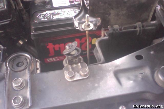

Im wondering what this button is that is located under the hood in front of the battery.
It has rubber covering a white button.
I've read a thread on here that it disables the alarm but I didn't even know these had alarms.
Don't want to press it until I know exactly what it is. /ubbthreads/images/graemlins/dunno.gif
11,982
It's a pin switch for the alarm in case somebody opens the hood while the car is locked.

pop the hood latch, but don't lift it fully. take your key out and lock the doors and close them. Then go and lift the hood up all the way. To my car, this makes the horn by the brake booster go off. No lights flash or anything though.

The headlights will flash. At least, that's all my car ever did.
Ditto here. I took the switch out and never looked back. The alarm is high tech though, well at least in 1991. /ubbthreads/images/graemlins/rofl.gif

You can also lock the car with the windows down and then reach in under the dash and pop the hood release.
I've made my alarm go off several times when accidentally locking it while closing the doors with the windows down. At that point if you reach in and pull up on the lock, the alarm will go off. Gotta unlock it with the key if that happens, lol.

Just looked at mine again and found the button was unplugged. I hooked it up and still no alarm. Would the small relay behind the horn on the firewall have anything to do with it? Mines not plugged in. I'm guessing mines been disabled for a reason.
Edit: the relay I mentioned is the alarm horn relay. The alarm light relay is over by the battery. Thanks alldata.

You have to geve the alarm a min or two on mine. If you lock up and open anything right away it wont go off. i tested all four doors and the bonnet which sets off the alarm. Not sure of the trunk. Both the lights and the horn should go off.

Replace the door lock switches on the inner part of the front doors. As well as pull all four door switches and clean them up. These all get worn over 20+years and confuse the alarm ecu and will cause weird issues.
