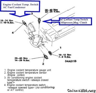

Where this coolant temp sensor located. I will replace it & see. Photo is more accurate...
It is the 2 wire sensor at the top of the T-stat housing.
Before you go and throw a CTS at it you should inspect the wiring. Or if you know anyone with an actual scan tool have them look at what the ECU is seeing for coolant temp.
the top sensor on the tstat is for the AC the temp sensors are the ones on the back side.. I forgot if it was the top or bottom one.

Quoting chris:
#2 sensor, lower left when looking from the front.

Thanks'
That is helping me. I don't know any body have scan tool. I have palm my self. But I don't know how to check the reading of the coolant sensor. I will replace it if it's cheap. By the way the palm is keep throwing code 25 (Barometer). I keep replacing the MAS. I have two of 1G mas. But the code goes away when I tried the 3G Mas. Does this code come from swaping the 2 wires at the ECU pin#6 & 14?
