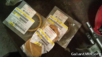

The syncros for this basket case are already in the mail. Tracking says Monday.

Thanks I'll keep that in mind. I'm hoping the clutch didn't take any damage. I think my spare W5M33 will be good to go with a new set of brass.

My syncros are supposed to arrive from mitsubishipartswarehouse today, and my new DSM steering rack came from rockauto last Friday (my rack started gushing last week too). I guess it's time to start doing stuff.

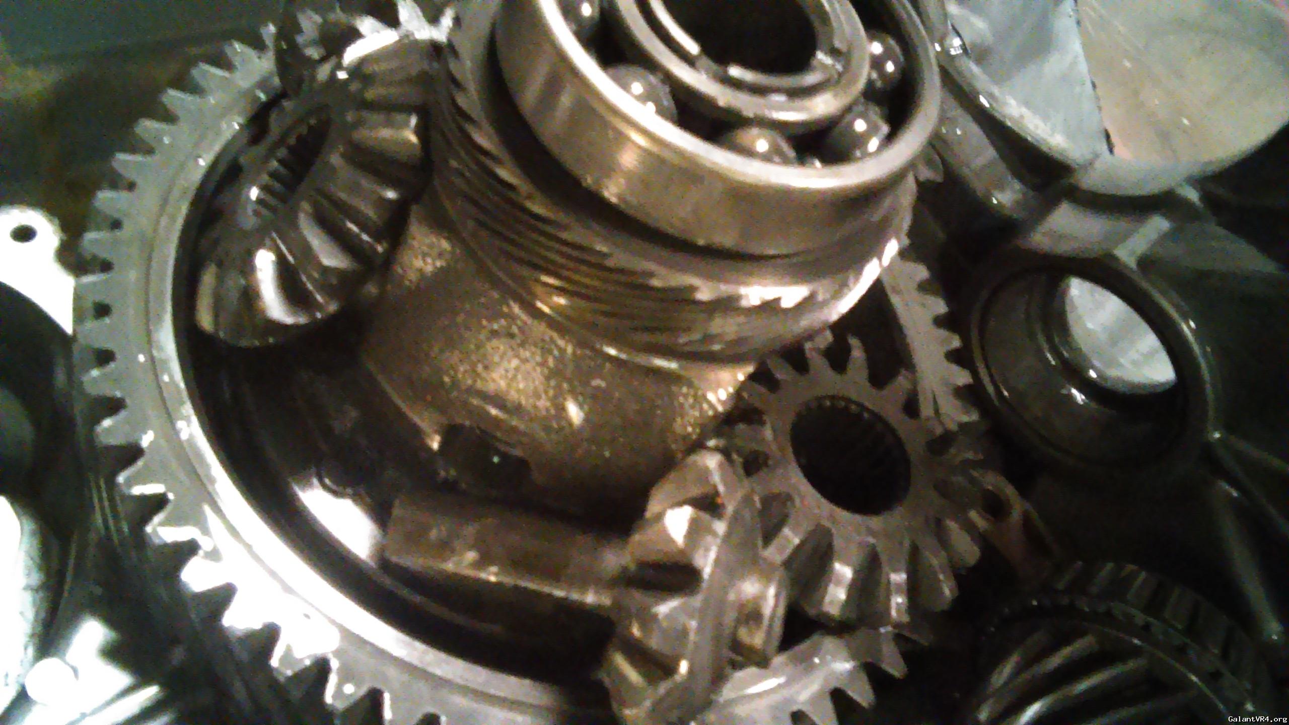

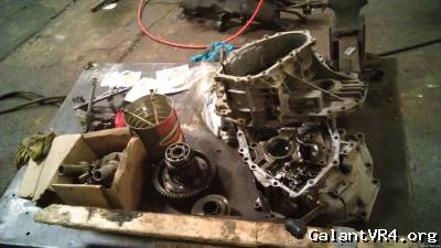

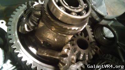

EDIT: pulled the gearbox; looks like it was the front Diff.

--- Oh, and that picture. Carnage.

Usually the parts from the center diff fall down into the front diff but that big spider gear laying there say your correct. I've never seen one do that before and I've broken a lot of transmissions in my day. I think over 20. Lol. I would like to see the inside all disassembled.

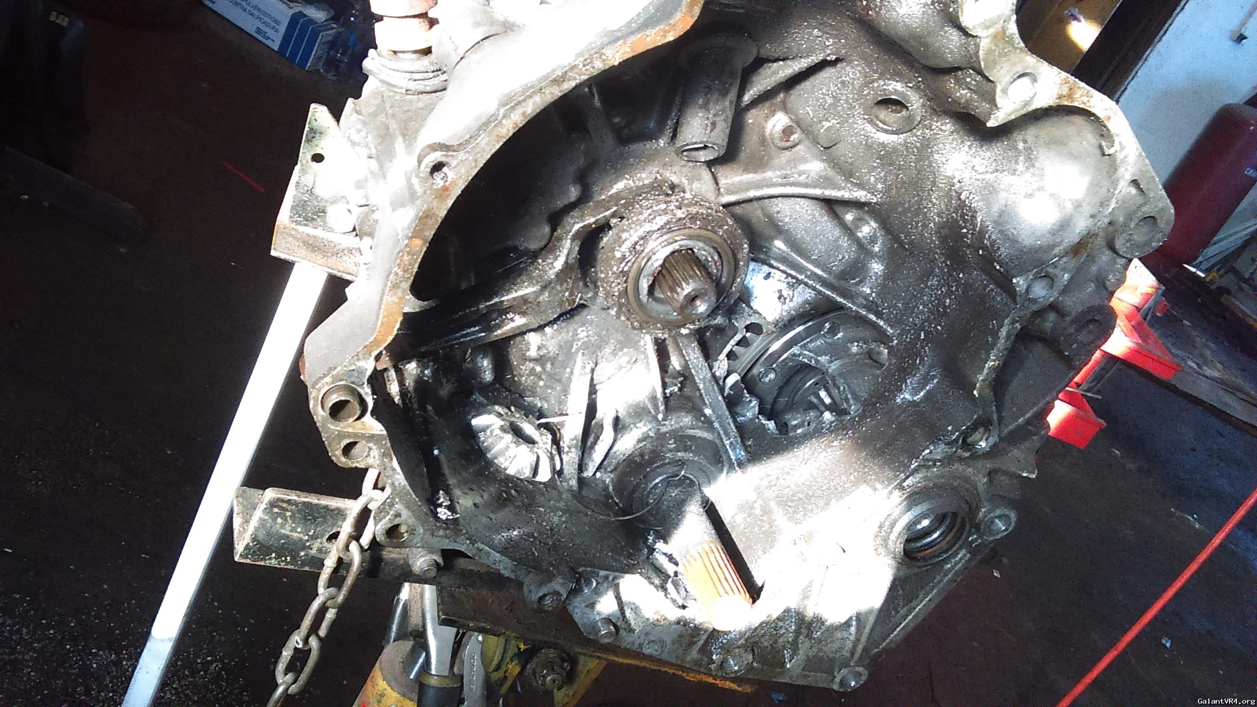

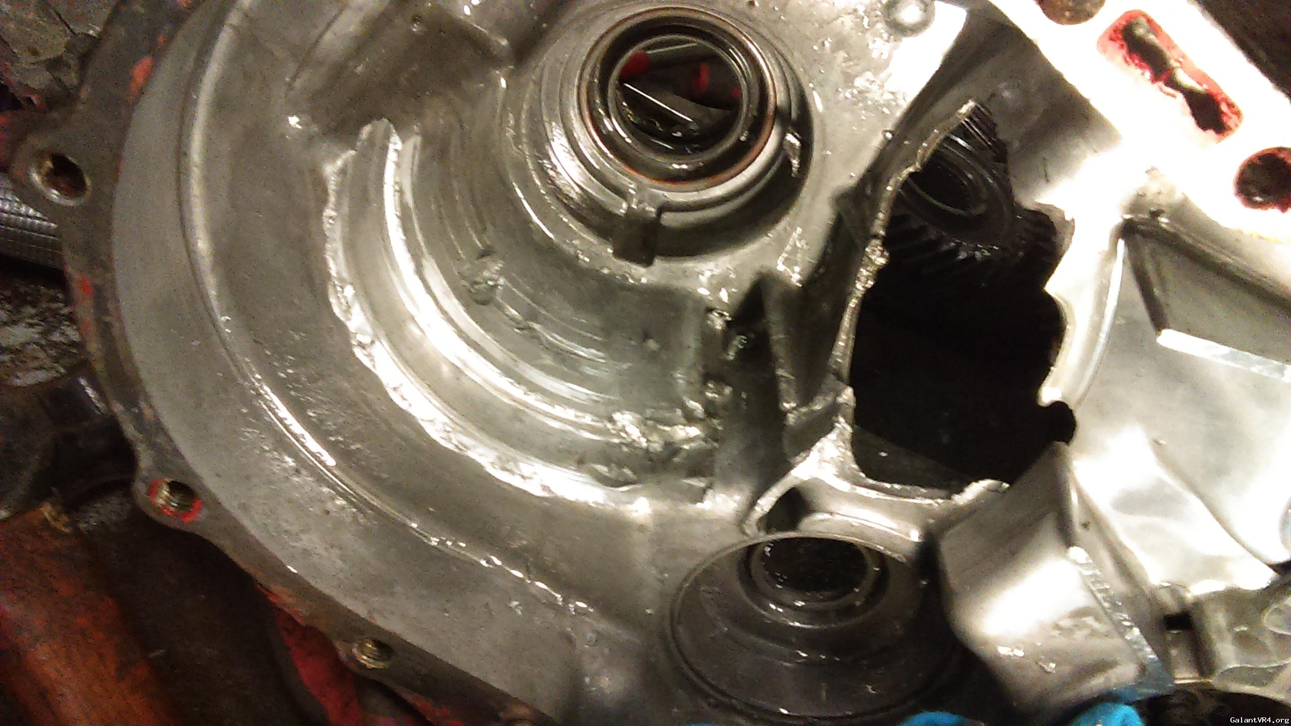

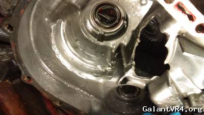

Damn! I figured out the cause of the silver fluid. The differential pin has been silently sawing through my bellhousing.
Still missing about an inch of the pin.

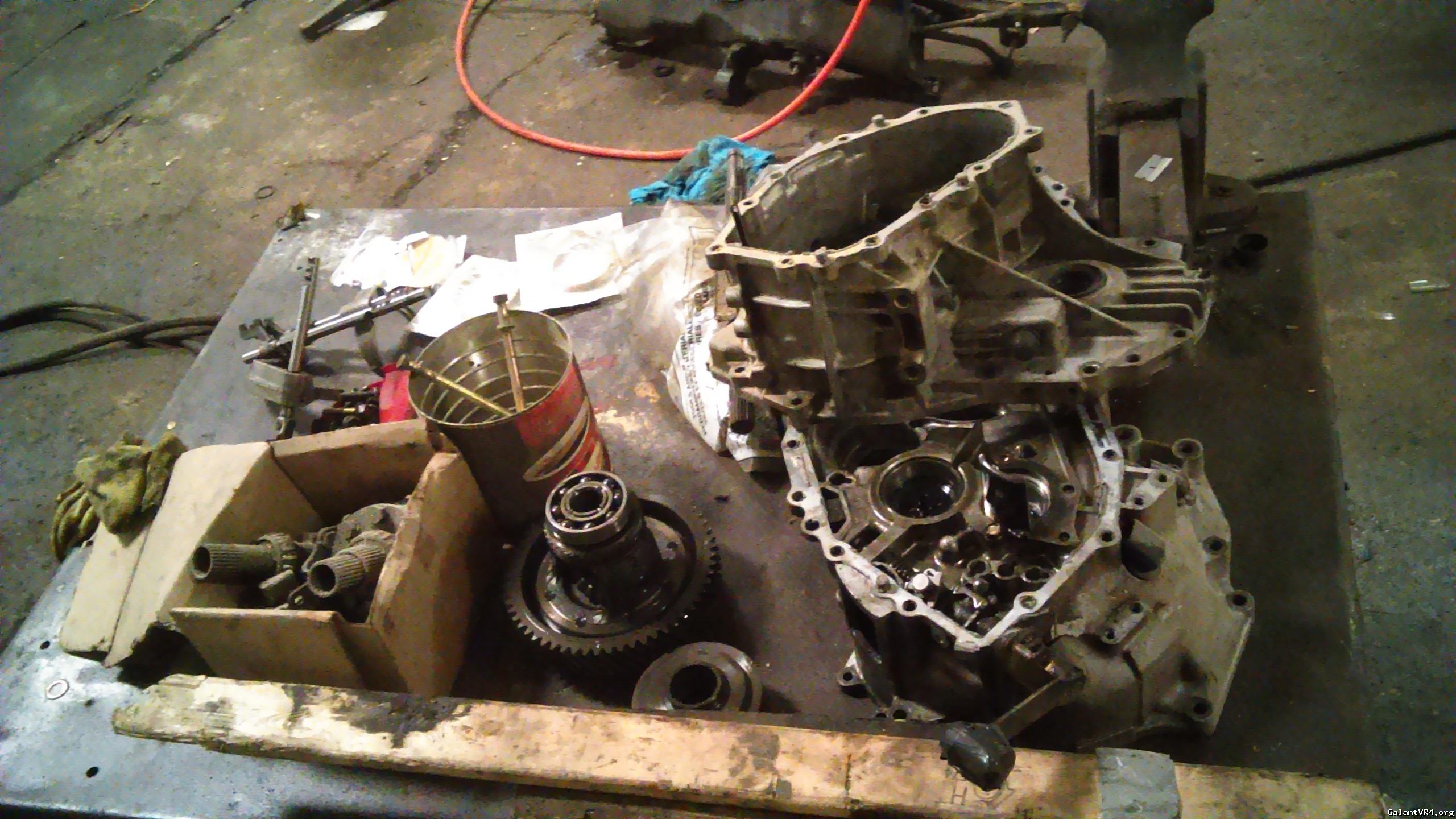

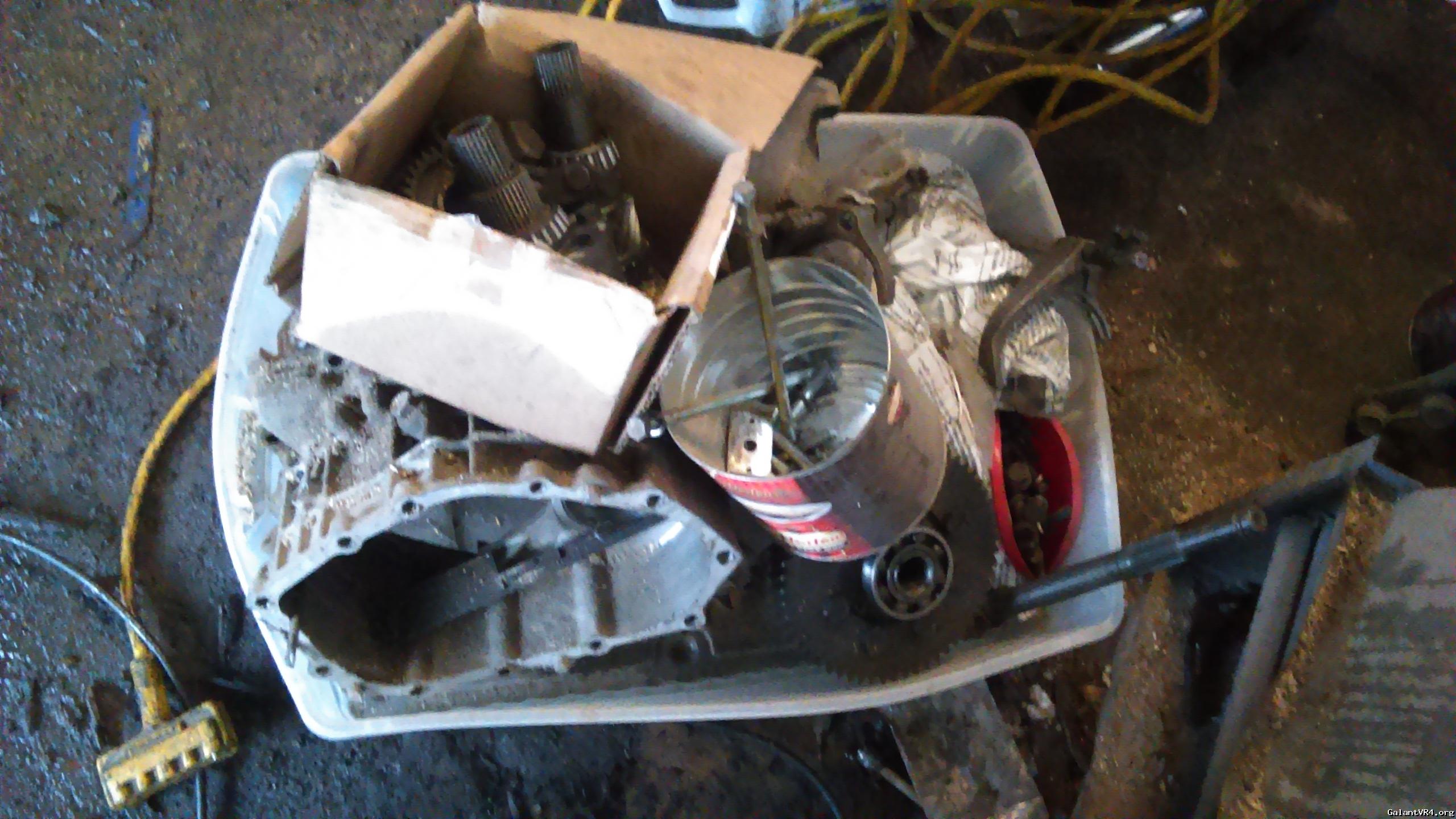

EDIT: here's a video of me tearing down the transmission real quick.

The pin looks nice! That's what Evo X's are famous for... /ubbthreads/images/graemlins/banghead.gif Good you had a spare box and got it back together! I'm guessing the clutch was ok?

Clutch was good. The release bearing was damaged, and the heads of the PP bolts were all gouged up, but I had replacements for both laying around the shop.
