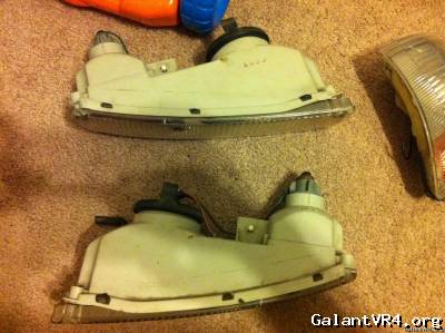

That sucks. I was in the exact same situation when I had 1813. The PO routed the intercooler piping right where the fog lights were placed in the bumper. That was a UDSM bumper though. The JDM bumper needs the fogs to really complete the look IMO.
Just talking out my ass, but maybe a set of pre-facelift fogs will fit? Can't really tell from a picture, but maybe they are a bit more shallow than the projectors.
Or maybe you could do this:
JDM Fog Light Delete

Looks good. You have JDM fogs for the bumper?
Not without fogs it doesn't. Some delete plates would fix that.

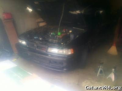

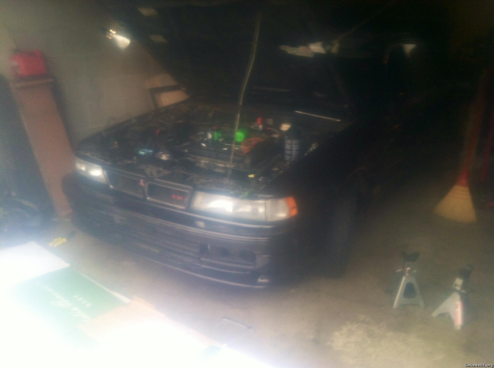

Have to pull the turbo back out to take the O2 housing off and weld a new O2 bung in for the MTX-L... She will be back on the road by next week if all goes as planned. Fingers crossed!
Side note; I hate not having enough light in the garage.

I have a flat bar LED MAC light and a chicken coop light....
Why the hell the builders of this house made a 2stall attached garage and put a single bulb light in a garage.... Not even enough room to hang a shop light because of the clearance from the roof and garage door, then the garage ceiling is split by the HVAC.... Ghey. /ubbthreads/images/graemlins/banghead.gif

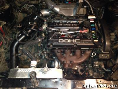

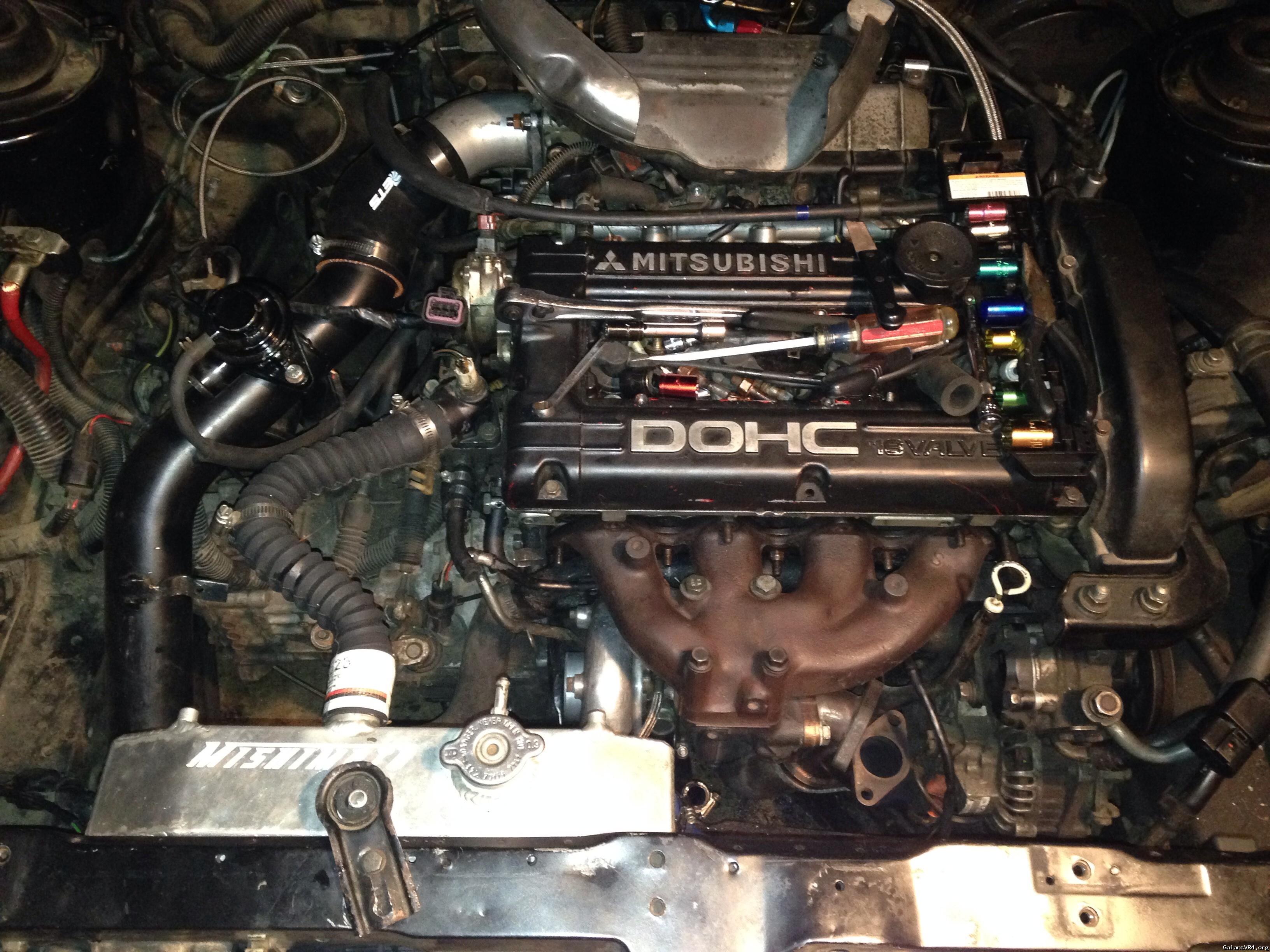

Have taken the car for a few spins. She feels good.
Problem I am having is that I am stuck in open loop and cannot get into closed loop.
Quick rundown...
Innovate MTXL WB
RC550s
91oct
Aeromotive A1000 set @ 40psi fuel pressure ( also corrected in V3L )
FPGreen OG
Recirc'd PR O2 with a 38EWG
Stock ex mani
Wally 255 rewired
Mishimoto Half rad 3" 3 core
Slim pusher fan
Crushed BOV
Short route piping
Large FMIC
And a few other odds and ends.
I have replaced my knock sensor and I am still getting a 0031 knock sensor code, yes I have replaced the sensor with a OE Mitsu sensor, the old one just lost all the gummy filling but didn't goo out.
Any help on getting me into closed loop or why I wouldn't be able to gain closed loop?
