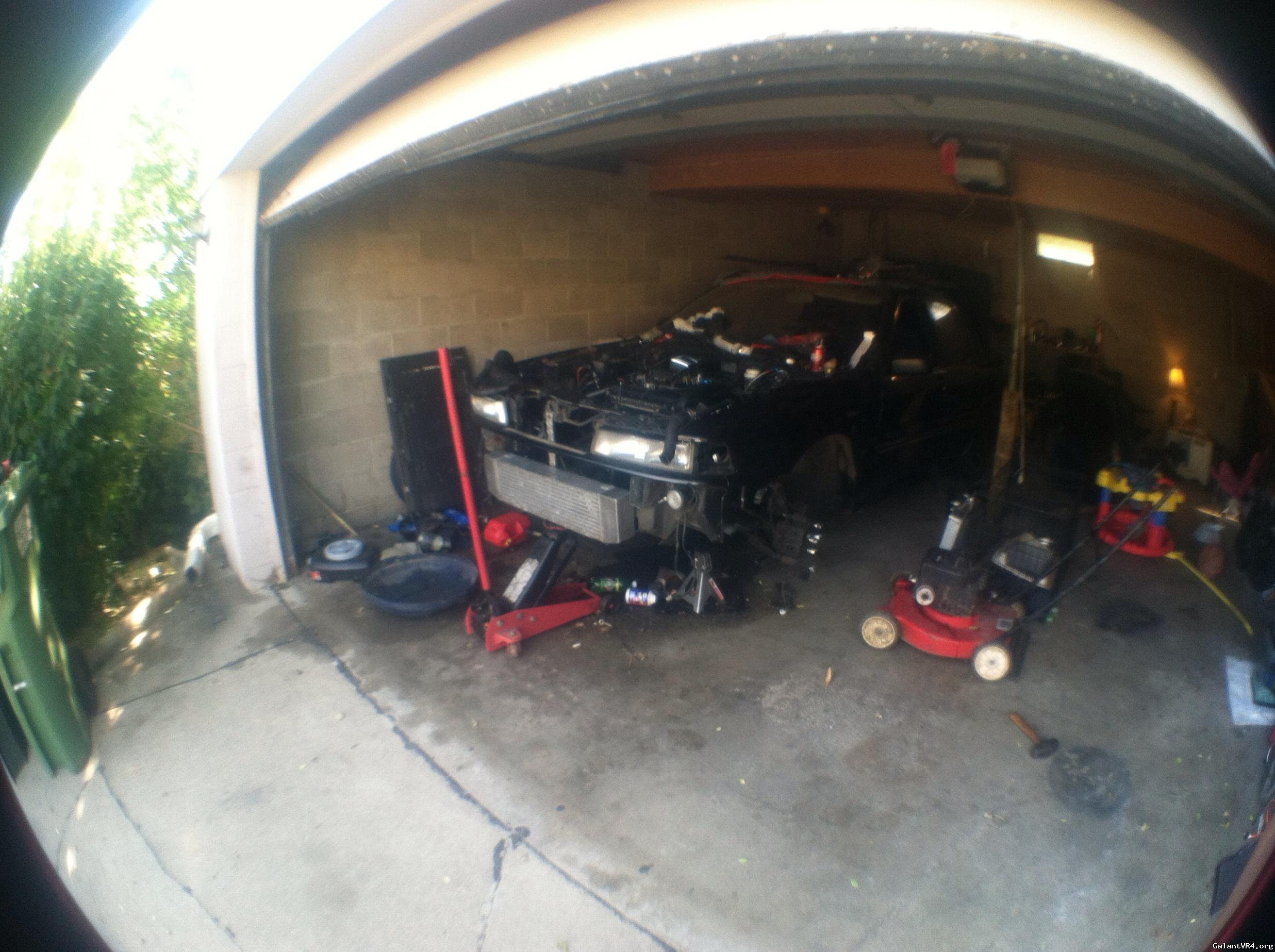

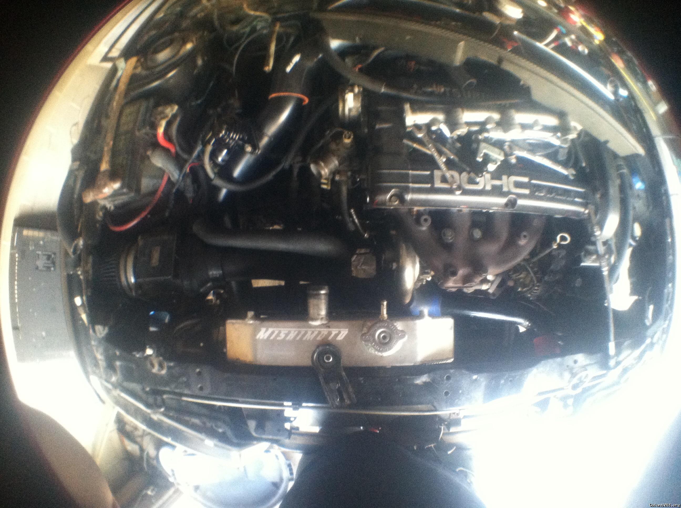

I haven't posted much of any of the updates I've done this year. That an I haven't take many pictures to document my build.

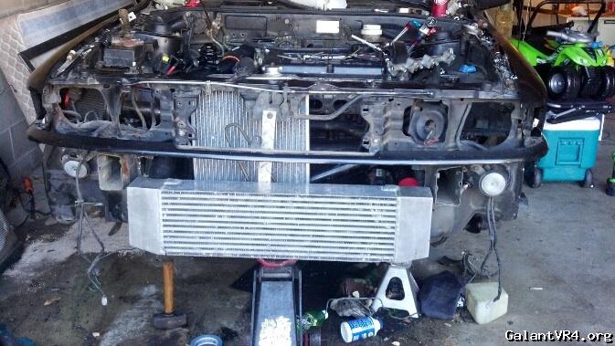

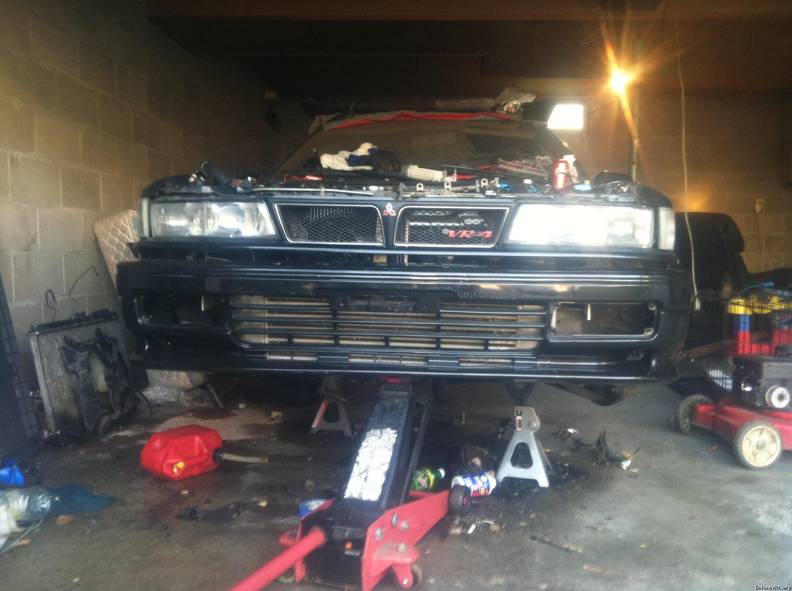

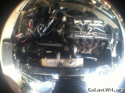

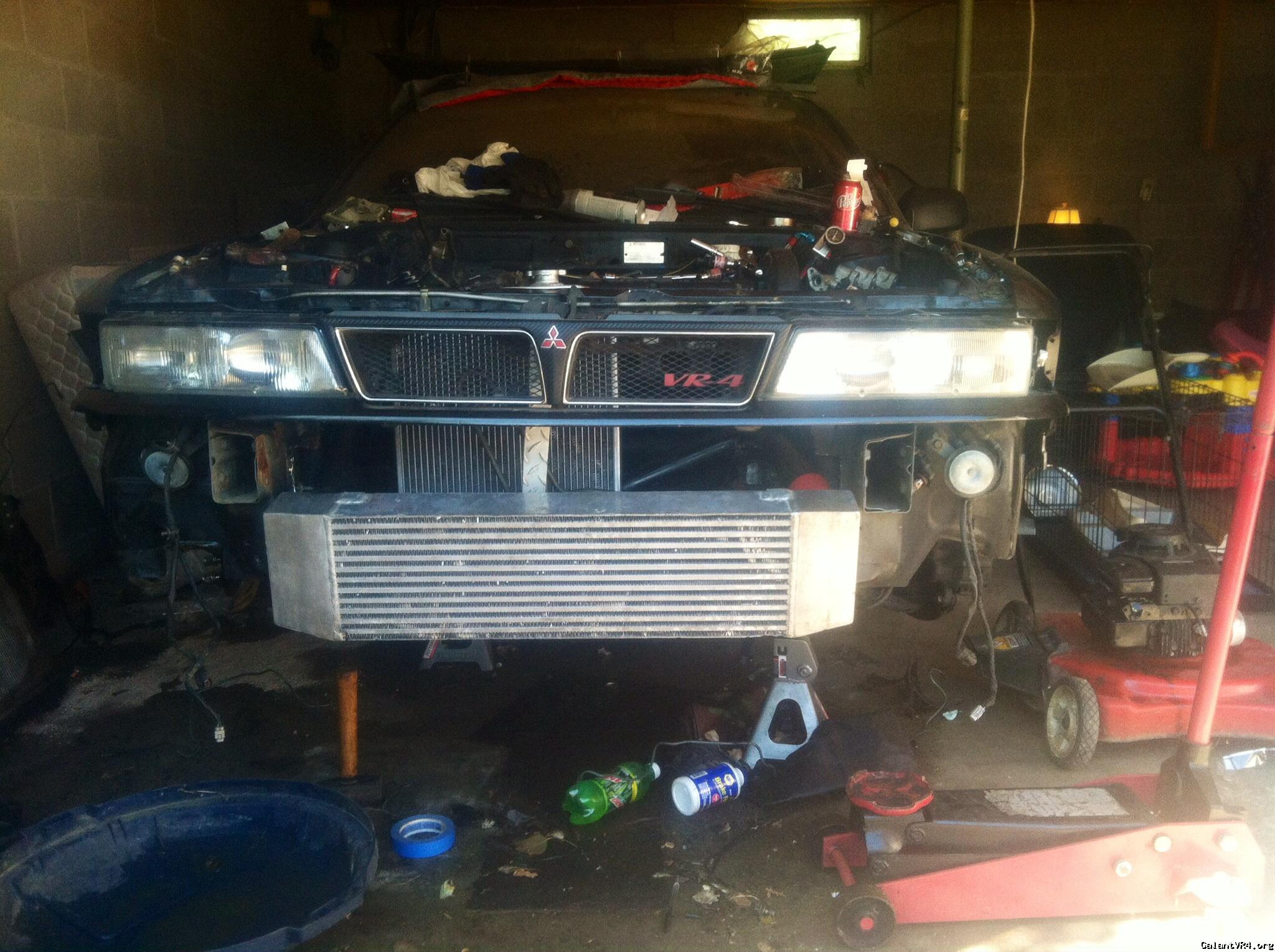

Today me and Steve (92gvr4num65) did some pipe routing and radiator mount fabbing.
But in the last few months I've added the Evolution RS front and rear bumpers, deleted AC/PS/4WS/Cruise swapped over from Keydiver to V3Lite. I also dropped in PTE 880s and had my FP Green 50 rebuilt along with the PR front core with short route pipe and the Mishimoto 3" radiator .... Slowly but surely it's all coming back together.
For now what's left to finish is to cap the rear steer lines change out the gas float in the tank and start it up. I'm excited. And I will try to load some pictures from my Android that I don't have on my IPhone.
That's all for now

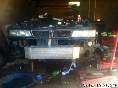

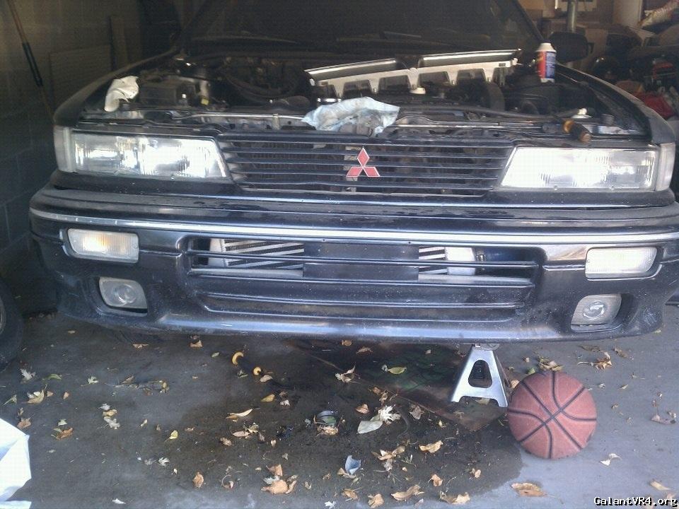

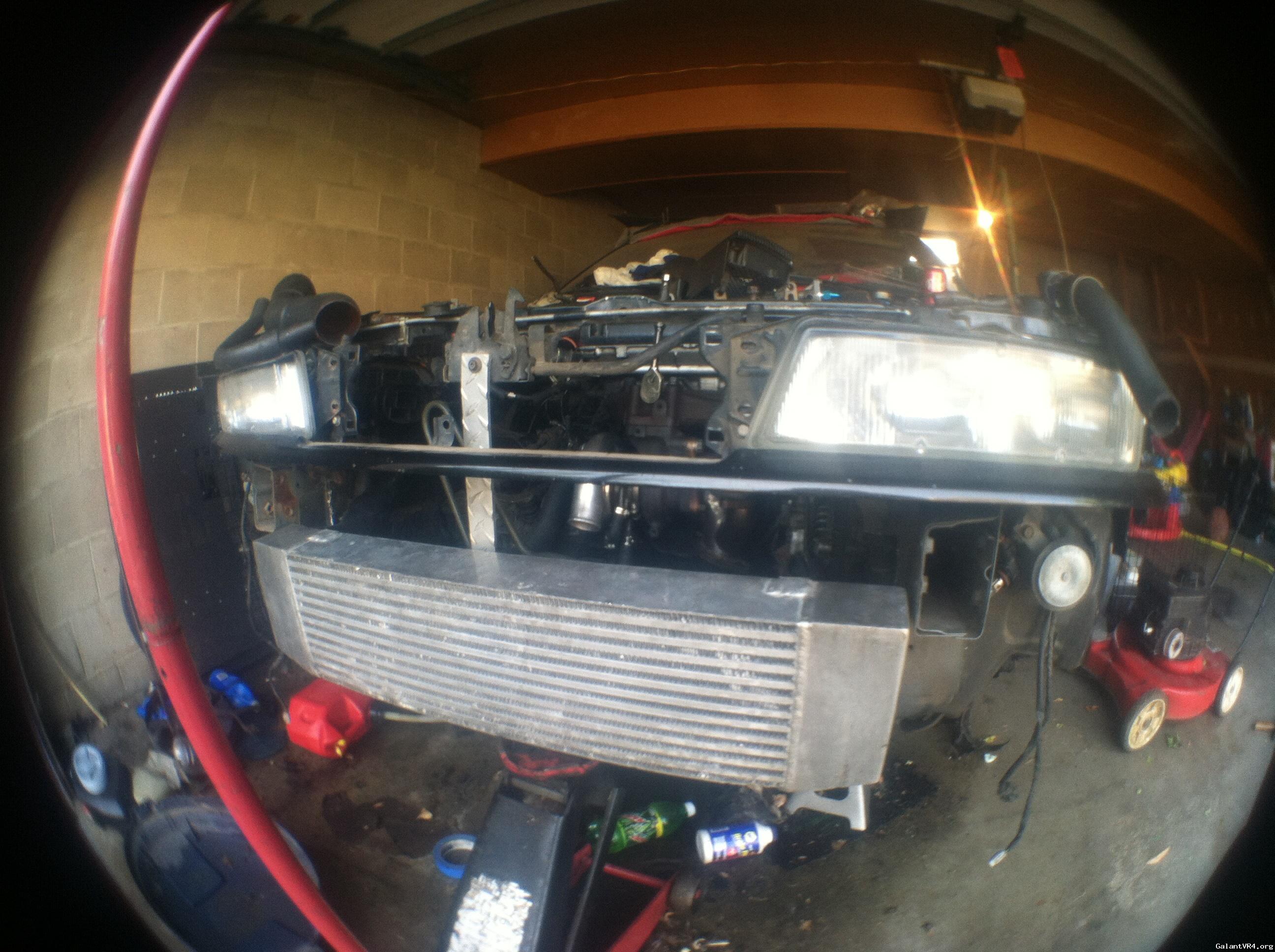

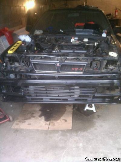

Been doing a few small things. Tomorrow I am taking the core to have some tabs tigged on. Just a shot of the lights and grill mocked up with the core.
I'm not sure if I should cut my RS front bumper or leave the slats.

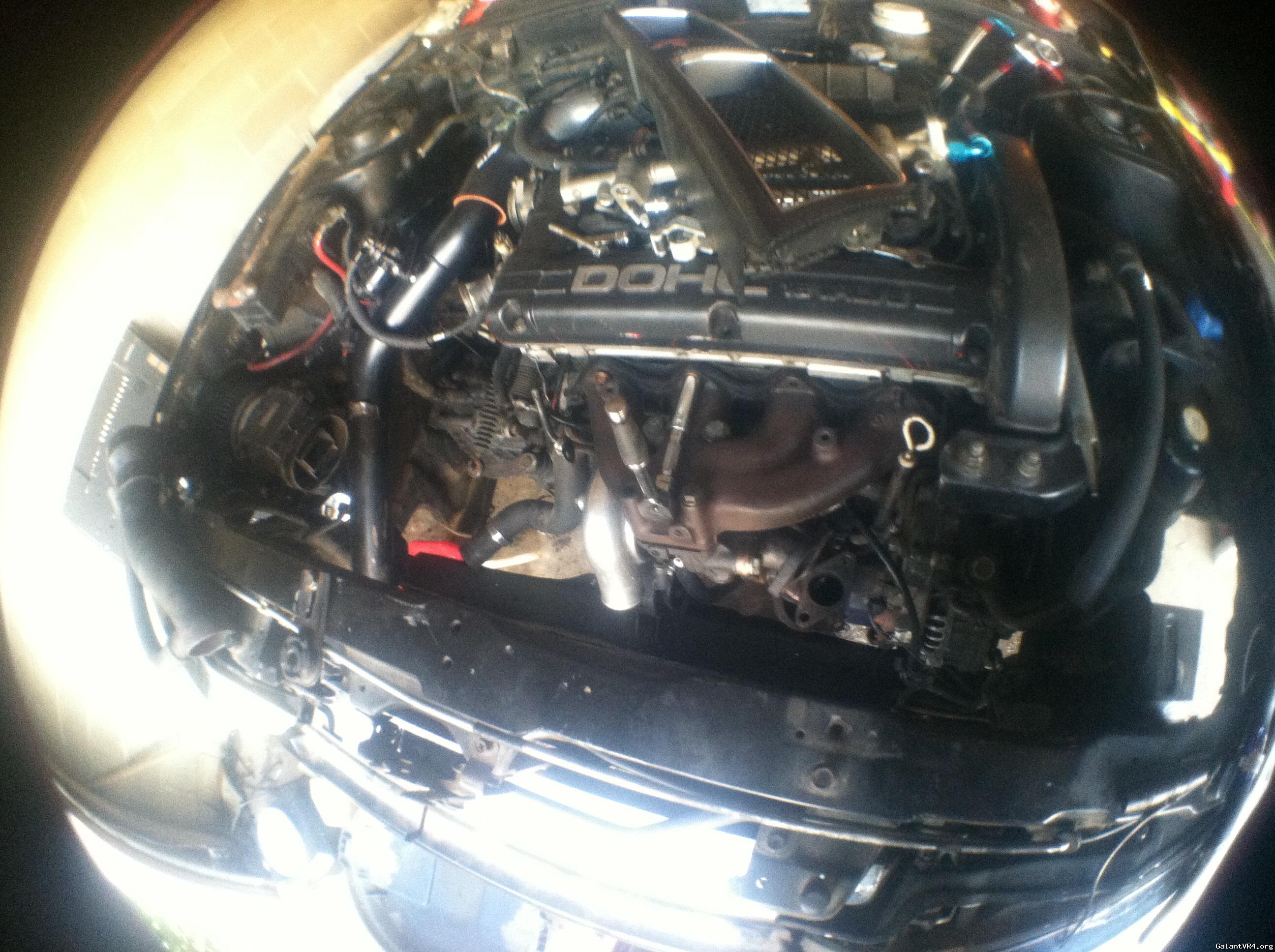

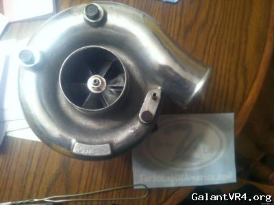

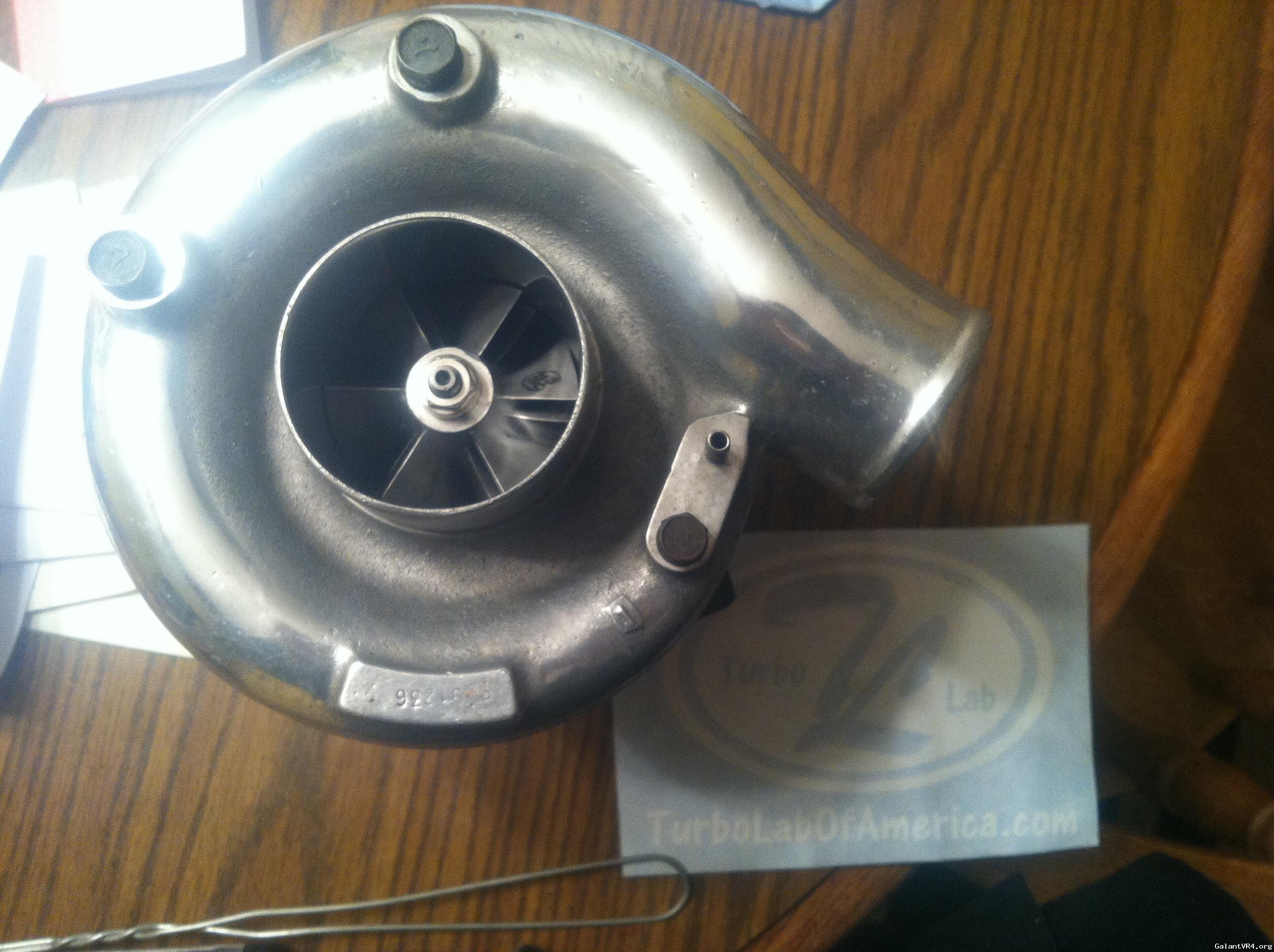

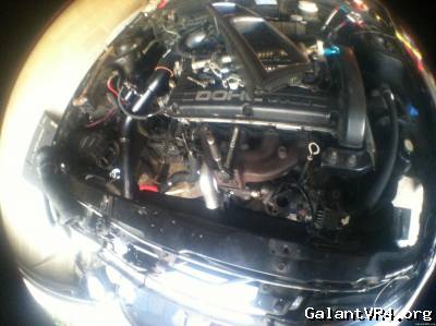

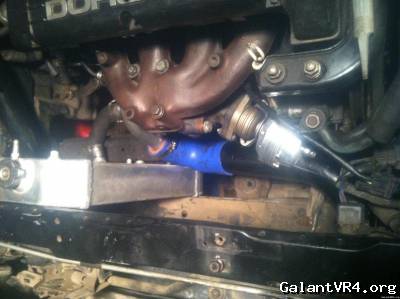

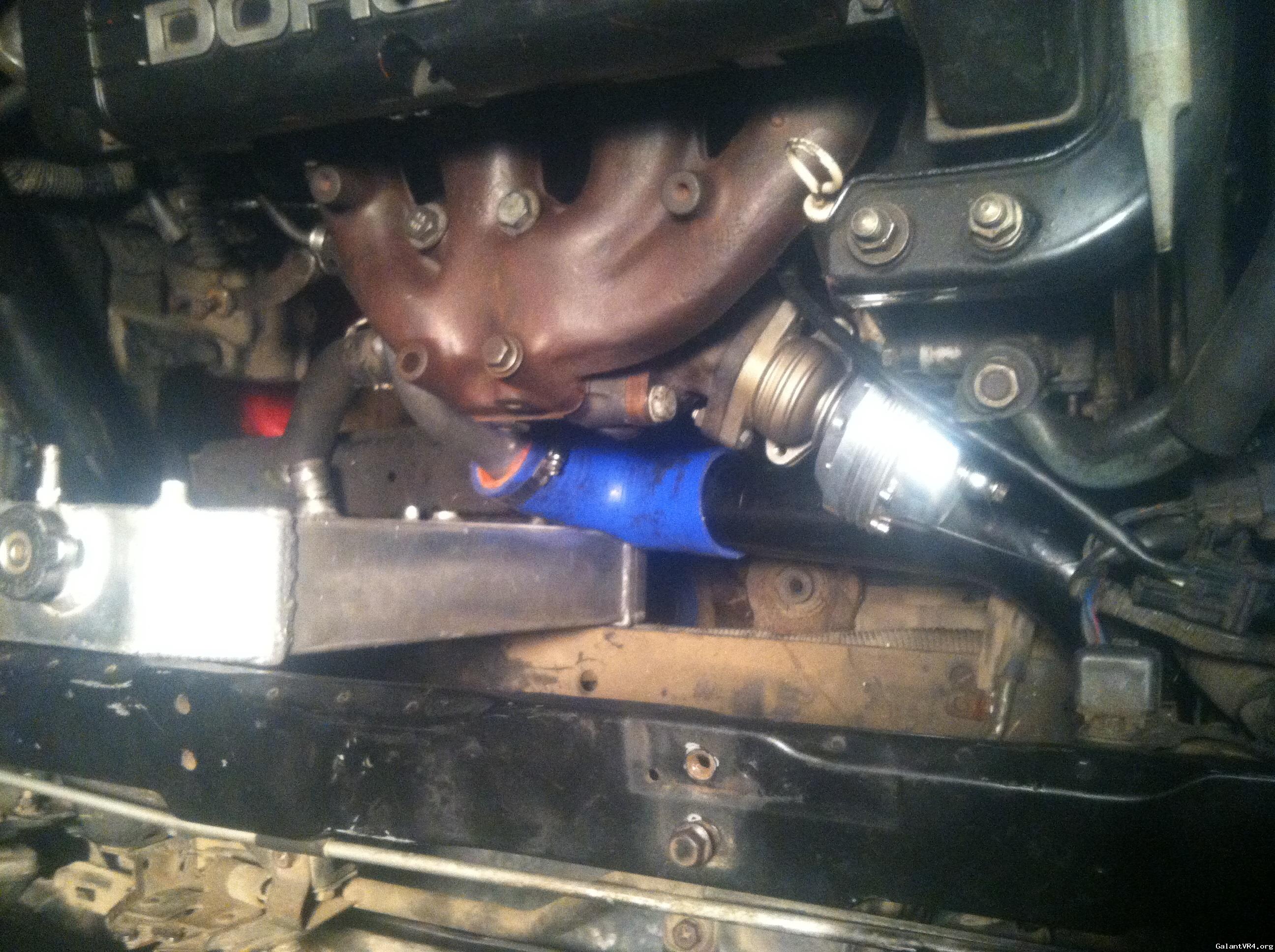

So quick update.
Turbo is on, exhaust is on, trunk is put back together, hood is on and so are the tires.
Waiting for a WB so I can set a start up tune and figure out the tuning gremlins.
Hopefully Friday I can start the car up, would it be horrible if I started without the WB hooked up? I have th WB O2 in the housing but not connected to the gauge.
Also best way to prime a turbo on the car? Was rebuilt and hasn't seen oil since and I don't want to trash anything.
Thanks guys I will add pictures soon.
