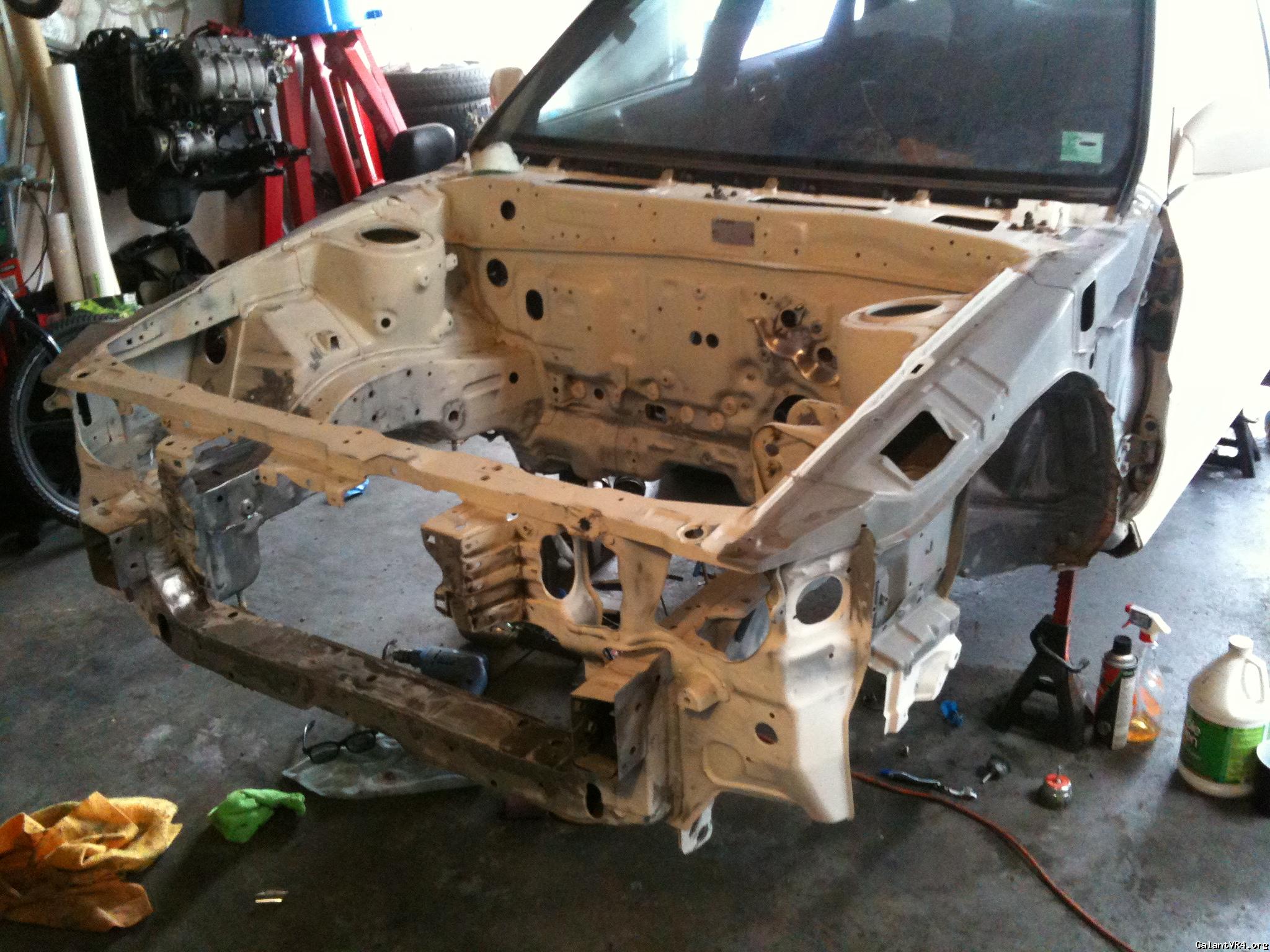

Not knowing where to start, I decided what better place than the beginning. Strip it down!

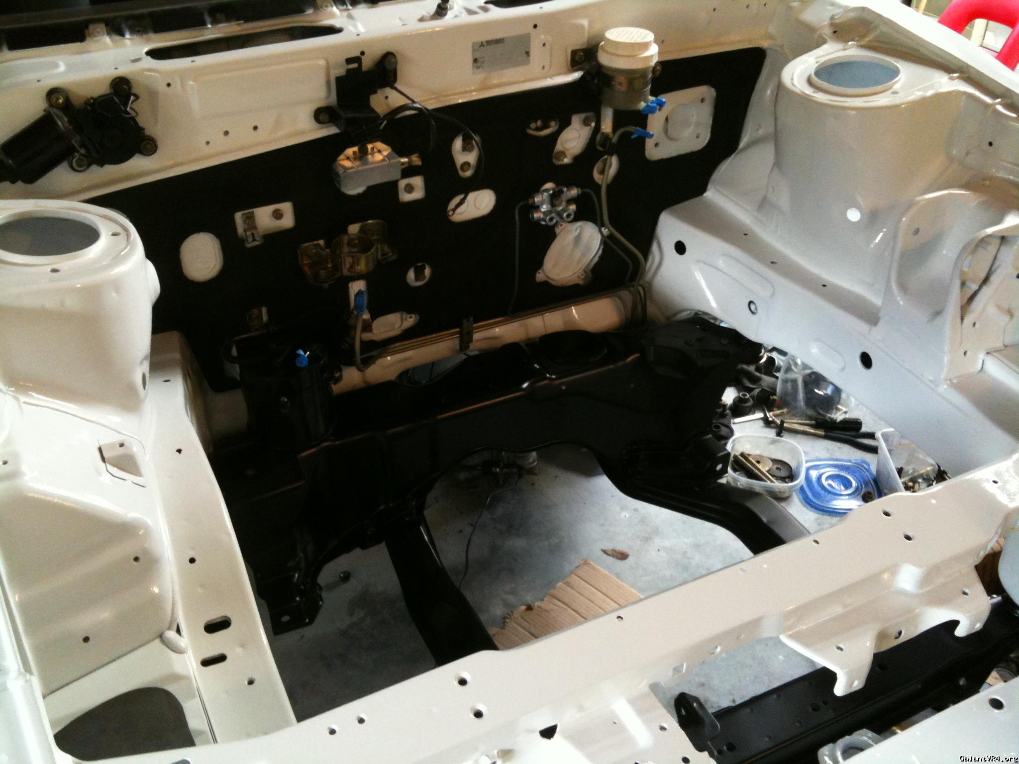

Like I said, everything was dirty! Everything was to get a thorough cleansing, replacement, repainted, or coated. All rust and loose paint removed from bay.

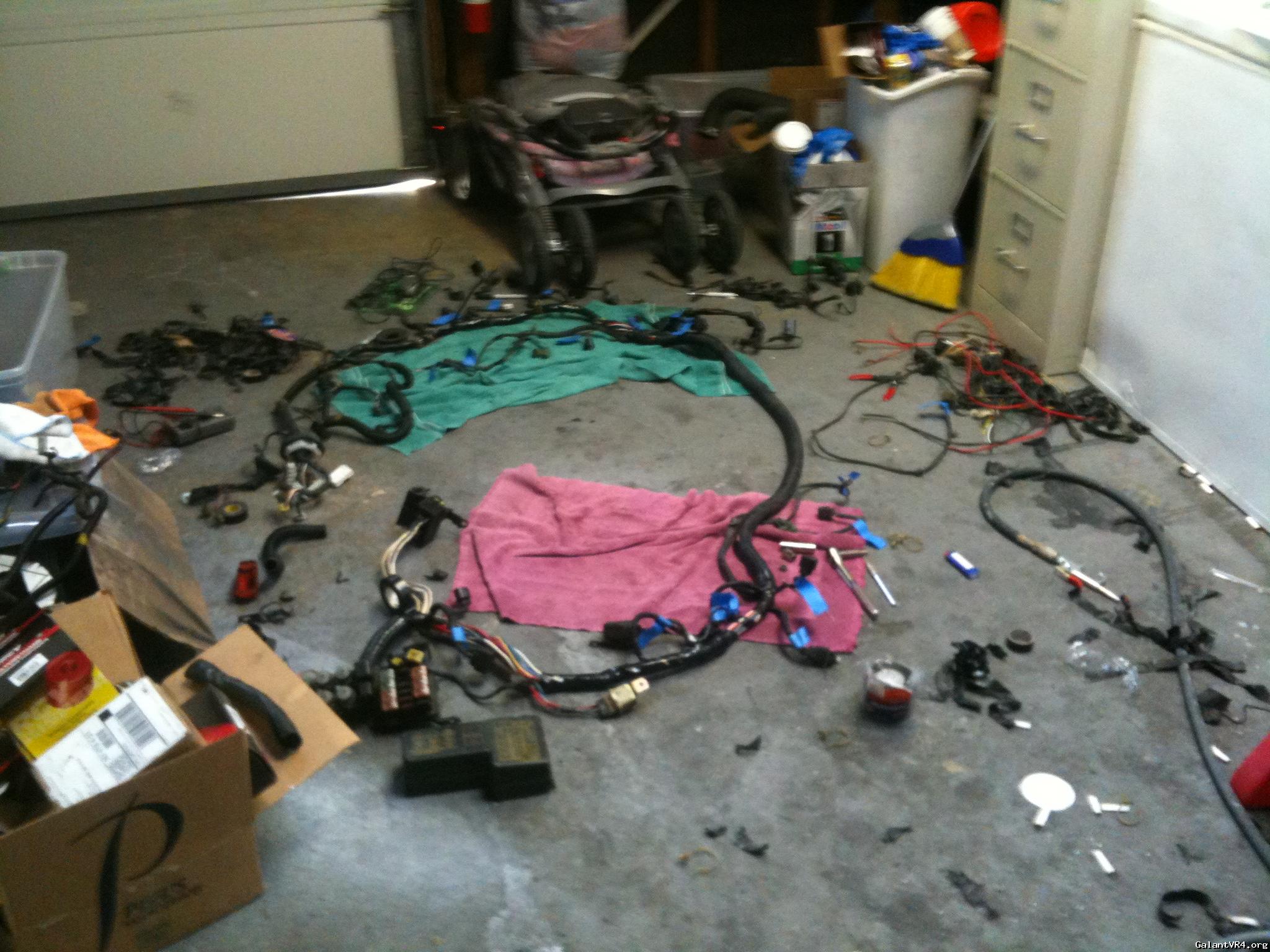

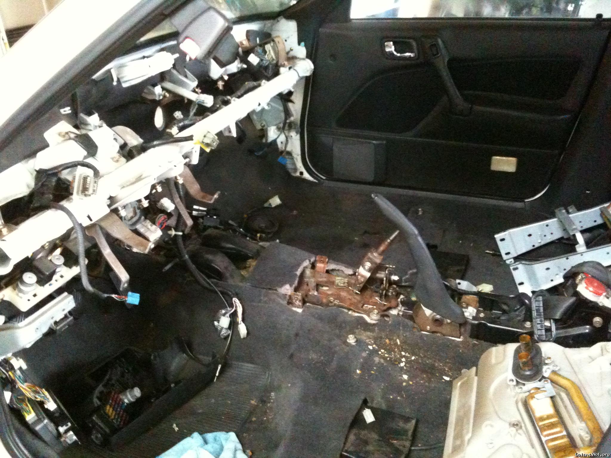

The interior was stripped as well. Heater core was replaced with a new OEM core. Wiring issues repaired.
While repairing/rebuilding the main electrical harness I yanked all wiring for the ABS system since the rest of it was already sitting in a pile of "not to go back on the car" parts.

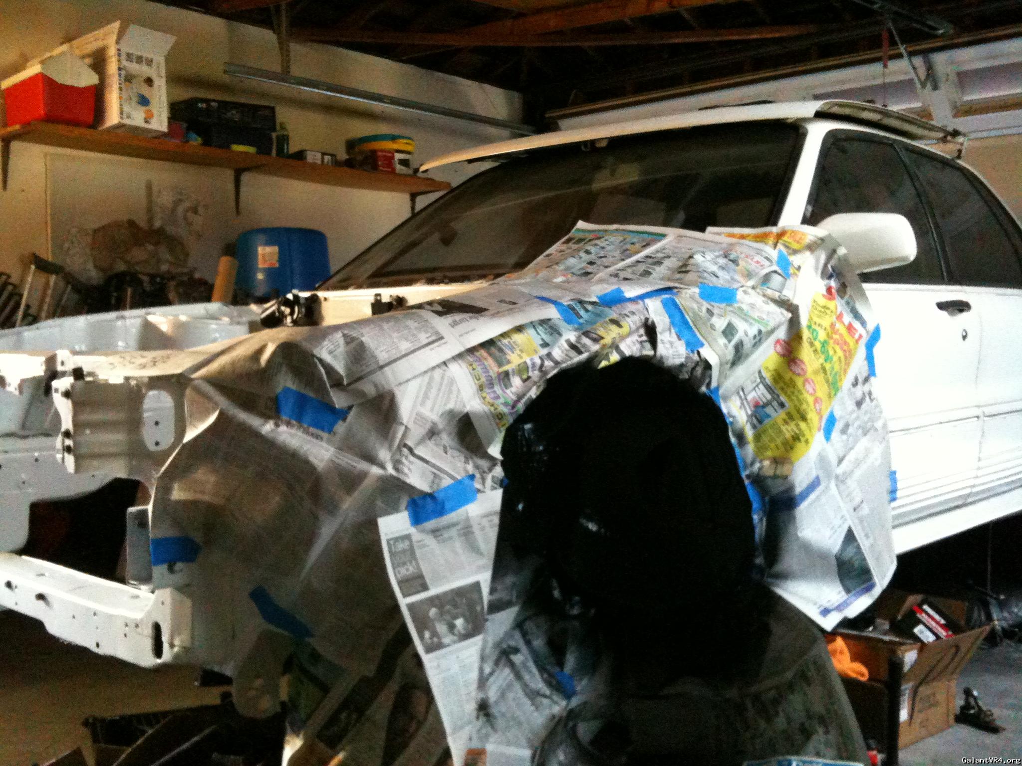

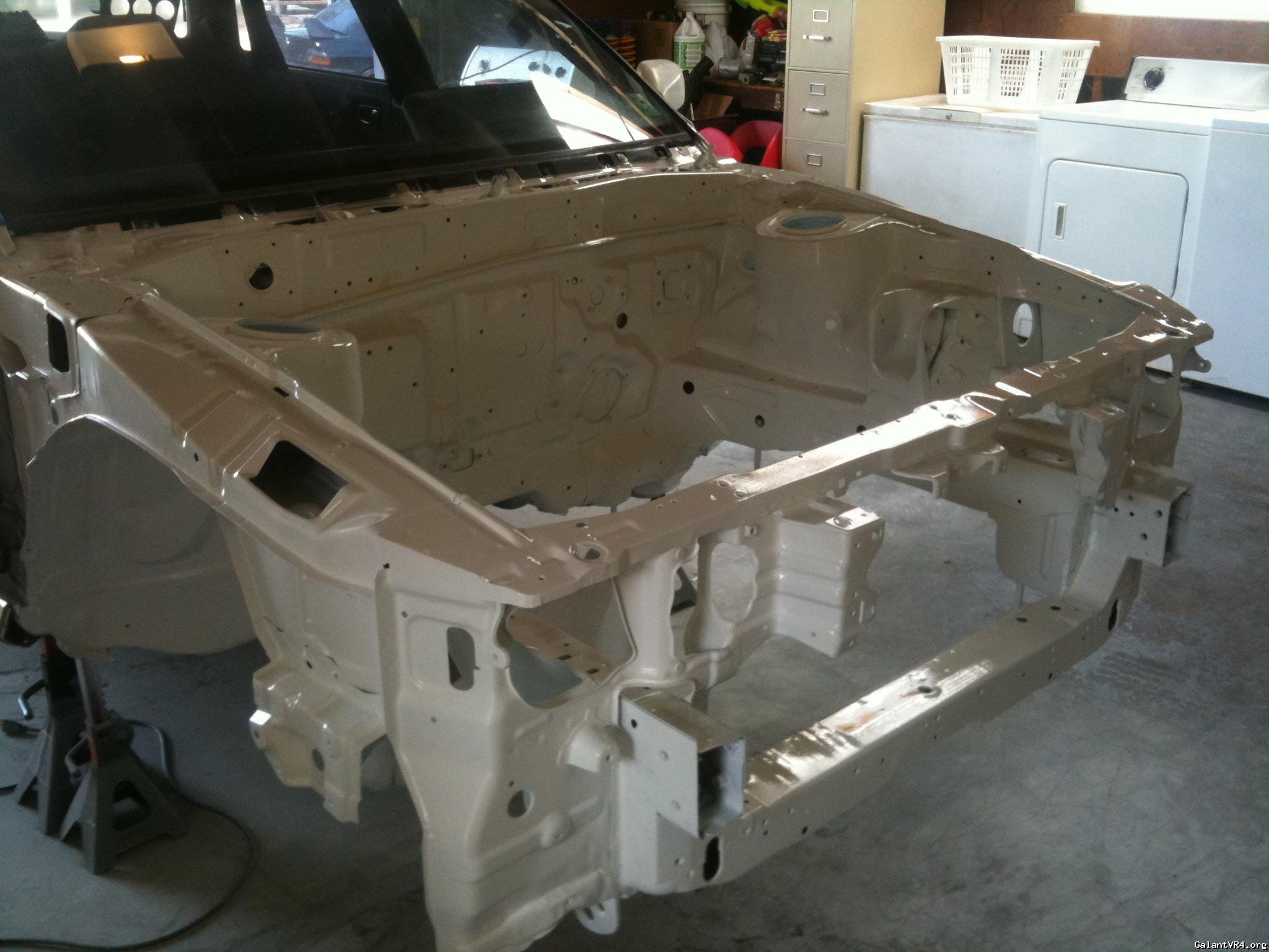

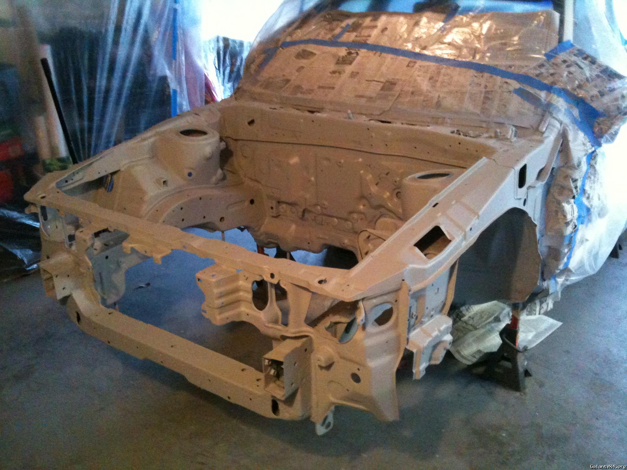

Front end primed. (sealant also reinstalled in wheel wells, not in pic)

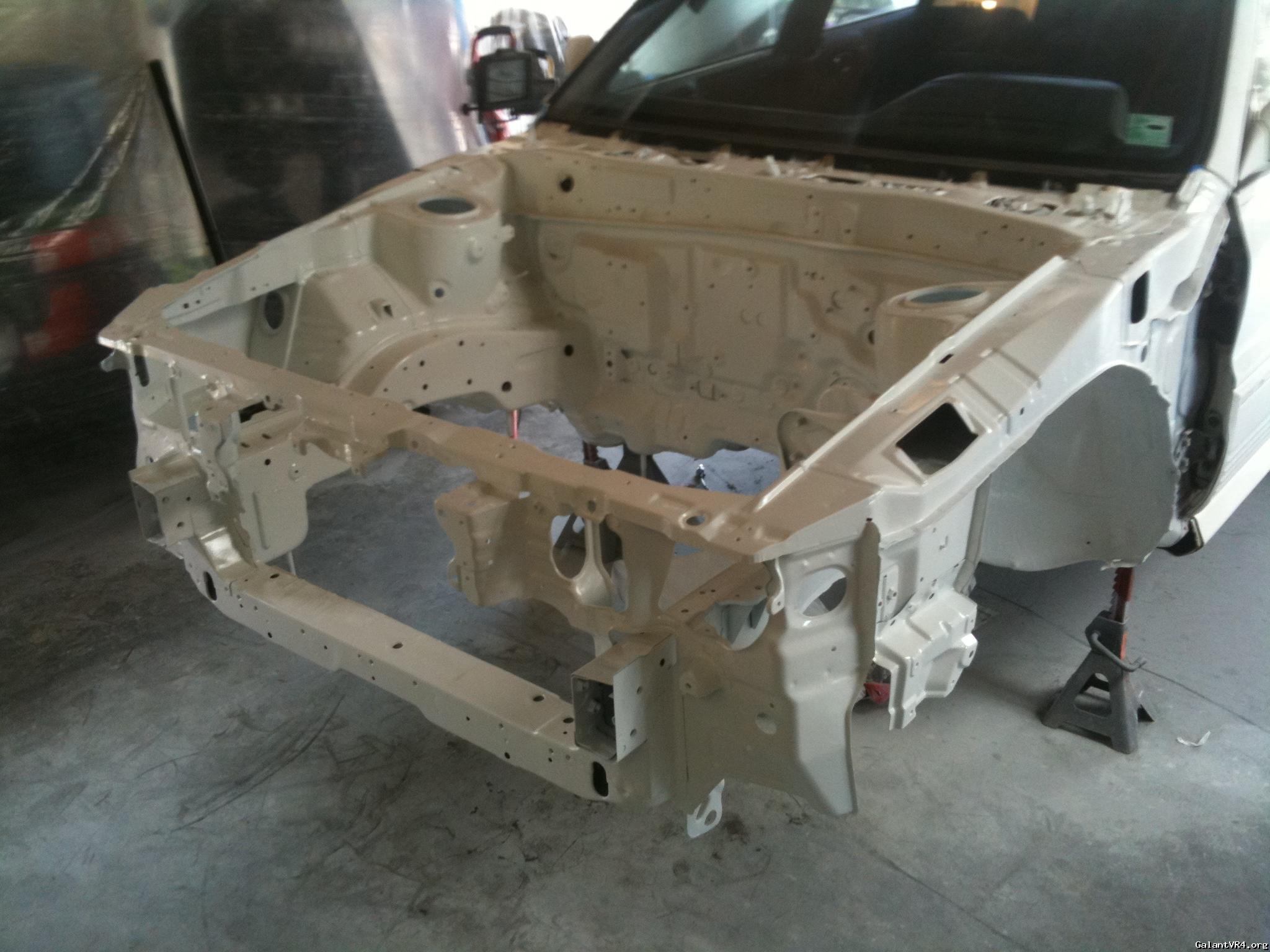

Painted, and cleared.
Undercoat re-applied.

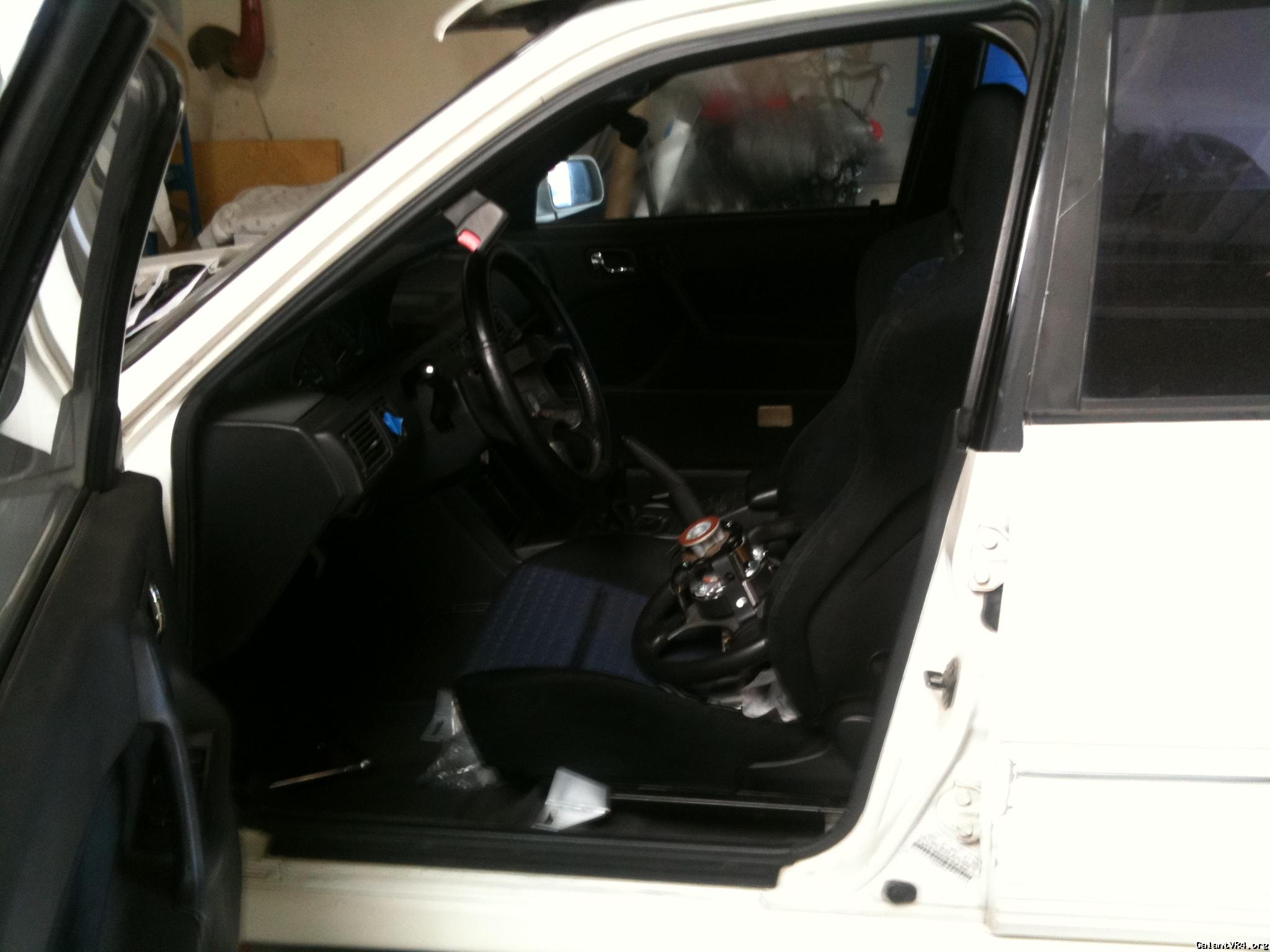

At some point a full Evo VIII insterior found it's way into the car. This was taken mid process, but as it sits now, the Steering wheel, front, and rear seats are installed.

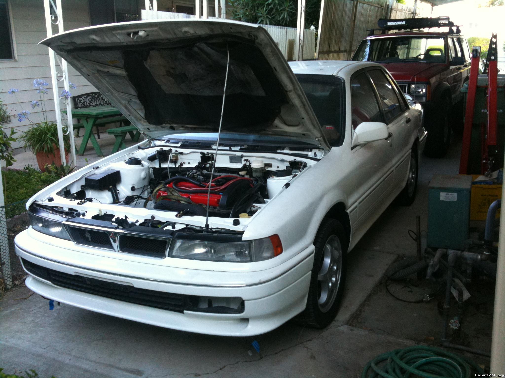

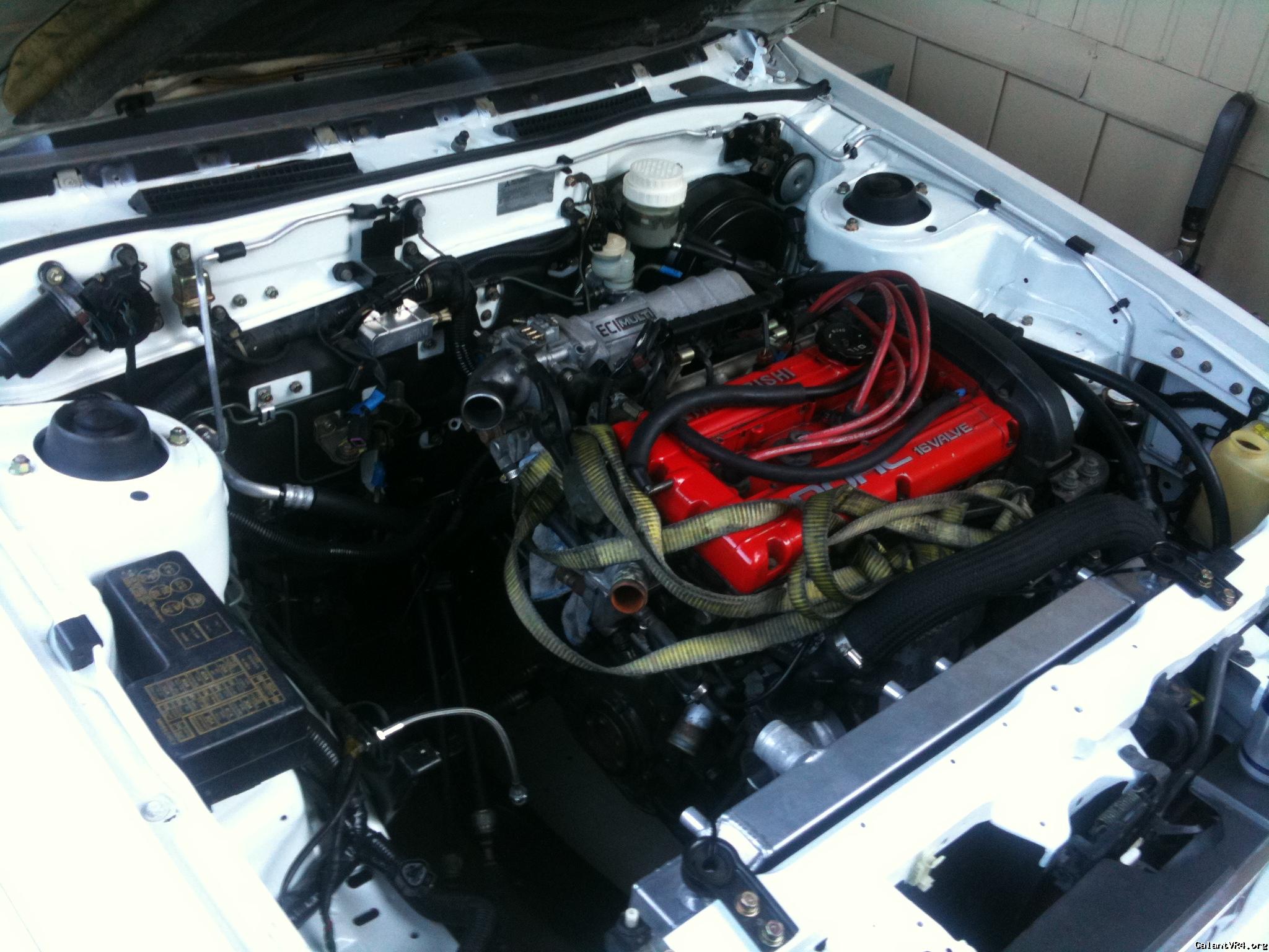

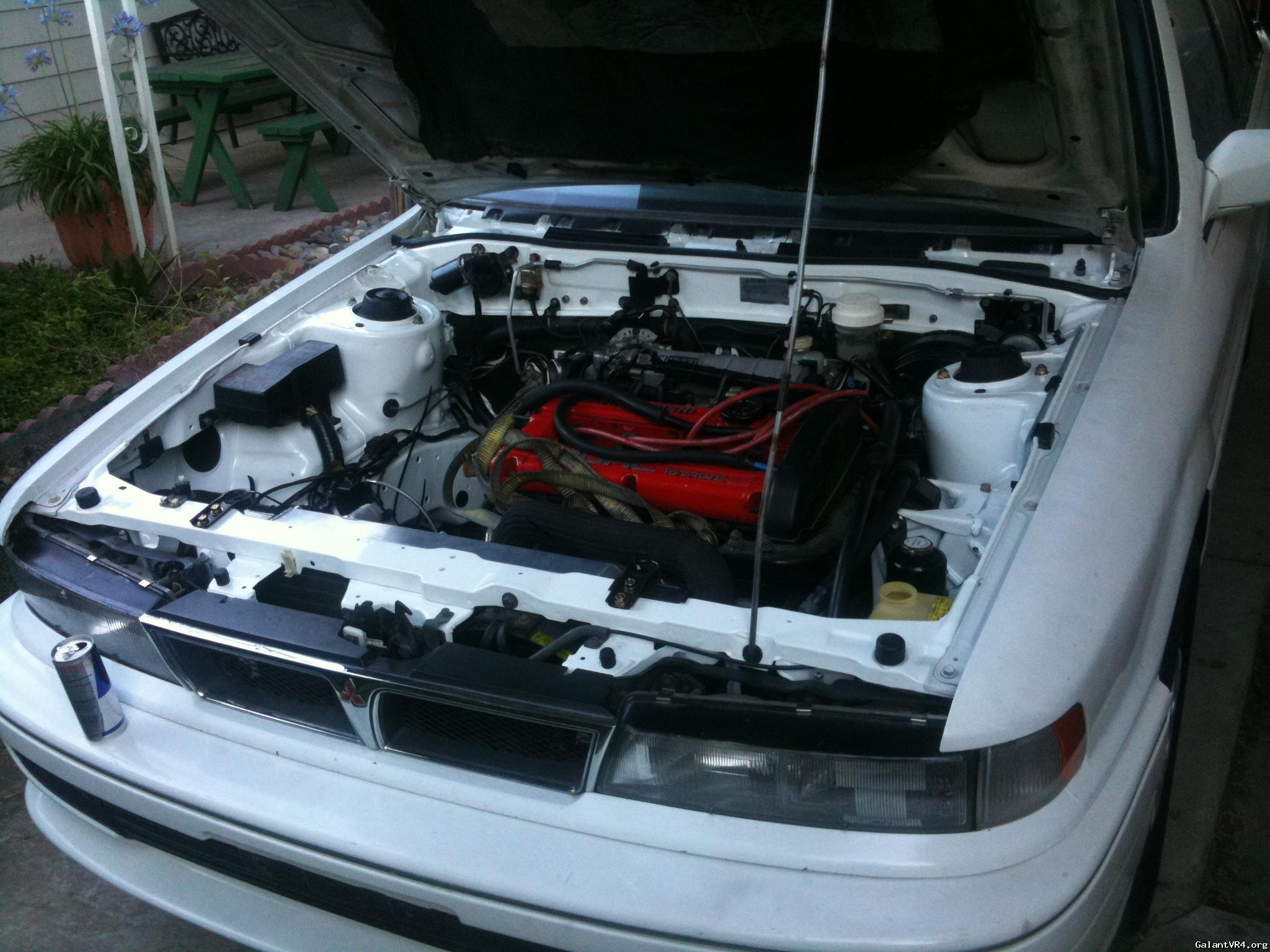

And here's how it sits right now. The engine will come back out. It was only recently dropped in for easier transport while I moved. This is not the original engine, but a known good engine from another GVR4 - just needs a timing belt job, water pump, a few seals replaced, and a good cleaning before it goes back in permanently.
I also picked up a good GSX tranny and 4 bolt LSD rear along the way. The rear end will be getting the same treatment. Everything removed, cleaned, painted, coated, etc.
Oh, and I also managed to find a JDM front and rear bumper in my color! /ubbthreads/images/graemlins/smile.gif I do have the projector fogs, but haven't installed them yet.
Unfortunately progress will now slow down since I have found a new job. But, I'm currently planning to be driving the car before the end of October since it needs to be smogged by then so I can register it (without having to non-op).
Nothing too exciting as far as mods. My plan was to freshen up the car, repair any and all issues, get it back to a reliable stock condition, then begin to mod once I know everything is working as it should (and looking amazing). /ubbthreads/images/graemlins/cool.gif
