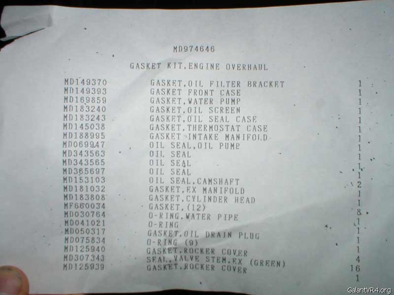

Here is a list of the contents of the DOHC non-turbo gasket kit. I chose the non-turbo because I already had the turbo gaskets. I wish I could have found this before I bought it, I paid 170 for the whole kit and I didn't need the head gasket or the 16 valve seals!
Parts that I would consider missing from this kit that are necessary:
valve cover half moon seal MD050536
Don't forget to make sure you have a crankshaft dowel and all your flywheel dowels (3).
Make sure you have two good cylinder head bushings (dowels) as well.
These are cheap parts that you can't get out of old blocks without destroying and will hold up a rebuild like it was their sole purpose. Machine shops are notorious for leaving these out.
Notice a couple small gaskets aren't available from Tallahassee Mistu which is where this price list was generated:
MD149370- GASKETOI $ 1.61 $ 1.61
MD149393- GASKETEN $ 7.33 $ 7.33
MD169859- $ 0.00 $ 0.00
MD183240- GASKETOI $ 1.39 $ 1.39
MD183243- GASKETRR $ 1.97 $ 1.97
MD145038- GASKETTH $ 2.17 $ 2.17
MD188995- GASKETIN $ 7.86 $ 7.86
MD069947- $ 0.00 $ 0.00
MD343563- OILSEAL $ 11.03 $ 11.03
MD343565- OILSEAL $ 8.69 $ 8.69
MD365697- OILSEAL $ 6.66 $ 6.66
MD153103- $ 0.00 $ 0.00
MD181032- GASKETEX $ 14.14 $ 14.14
MD183808- GASKET $ 42.02 $ 42.02
MF660034- GASKETT $ 0.07 $ 0.54
MD030764- ORINGCO $ 2.17 $ 2.17
MD041021- ORINGEN $ 1.39 $ 1.39
MD050317- GASKETEN $ 1.06 $ 1.06
MD075834- ORINGEN $ 0.74 $ 0.74
MD125940- GASKETRK $ 3.85 $ 15.40
MD307343- SEALEXHA $ 3.30 $ 52.77
MD125939- GASKETRO $ 21.12 $ 21.12
SubTotal $ 200.06
