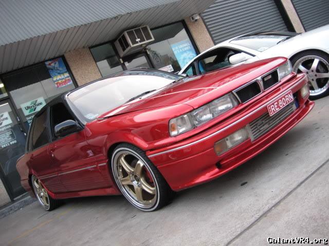

6: Paint the car P26, Rally Red (Gorgeous color)
I like everything on your list besides this step. Why not keep it the stock color?

Dark Horse: I have always had a soft spot for red Vr4's. As far as color choices, red isn't my favorite by far, but I can't help but admire the elegance of a red Vr4. My favorite car color is black, white pearl being next in line. So I was either going to go with Satin White Pearl (Found on most modern Subarus) or P26, Rally Red. I have painted 3 or 4 Valve covers this color, and I just fell in love with this red. Like I said, I'm not much of a red guy, but P26 is by far one of my favorites, and after seeing this Galant, It just made me melt.
I am not much for the rims, but color itself.... it's a perfect balance of elegance and "fierce"...
