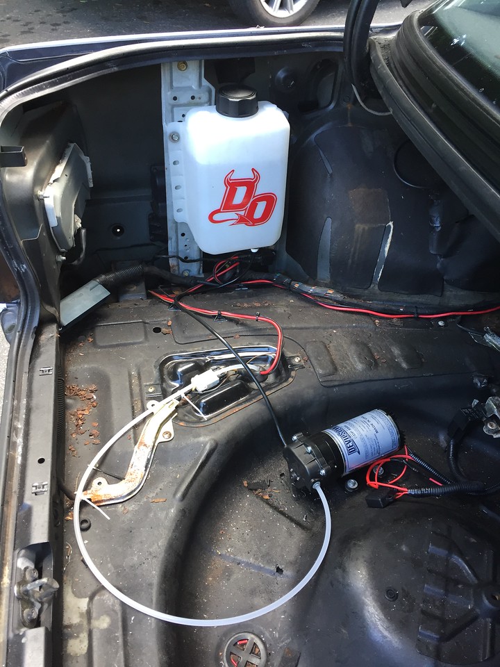

I'm getting my ass kicked by this meth kit.
[*]Installed the pump, tank, nozzle yesterday....go to route the hose under the car: it's 6" too short to reach with it routed logically. (it would fit, only if stretched stupidly). trip to home depot for a roll of 1/4" nylon hose.
[*]Install the new hose between the pump in trunk and check valve under hood: zip tied to existing fuel/brake line route.
[*]Wired up a relay, absolute bare minimum..."always on" power directly to battery in trunk...DSMlink FPS output will ground the coil of the relay. Relay feeds power to the Pump, pump is grounded to battery.
[*] Setup DSMlink FPS output for 3500rpm, 1.5 loadfactor, 80% throttle, 5mph activation. Set AuxMaps to activate on FPS output. Copied my "pump gas" MaxOct maps and pasted to MinOct maps. Left fuel alone, added 2* of timing to the MinOctTiming map from 3500/1.5 up.
[*]Next: Dumped in a gallon of Denatured Alcohol from the paint section of Home Depot (stopgap till I can obtain some meth)....fitting at bottom of the tank is leaking hardcore!
[*]Touch the fitting: SNAP OFF. /ubbthreads/images/graemlins/bawling.gif
[*]Trip #2 to home depot.....nothing even close to a correct replacement for the tank bulkhead w/ integrated 1/4" push lock. I got a few misc 1/4" and pipe thread items that I can makeshift fix it till I can get a proper bulkhead from Devil's Own. [/list]

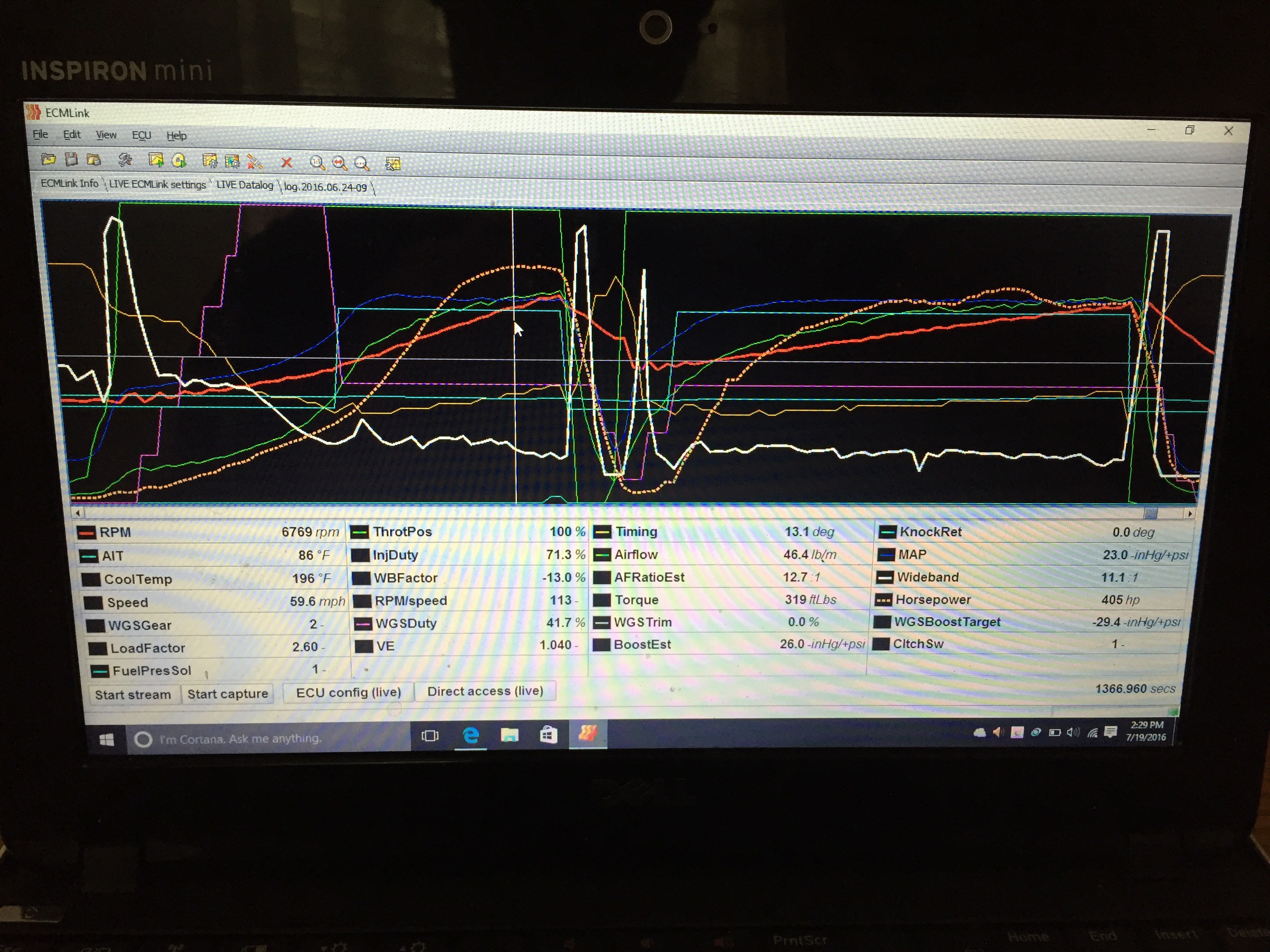

well...I got the system spraying....first few tests were good, until ...got a misfire. Now I can't get the misfire to go away, even with the meth turned off and the boost down to 21psi. WTF,. guess another trip out to buy fresh plugs (pulled them twice, they look fine, reggae to .020")
First test was with 20psi, street timing map +2* and no fuel changes (11.0 AFR target on both DA fuel maps): pig rich..WB won't read richer than 10:0 apparently on the log. anyway..it was flatlined...and gave a little stumble misfire.
Secont test: boost to about 24psi...Set the secondary fuel map to 12:0 target...now it ran cleaner, but the wideband still showing low 10's.
Third test: boost to 30psi. secondary map set to about 12.3 target....ran clean till second pull got a misfire. (I had boost control set kinda f'd up...forgot to disable correction, and left the boost targets way low at 20...so it was spike to 30, then error correct pulls it back down).
Fourth test: disabled error correct on the boost control. set secondary map to target 12.5. now it misfires soon as boost comes up.....

Stock ignition coil/module, NGK wires, BR8ES now gapped at .018". i I didn't have any misfire issues prior to the alky, even running as high as 28psi at the track few weeks ago. plugs were new that day and went in at .022" I got a few clean pulls in with the boost turned down to 23psi and the alky on, and am making progress.
I moved the FPS trigger up to loadfactor 2.0 (about 15psi) up from 1.5 (about 9psi) and that seems to have helped/cured the misfire. I bet I was flooding it and wetting the plugs with the meth coming in too early. Link says it's making the same 400hp estimate in second gear as it made at the track with 28psi and the timing all pulled back from knock.

Tune is getting there. fixed the misfire by moving the activation point up to 15psi and leaning it out. Raising timing another couple degrees (Im like 6-7* more than last track day on straight pump). Got boost up to 26psi this morning. Very little/random knock. AFR around mid 11's overall. DSMlink now showing high 400's for power in second gear, and mid 400's for 3rd gear.....HUGE increase vs straight pump. Will see at the track on friday, but Im calling this a flat out success so far. The car SQUATS HARD now and torque steer becoming an issue!

Yeah, Iv been kinda judging my results/mods against the DSMlink HP calculator for quite a few years on all the cars Iv run it on...and regardless of the actual absolute #, (just like dynojet #'s), it's all about the comparison of changes. in back to back logs. Im far less interested in that it says 400 or 500 or 300.....than I am that it picked up consistent 15-20% power with the meth vs the best power I was able to see on straight pump 93.
The settings are spot on for RPM/MPH for each gear. Im estimating 3400b total weight. The drivetrain loss still set at 20%. I run the two smoothing settings at 8 and 6 respectively (I think defaults are 4/3).
Im going to the dragstrip tonight to Test & Tune...the ET/MPH will show the results for sure:
The car went 12.3@112 on it's best run last time (pump gas only). 27psi boost. Very low timing (curve like 2* to 7*), AFR in the mid 10's. Knock pretty bad in 3-4 gears. Link shows 400hp peak in second gear and 350-360's in 3rd gear due to less timing/knock.
Now Im seeing it hit 495-498 repeatable in second gear. and 485 in third gear. 30psi, no knock, timing 12-17* average, mid 11 AFR.
