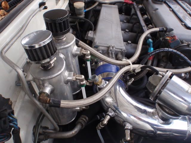

ok awesome, im going to order my parts now and get this going, now i just have one more question. my IAT sensor for SD is really close to the throttle body, do i want to have the meth nozzle before the IAT sensor or after the IAT sensor?

Here's my setup. Running twin 500cc nozzles (coolingmist IIRC) angled towards the throttle plate as Curtis suggested too. You can see my IAT is after them, but mounted up top so droplets hopefully won't accumulate on it. Has been working great for a few years now.

^ thank you very much, Justin(i want to say, not sure). your engine bay is like crazy nice and i see you have kept the A/C. nicely done.
