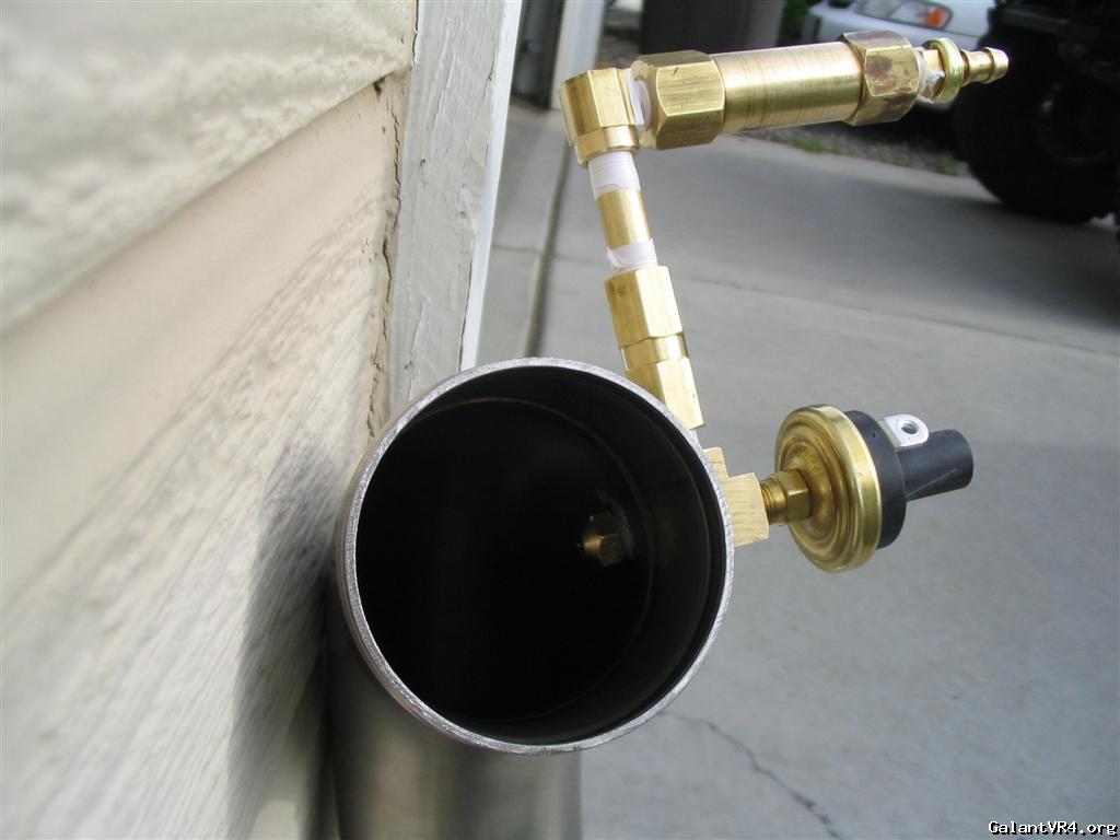

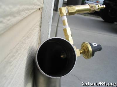

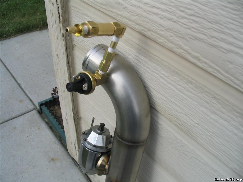

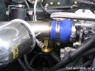

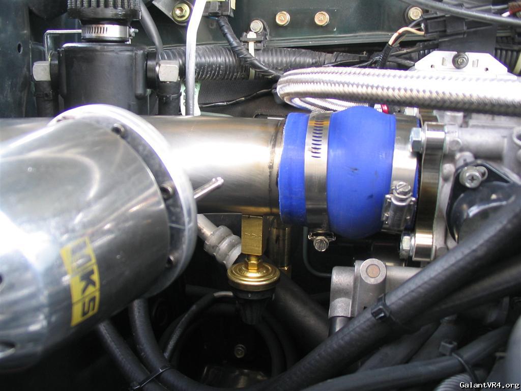

wop and emx how do you have your nozzles installed? thats the only thing im still trying to figure out before i buy the parts to set it up.
I use an M15 nozzle threaded into my UICP from the bottom a few inches from the throttle body. I have a filter right before a checkvalve that is right before the nozzle, and a Hobbs switch off a tee that will shut the system down if it doesn't see meth pressure at the nozzle. Old pics from original install back in '06ish:
