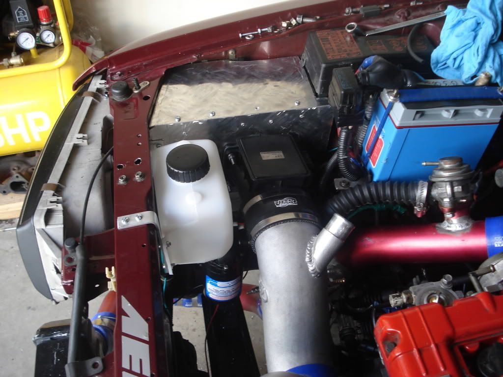

This is how I had mine setup when I still used meth injection.
It put the pump directly under the tank. Easy to fill too!

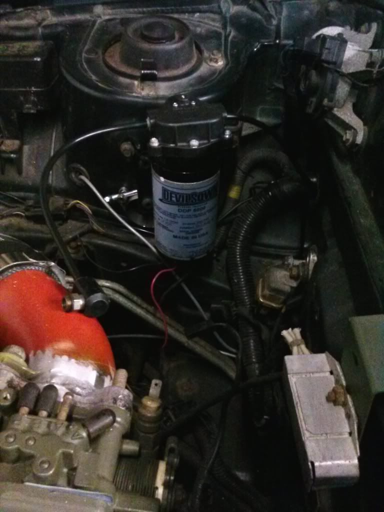

Bris your set up looks sweet, love the shrouded intake. i didn't have much room to work with as you can see from my pump feed route, but i got it done. lmk what you think.

Looks good so far!
You might want to look into the Labonte fail safe unit too.
It keeps you at wastegate boost pressure if water flow stops for any reason.
