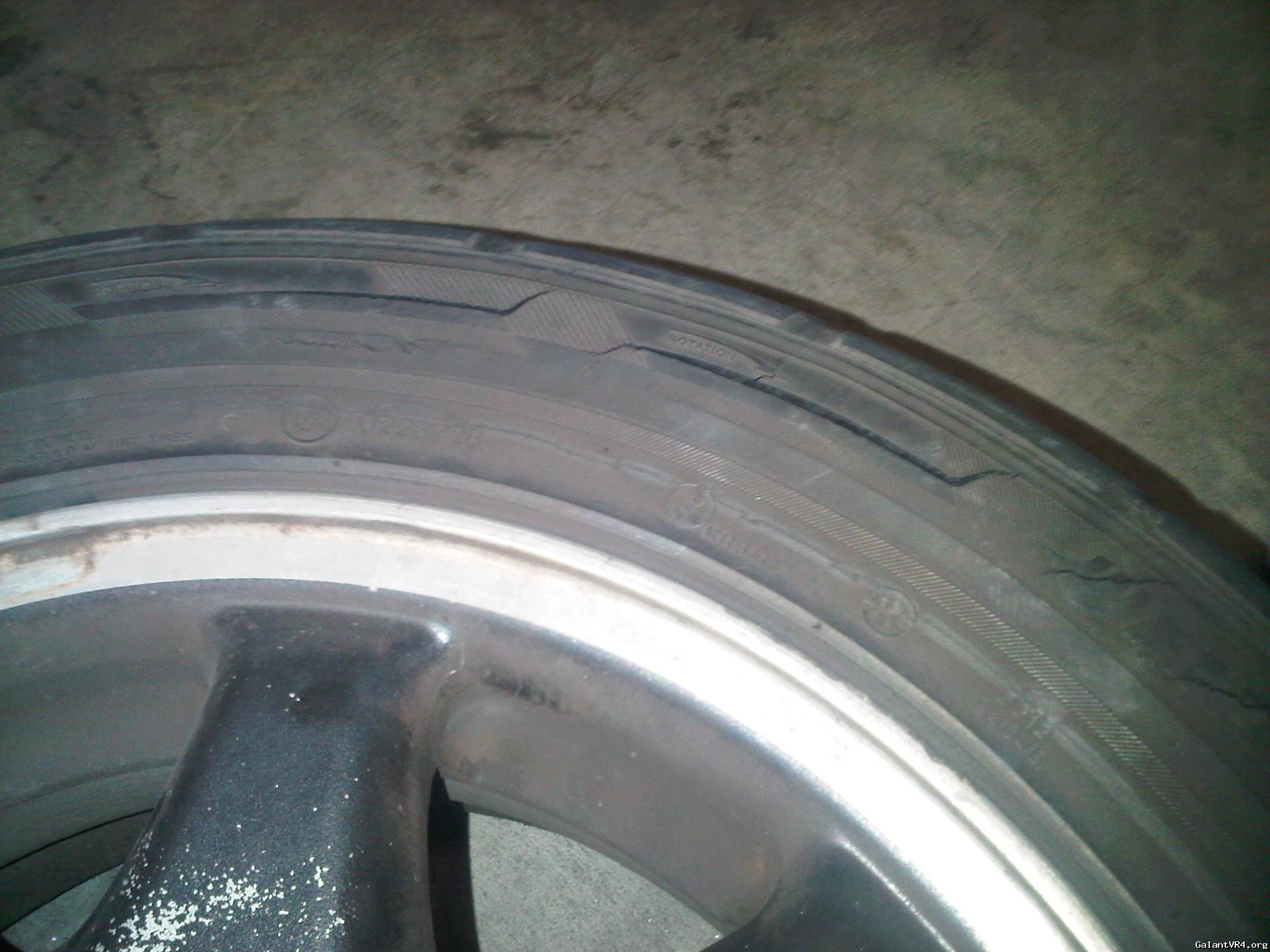

Possible developments... Looks like TOYBREAKER was right again!
Spent a couple hours test driving some new cars last night. Left the Galant parked at the Subaru dealer. (Wife likes the Forester). Got ready to leave and noticed the RF tire was very low. Upon closer inspection, the tread had begun to separate from the carcass in multiple places. With a load on the mounted wheel/tire, these slits were pushed wide open. There are a total of SIX such cracks spaced almost evenly around the tire.
Go figure.[/i]

If your wheel wobbled when you had it JSB, and changing the wheel to the other side didn't change it, then that is not your only problem.
