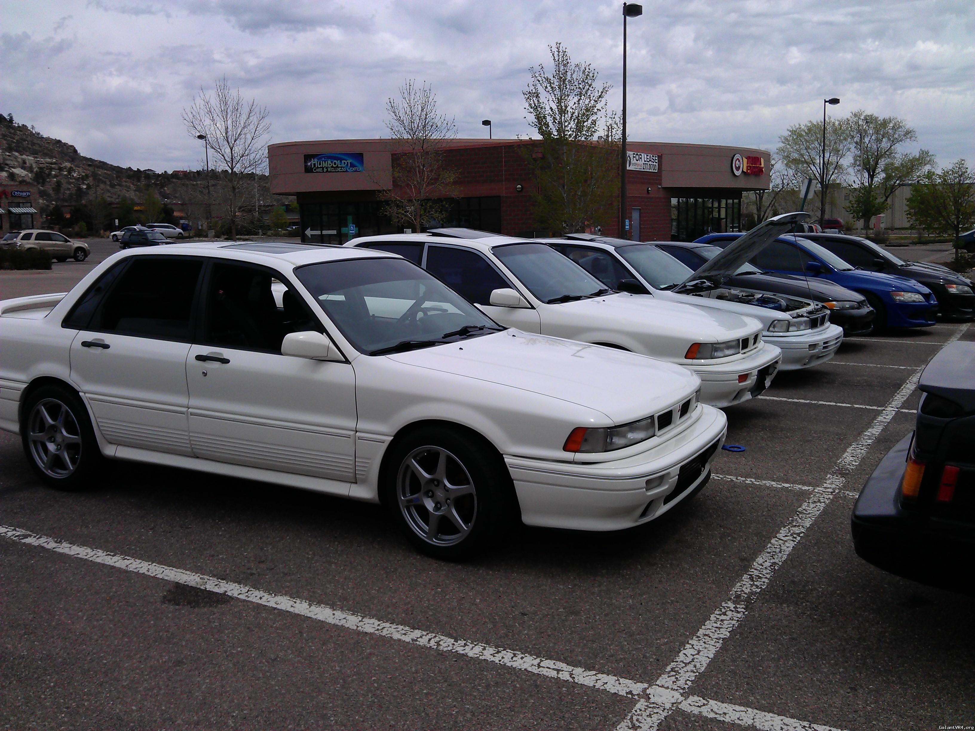

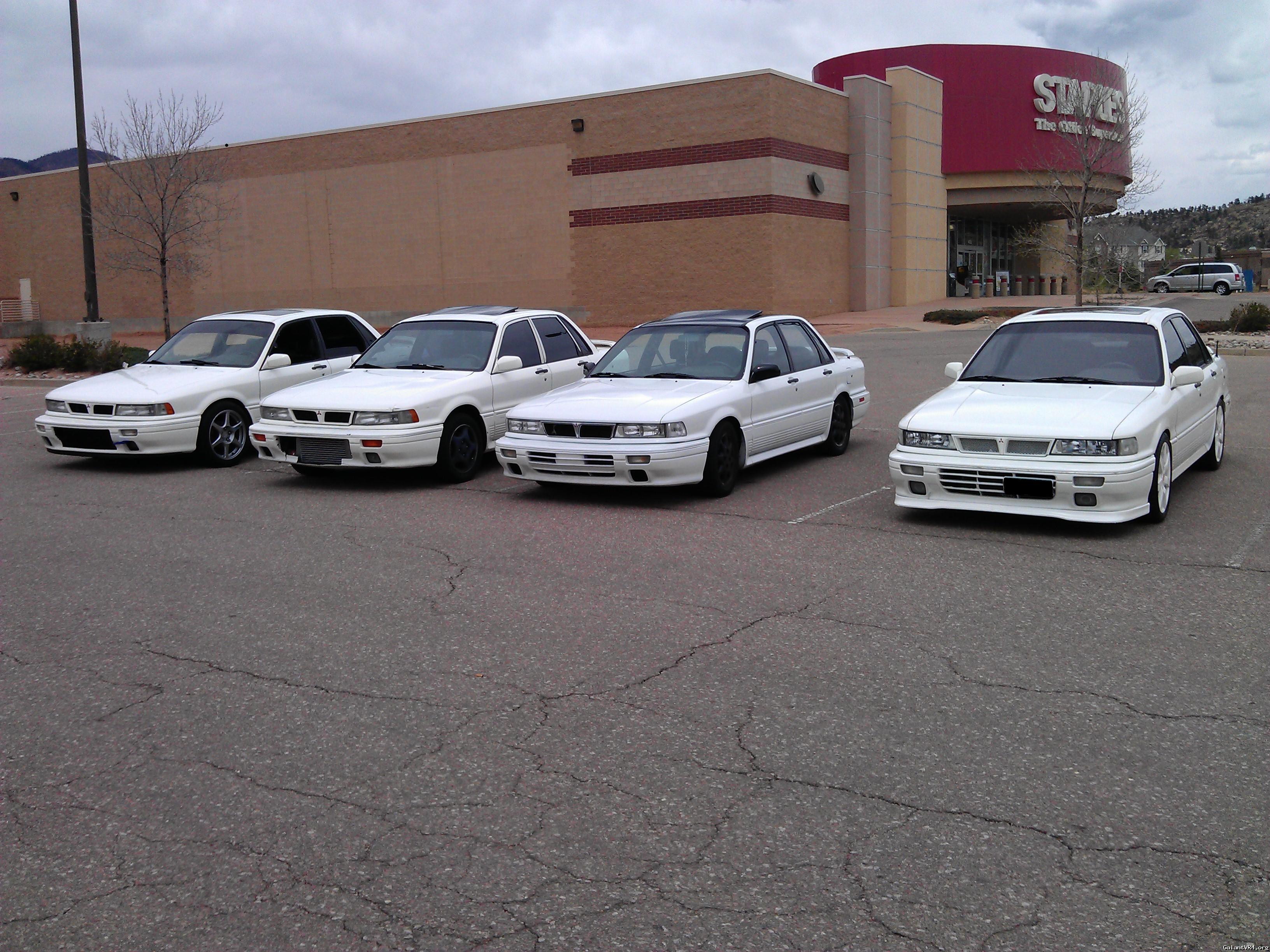

Well it was fun. Only ended up with 4 GVR4, but it was great to meet everyone and look forward to the next. I will posy some pics tonight.
