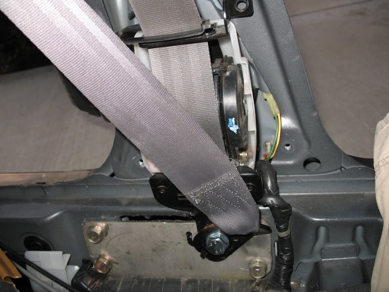

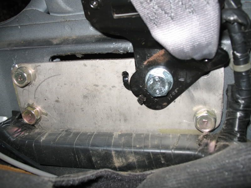

I'm surprised this question doesn't come up more often and it was a serious piece of information missing in the "How To" write up. You actually need to fabricate and anchor plate.

Hmmm...thanks!
Got any pics of how the rest of it mounts?
*Edit - sorry only the first pic loaded on the computer when I made this post.

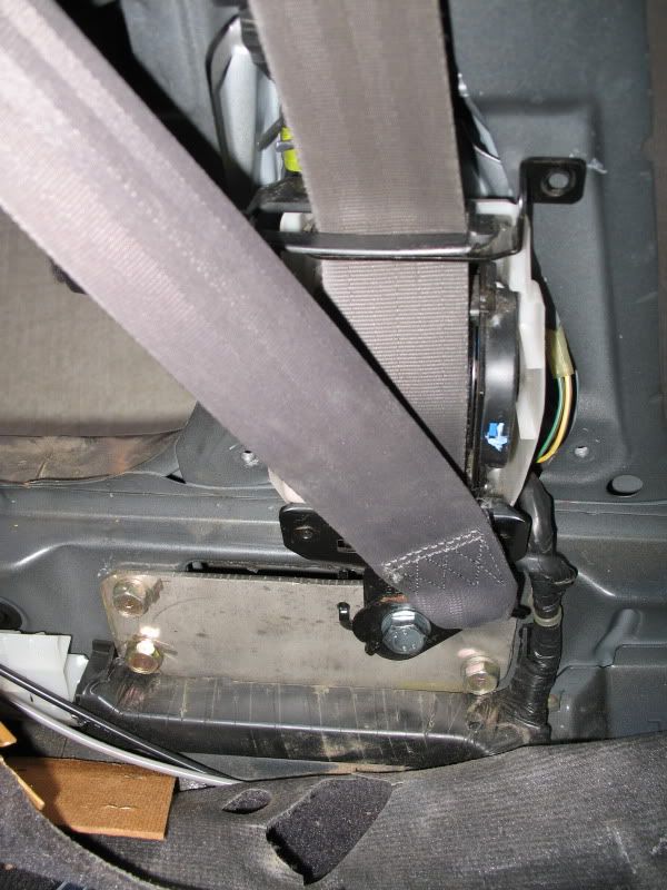

It's time to clear this up once and for all! No bracket is necessary. Below is a picture of how the lower bolt mounts up. It's important to note that this is the PASSENGERS SIDE i.e. the bolt is the top one, closest to the front of the car on both sides! Mods, please add this thread to the How-To section so others are no longer confused.

I haven't pulled a manual seat belt out of a donor car, but that doesn't look right to me SC.
I don't think the portion of the belt that goes over your lap is supposed to go through the trim like that.
That, and I can see the rationale behind the fabricated mounting plate. The original auto-real is held in by 4 bolts. But now you are going to one. Again, I've never seen what these look like in a donor car, so maybe I'm wrong. I'm just a little nervous looking at this setup considering these are for the seat belts.

It's definitely right going through the trim, how else would it go? As far as safety, I'm not sure if anybody else can snag a picture of a donor car's mounting, but I might be able to when I get back to the junkyard. As far as you are concerned with safety think about the mounting differences between the auto belts and manual. There is only one bolt for the anchor. Those four bolts you were talking about are for the retractor assembly, and therefore they are also the anchor for the lap belt. I'm only missing one or maybe two more bolts and all they do is hold the retractor assembly more securely. I really doubt that since that is not an anchor and the b-pillar metal that the retractor bolts into is paper thin, you probably aren't hurting safety too much. As far as that plate you aren't really changing the number of anchors at all, because unless that plate is significantly thicker than those mounting points it's essentially doing the exact same thing. I would like some other member to chime in on this though, and if the consensus is that my method is unsafe, I will procure some plates.
I think I have mine mounted like you do. If the lower b-pillar trim wasn't such a pain in the ass to get on I'd take some pics. Maybe I'll feel motivated tomorrow. I spent all day fixing my HVAC controls in the sun.
Even if you make a mounting plate you are eventually bolting everything on with one bolt.... You either have one bolt through the seat belt into the chassis, or one bolt through the seat belt into the bracket which then bolts to the chassis.... whats the difference? /ubbthreads/images/graemlins/dunno.gif

Bolts are extremely strong. What I worry about is the sheet metal you are putting that bolt into. If you use the fabricated plate you get the advantage of a LOT more sheet metal and body structure. That's what struck me when I first saw the pic. I could be talking out my butt on all this, but I don't remember what they are mounted like from the factory, so I'm just being cautious. Don't want my homie SC getting squished! /ubbthreads/images/graemlins/ooo.gif
Yea, i see what you mean. You get 4 times the mounting strength to the chassis. I guess it just depends on how strong those mounts in the chassis are.
I know for sure that many cars have their seat belts mounted to the chassis at one place, ( I worked at a body shop for a while) but thats not to say its safe to do that on all cars. The bolt holes on the chassis there may be designed to where you need all of them. Tough call. I guess wait and see if you can get that picture....
