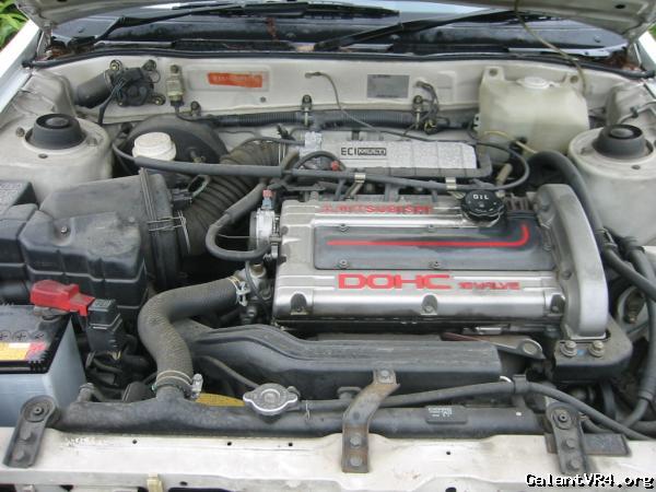

cheekychimp
Apr 19, 2004
7,333
East Sussex, U.K.
$650-USD but the shipping would kill it for you!!!
Just joking, upon closer inspection, I think it is only an 1800 anyway but the routing looks like it could be done fairly easily as you stated.
