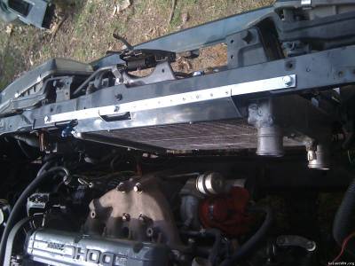

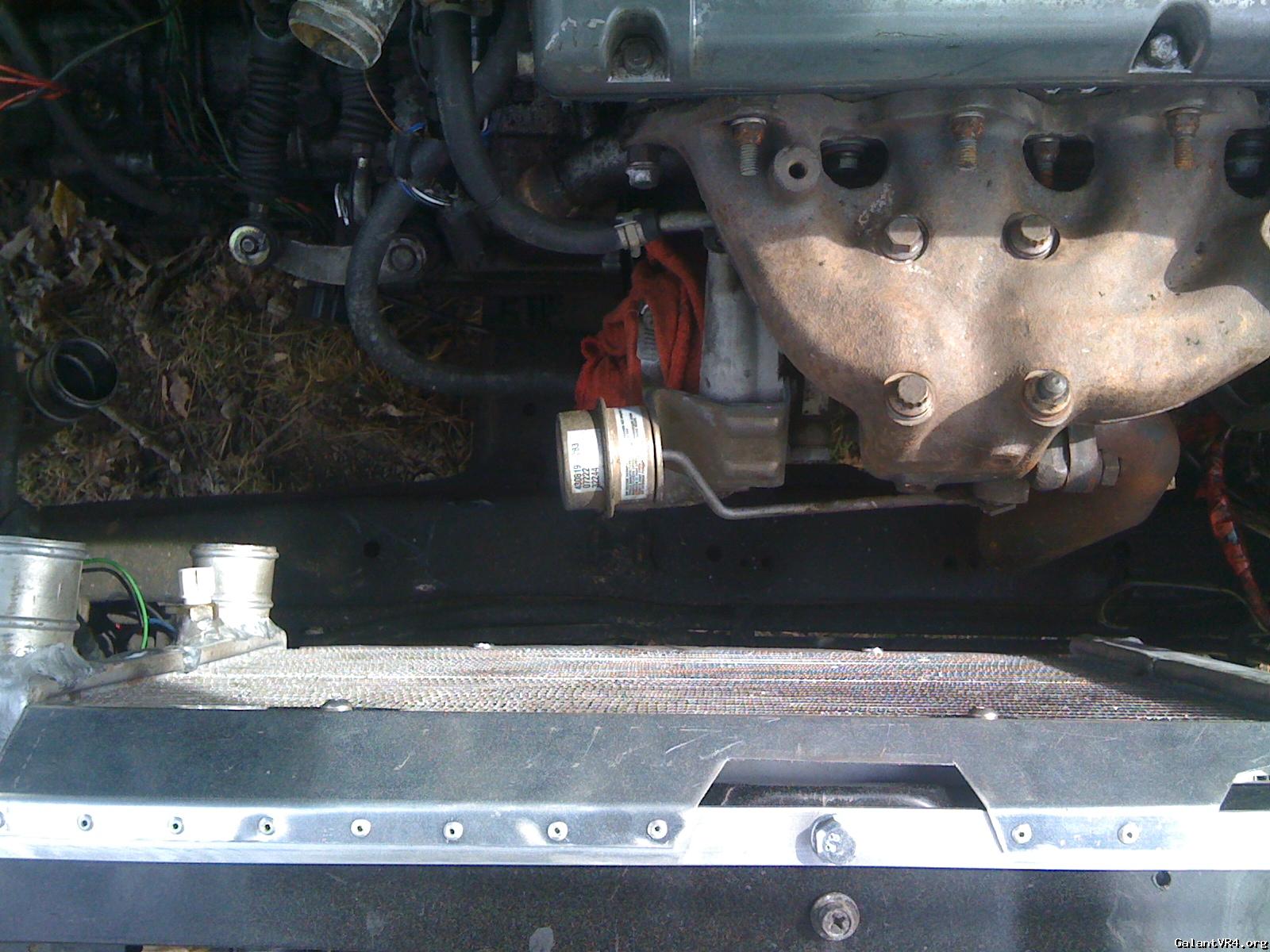

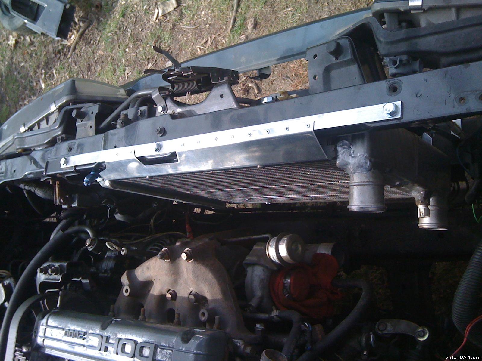

A) Why is the engine bay side of the radiator covered with a piece of sheet metal? Is that to protect it when you are working in the engine bay?
B) Are the pusher fans as far away from the radiator as I think they are? It looks like they are almost 2" away from the actual radiator. Are you going to put the A/C condenser back in to take up that space?
sorry for the confusion, i took the pics as i was test fitting everything. the plate on the back of the radiator was there to install a pull fan if i wanted to. I would have just need to cut an opening if i were to use it.i left it in place for the moment as to not damage the radiator as i was moving it quite a bit to get everything in place.
yeah they were about two inches from the radiator at first. but after removing the plate i moved the mounting bracket to the rear and this pushed the radiator further forward, so now the radiator sits just behind the fans. no i have no future plans to reinstall the AC.
Here are some better pics after i got everything mounted the way i wanted it.

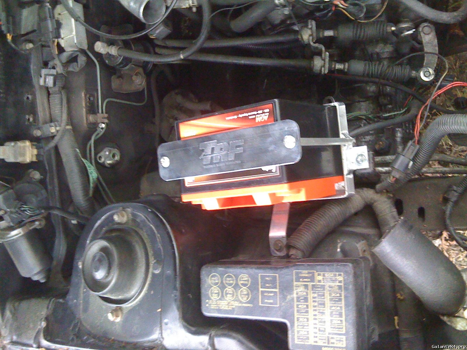

This came in the mail today! Now to fix the battery cables and get new terminals. Hopefully be able to have 192 running by the end of this week. Might leave the battery facing that direction or flip it the other way.
Boostdtalon
Oct 15, 2009
913
Buckley, Wa.
Well the urge hit me and I couldn't wait. ran out to advance and was able to pile together the cables I needed. Hooked everything up and was nervous as hell. But electrical system checked out fine, so now its time to button up all the other little things and she will be off the JSB list very soon!
