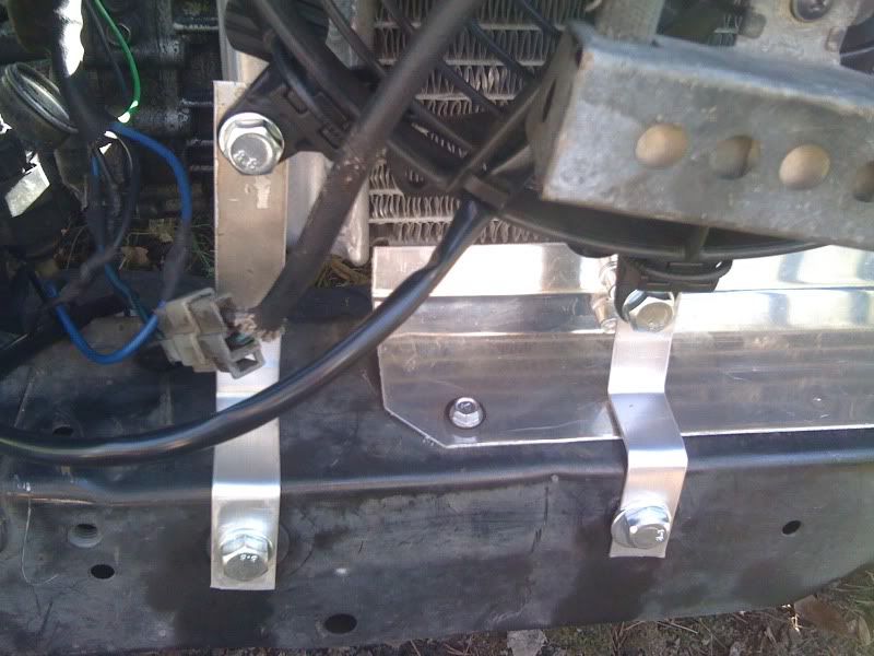

got the radiator installed today. still got a few things to fab up and to put in. but everything is coming along. Had a good amount of wiring to fix since so much it had been hacked up by the PO.
Boostdtalon
Oct 15, 2009
913
Buckley, Wa.
well first i need to thank Curtis for all his advice and help! After talking with him since he was the one that made the brackets for the radiator. I moved some parts around and now the radiator sits about two inches forward, giving me even more room in the bay. I got the SPAL fan mounted with some custom brackets(after $60 worth of tools and parts). now to go browse the for sale ads as i'm in need of new positive and negative cables as mine were hacked to sh*t.

I'm a bit confused at what I'm looking at here.
A) Why is the engine bay side of the radiator covered with a piece of sheet metal? Is that to protect it when you are working in the engine bay?
B) Are the pusher fans as far away from the radiator as I think they are? It looks like they are almost 2" away from the actual radiator. Are you going to put the A/C condenser back in to take up that space?
