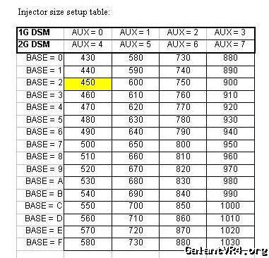

So I installed a 3"gm maf and translator on 96 until my emulator comes in ,
My setup is 750 s and a keydiver chip to compenstae with a 2 g maf,
if some one has the Same or similar setup can the please tell me what
they have there n obs set on Aux Mode Base Idle Mid Wot that way
I am in the ballpark my logger conects when it wants to so I will use my
wideband mostly,but please help,thanks /ubbthreads/images/graemlins/dunno.gif
BASE+2, AUX=4

I'm there already keydiver, just wanting to see if anyone has moved the other 3 knobs (Idle, Mid, WOT) so I can try it or just left the others alone
With a MAFT setup you can't go by anyone else's settings. You really need to get your logger working so you can see the fueltrims.
He's got a WB02, he'll be fine. I tried with a logger and that was a waste of time.

yeah i have been using the wideband to monitor it, as far as knock I have not seen any at 25 lbs anywere thruout the powerband, I just have the knock sum LED setup
keydiver burns in the chips, so who knows if I actually get knock? The wideband goes to 10.0 A/F at 10 lbs boost and stays there all the way to 25 lbs, (I am running water/alchol injection that kicks in at 12 psi) I have tryed to lean out the WOT to abot 12.3 or so at WOT but I guess its the burn keydiver puts on it, I have turned the knob all the way lean but it still doesnt change it, maybe something else?
