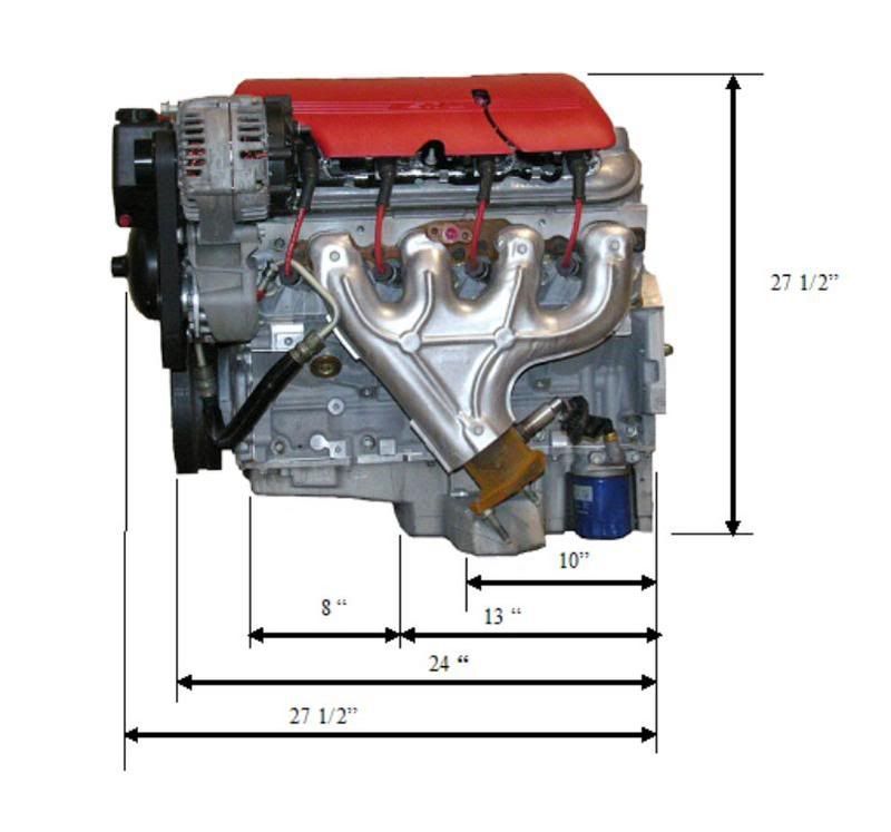

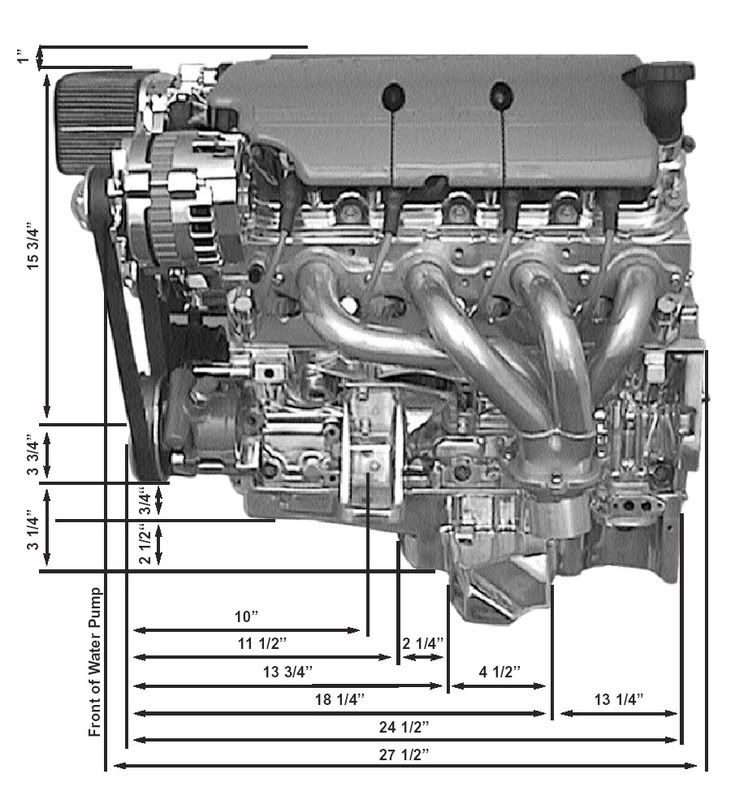

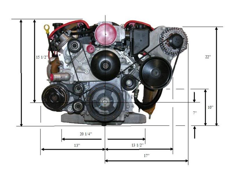

These might be of some help:
LS1 corvette
LS6
I just had a quick measure and 27.5" is about the same as the distance from the firewall to the forward most of the bolts holding the turbo to the manifold, so if you move the radiator forward under the rad support an LS would fit without having to completely butcher the firewall.

Hostyle: where did you get those pics of the measurements? Do they have measurements of the t56 or 4l60e? If so can you post a pic or link?

Oh I know, I mentioned a new tunnel would need to be made in my first post, I was merely saying you wouldn't have to box it to get the motor sitting far enough back.
pics were found here link I just googled: lsx engine measurements and that was the first link that popped up.
