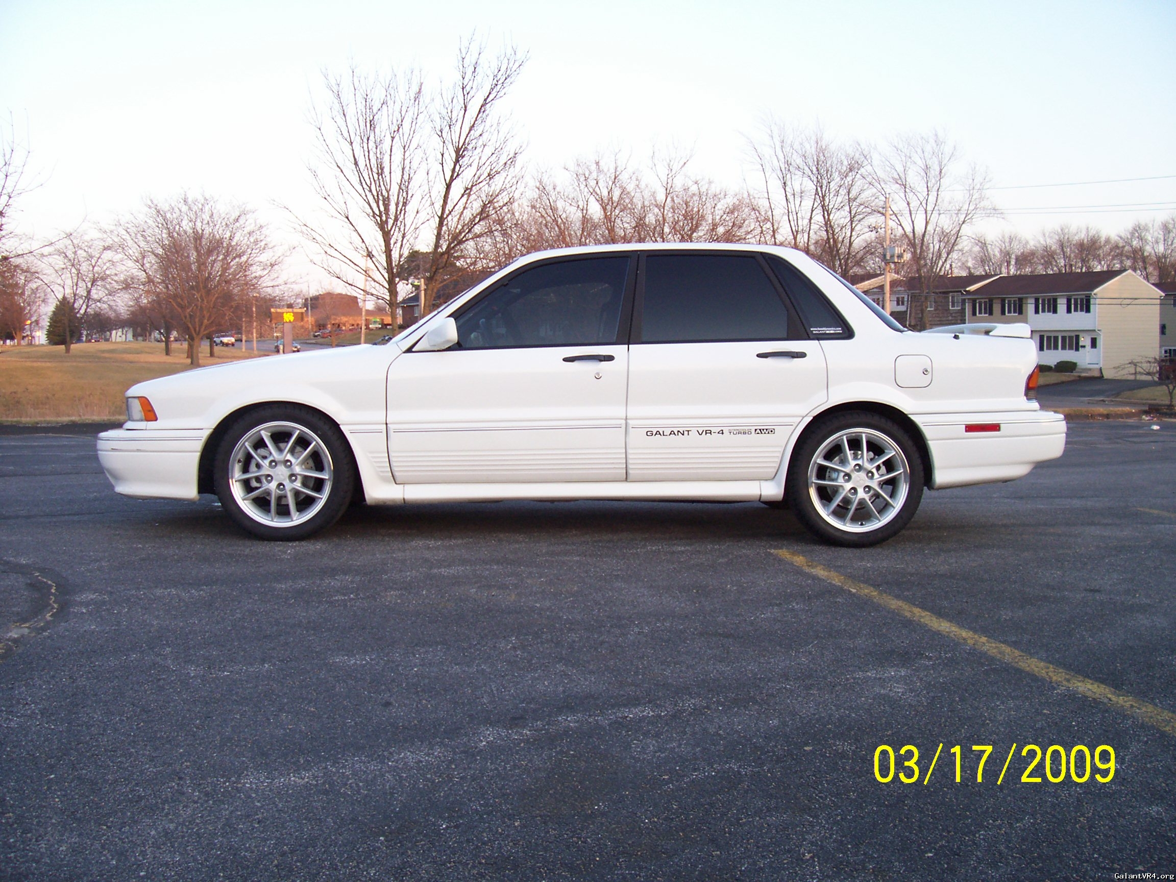

This is what your car will look like with KYB GR2 struts
The H&R "sport" springs will drop the car 1.5" all around without a single other mod.
BTW - those tires/rims are 17" with 215/45/17 rubber.
