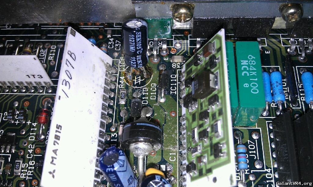

Things to check (in order of probable causes):
ECU - leaky caps

I posted on my local DSM group for a loaner ECU to test out that theory.

I picked up a known working ECU out of a 1991 Galant VR4 and will test that out tonight.

Swapping in a known good ECU didn't do anything. But my 'rebuilt' ECU looks like it's leaking caps or someone did a piss poor job of soldering...
