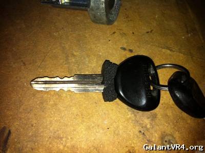

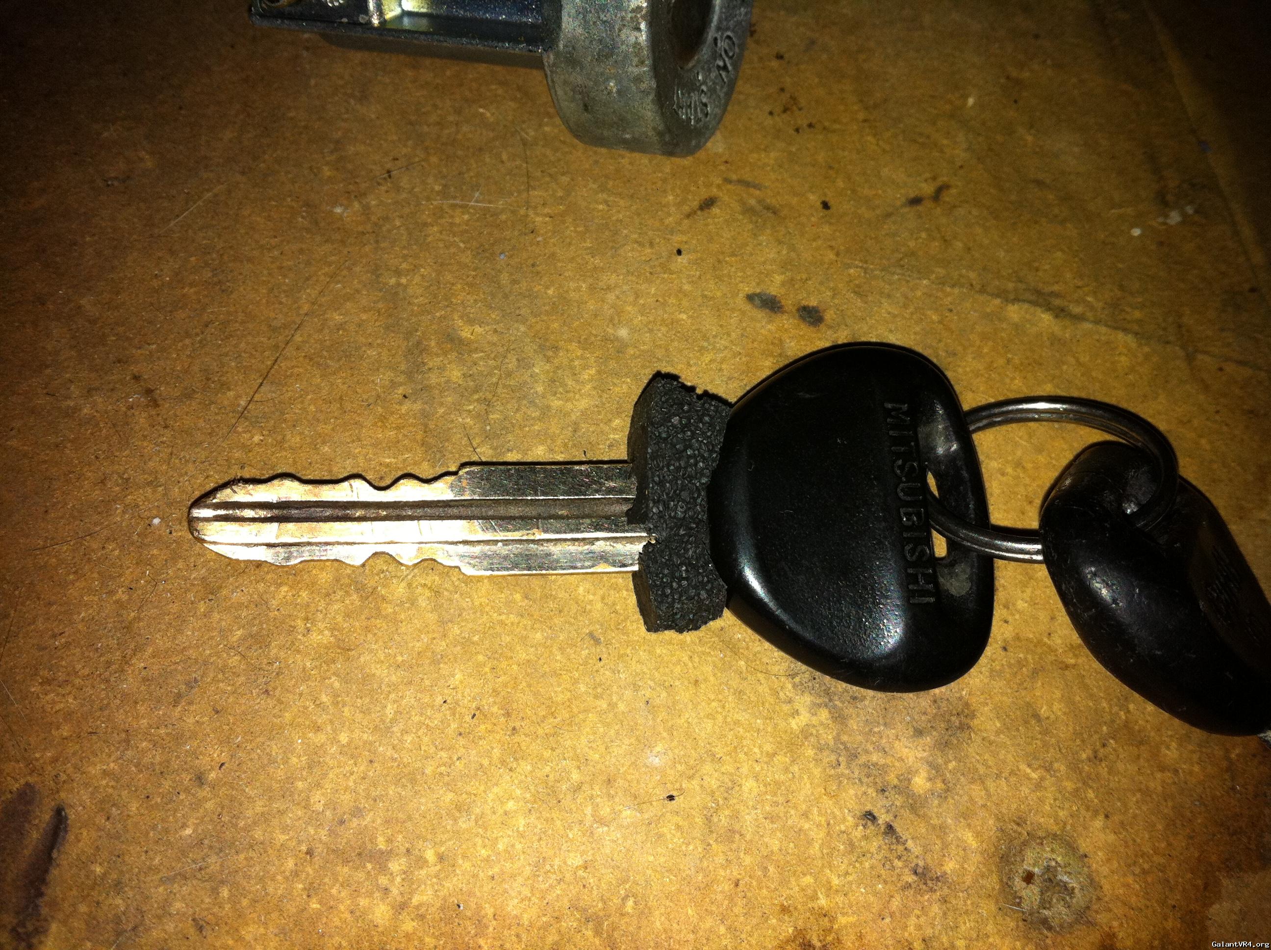

I wouldn't use that, unless you just put it up at the top 1/4" or so,, getting it onto the teeth, then having pieces get stuck in the cylinder would suck. What about just coating the key faces in something like fingernail polish. It is probably thick enough to work, and pretty hard when dry. I'll try one now and let you know. /ubbthreads/images/graemlins/wink.gif
*waiting for the polish to dry, I thought of an easier method:
This is just foam insulation, but if you used some thick rubber, cut it to fit nicely,, you would never need to remove it and it does make the key solid in the hole. /ubbthreads/images/graemlins/wink.gif

Ok I see what you are saying. Now how about not putting anything on the key maybe put like a rubber, or like a stiffer type of foam on the on the tumbler it's self and cut out the slot where the key hoes in?
14u2nV
Jul 22, 2004
9,399
Agency/St. Joe, MO
I tried one of the injector orings, and it fits tight, and looks good. It's just a little to small to reach though. The foam looks bad, but if you used something like a thick washer or such, you could make it look good.
