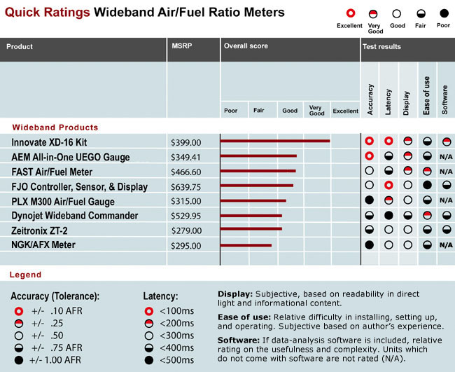

Run a search on google for "wideband shootout" for more details but this was the bottom line. I have the AEM.

Here is a more updated shootout
"For the price, this meter went toe-to-toe with the NTK and Motec. One of the best traits we found on this meter was the fact it can display EGT, RPM, TPS, Boost, Vacuum along with on five-volt reference all at one time. While we didn't get to test the optional inputs, the mere fact it is capable of logging these inputs at this price is incredible. Some of the features are additional options that must be purchased separately. Based on price this meter is the best bang for your buck".
Quoting Scientist:
this was published by Import Tuner July 2004
Then yours is actually the outdated one. This is the thread from which Adrian got the picture and was talking about.
And I would take any information the ford muscle magazine did in 07 over what import tuners did in 04.
(No Offense)

The ford muscle one data is kind of skewed, since they used the Innovate software to run all the widebands instead of their respective software. In some cases they gave widebands that came with no software points for software. And ontop of that the event was sponsored by innovate
Quoting Scientist:
Where do you see this information at? I didn't see anywhere where it says it sponsored by innovate(however the magazine is sponsored by innovate it doesn't say the test is). Also where do you see they gave points to the units that came with no software software points? Next to all the ones that came with no software it says N/A.
Maybe I'm just missing something.
