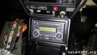

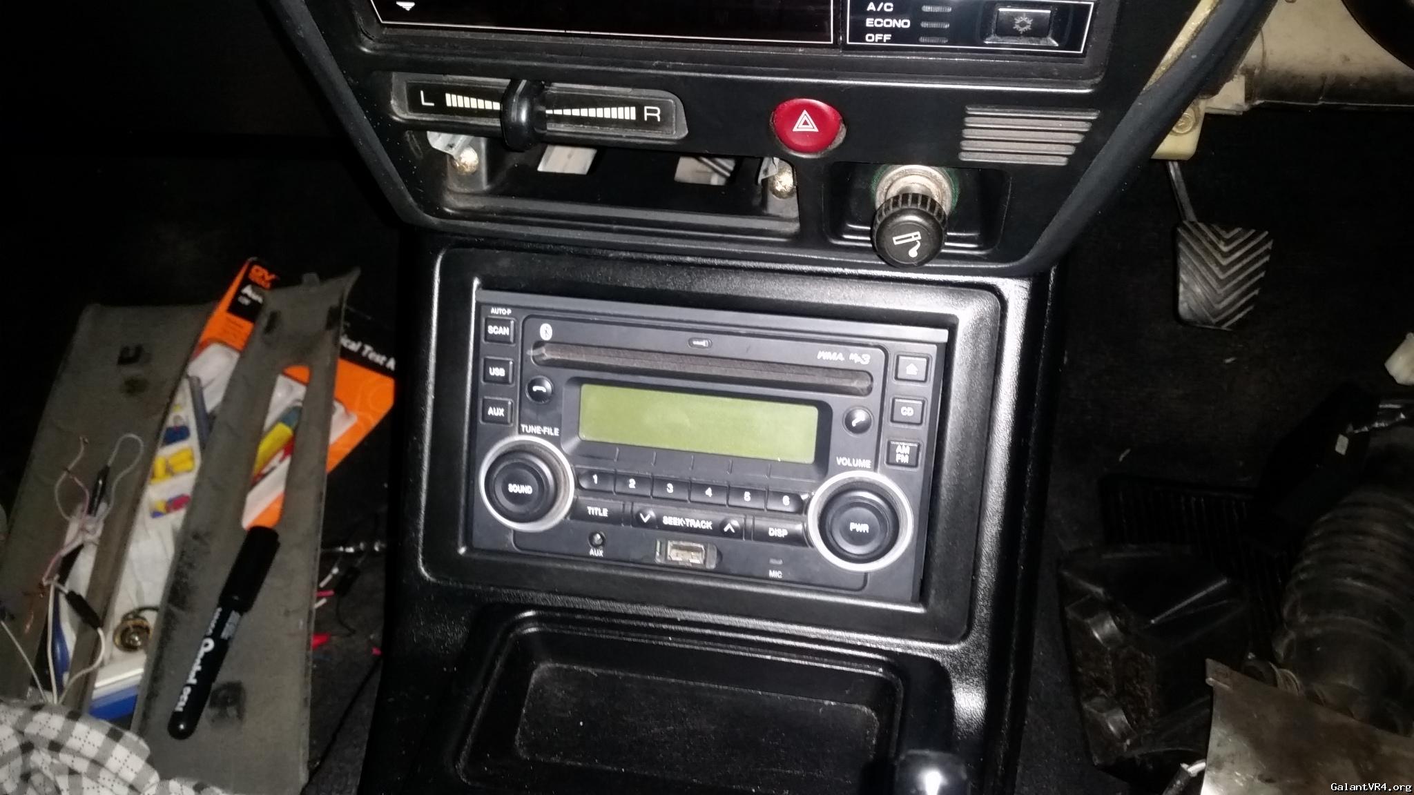

fitted this yesterday,
factory Mitsubishi with all the modern tech. USB AUX Bluetooth etc. and doesn't look out of place in the car
Dasith
Mar 18, 2010
98
Melbourne, Australia
Most Mitsubishi's from 2009 /2010 onwards. mine is from a 2010 Colt,
but the same unit comes in 2014 Mitsubishi Tritons as well.
also the same unit is on 2014 Toyota Hiace vans/ Nissan Patrols.
the Unit is made by Fujitsu-Ten, but comes with many japanese manufacturers from factory with the suitable patch loom..
Ebay bit expensive to buy it online but i got mine from a wrecker for $50. so look in your local wrecking yards.
