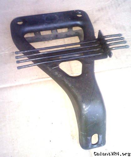

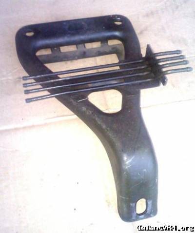

Don't pry on the gears, just keep wiggling it back and forth, remember there are 10 head bolts. Also if your intake is still attached there is a bracket on the back that needs to be removed, it supports the intake from below. I've forgotten about that before.
