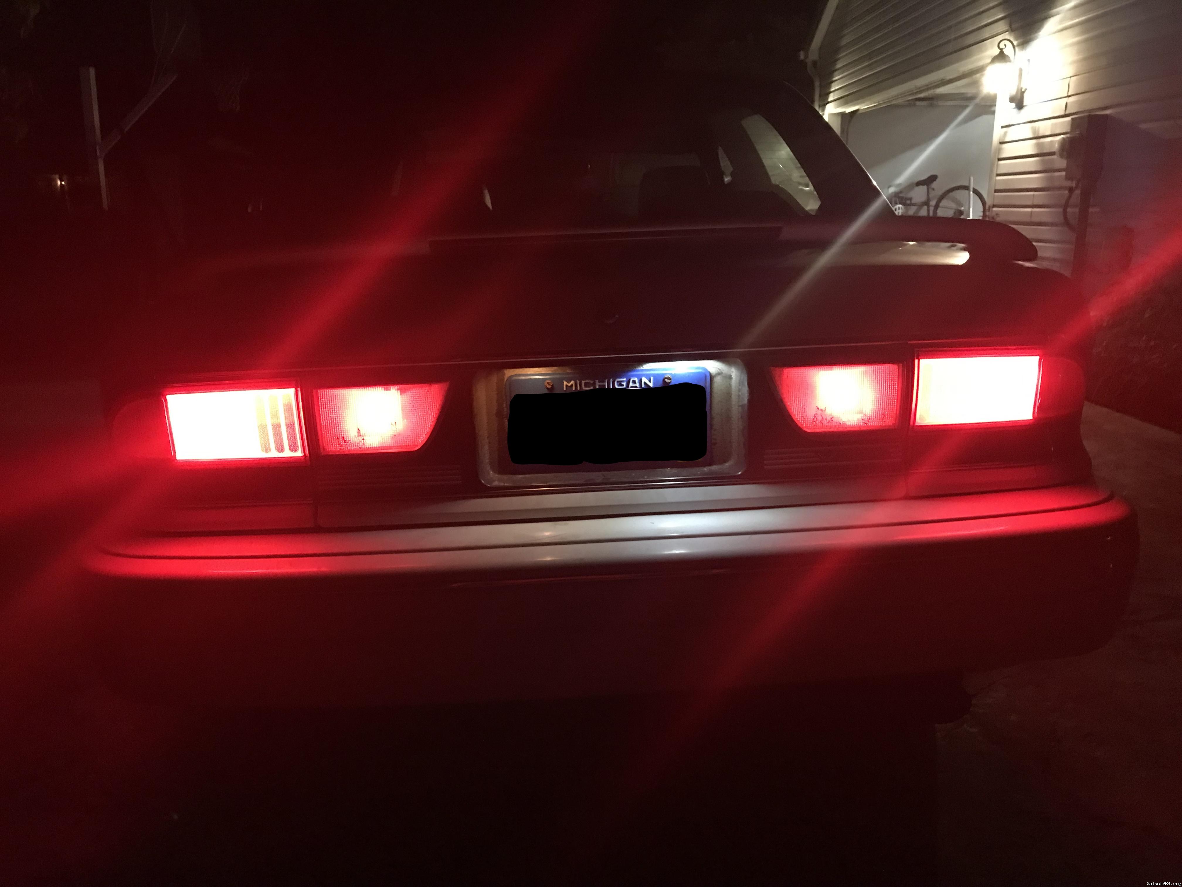

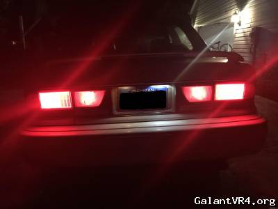

In case anyone wants to see, here are the outers in those LEDs vs the inners in incandescent:
1 white 194 LED in the right license bulb spot for comparison of those, too.
