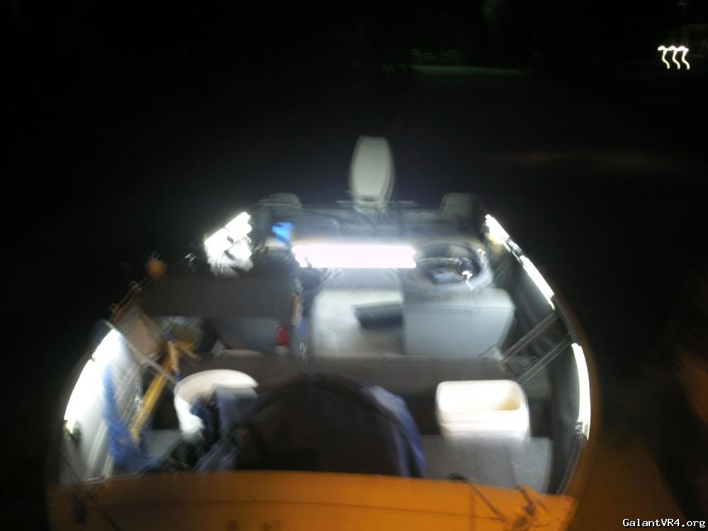

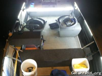

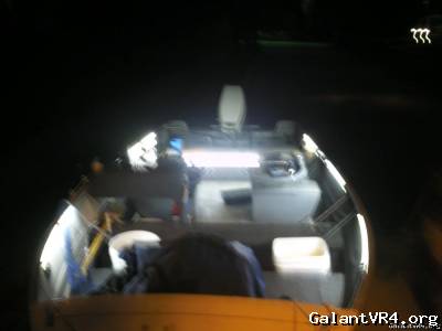

I've seen the ones at Harbor freight for fairly cheap but you don't get much...But If you know how to solder, I recommend buying a 16ft strip and go to town with it. I recently did my boat and spend roughly $70. It came in a 16ft roll, dimmer and waterproof. The pics doesn't do it justice as it is super bright. Flashlights are not even allowed in the vessel no more.... /ubbthreads/images/graemlins/grin.gif

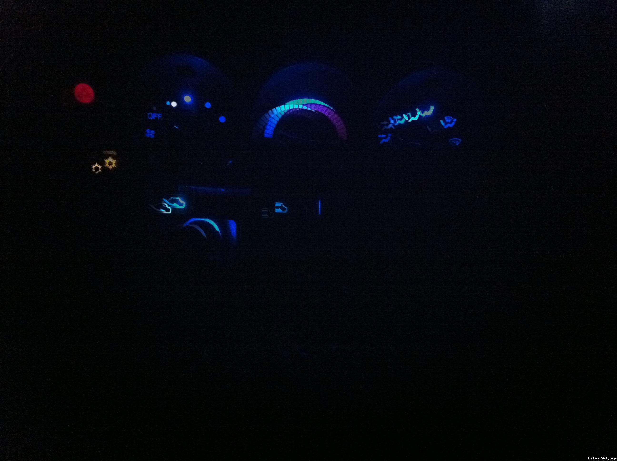

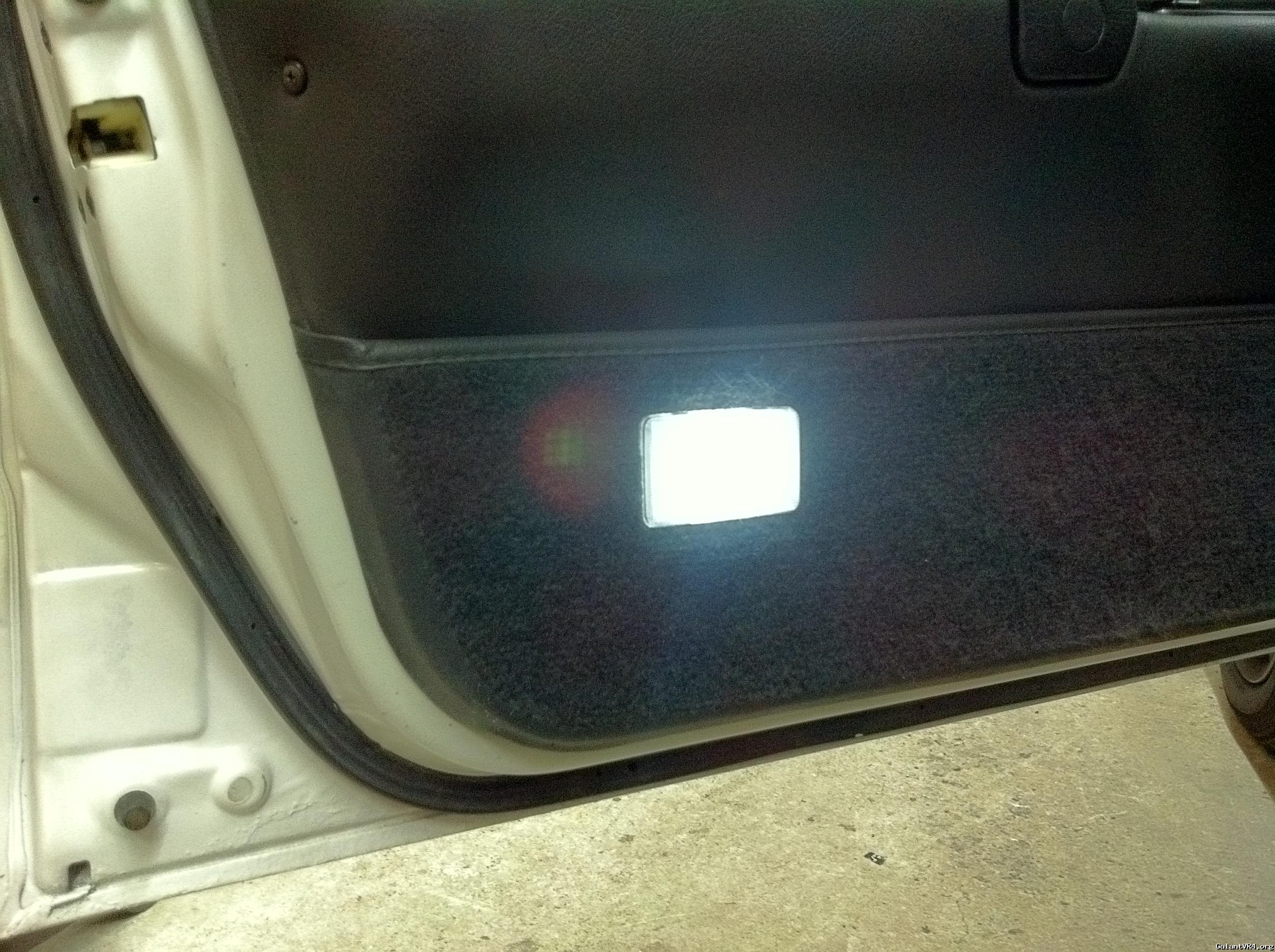

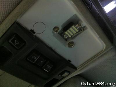

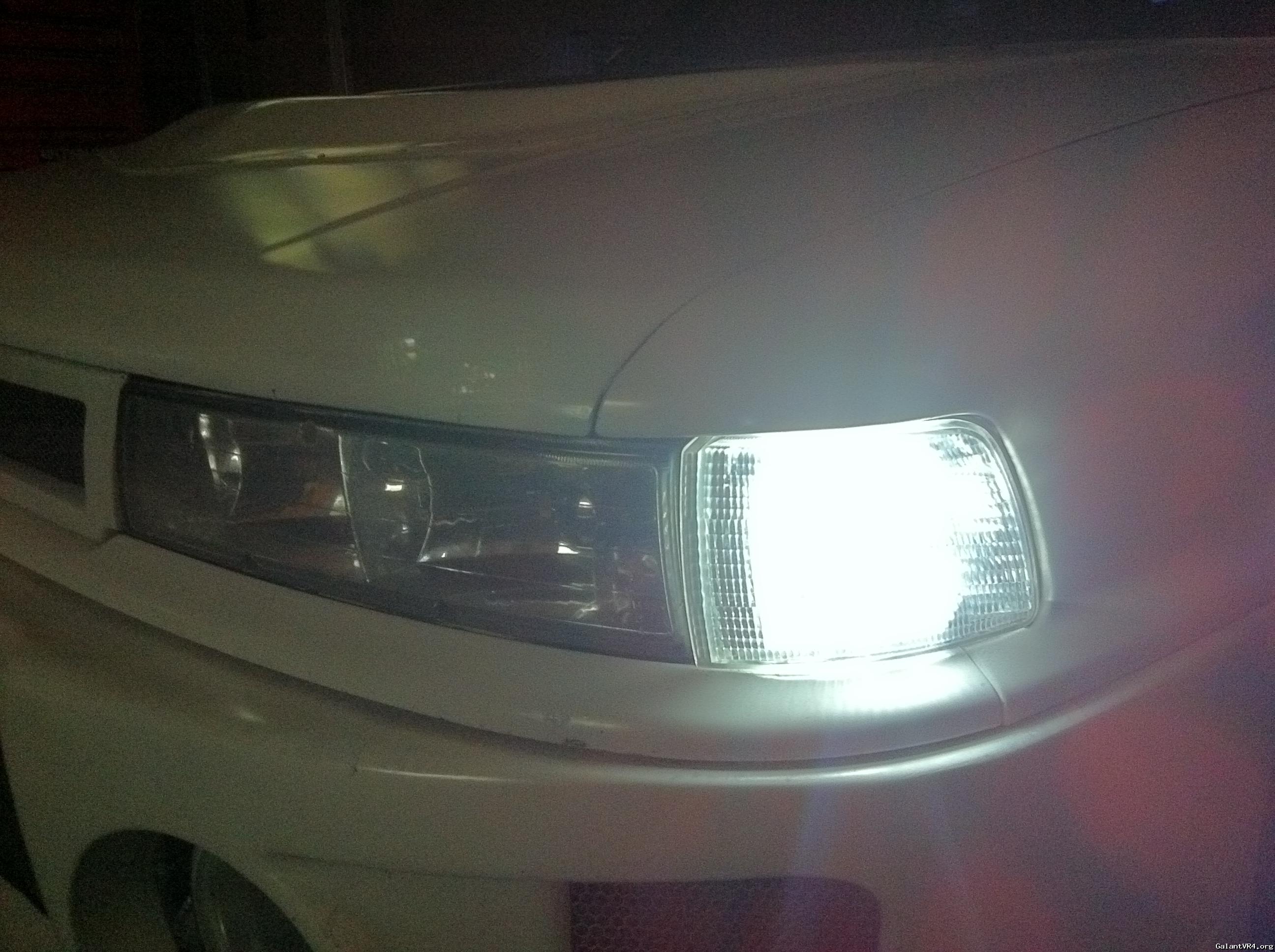

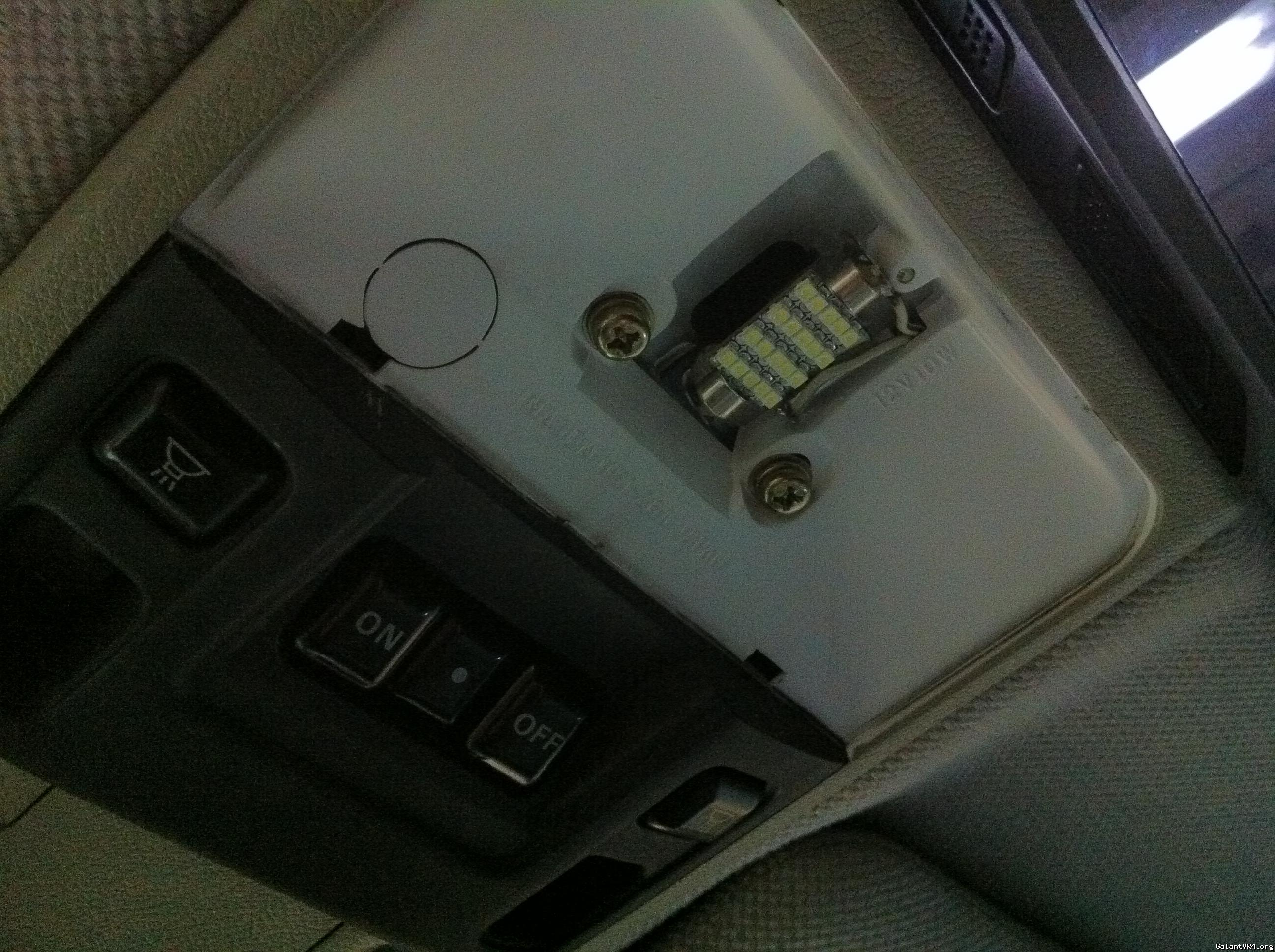

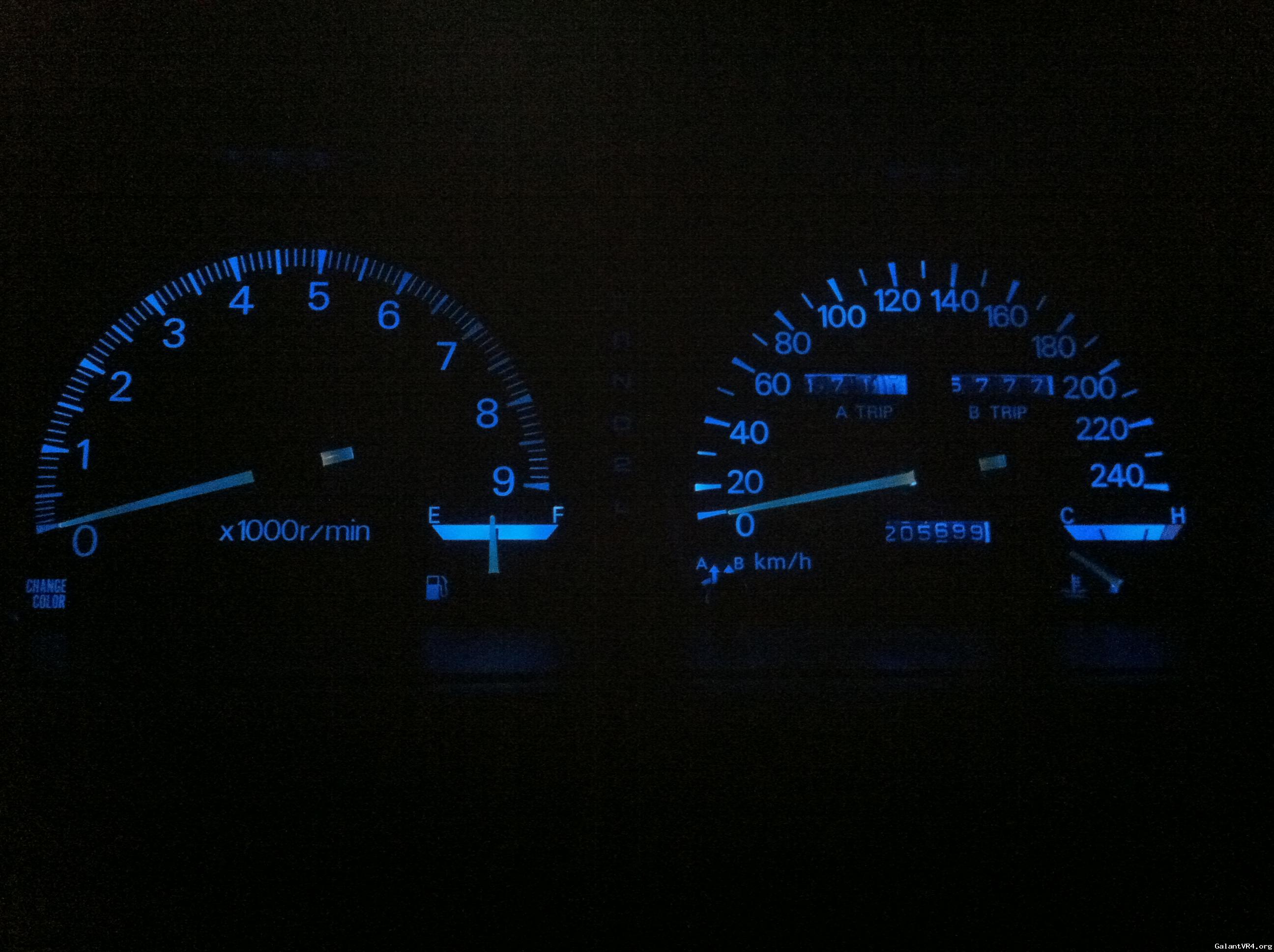

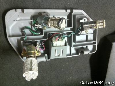

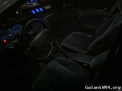

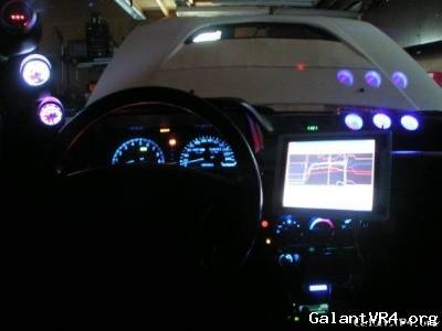

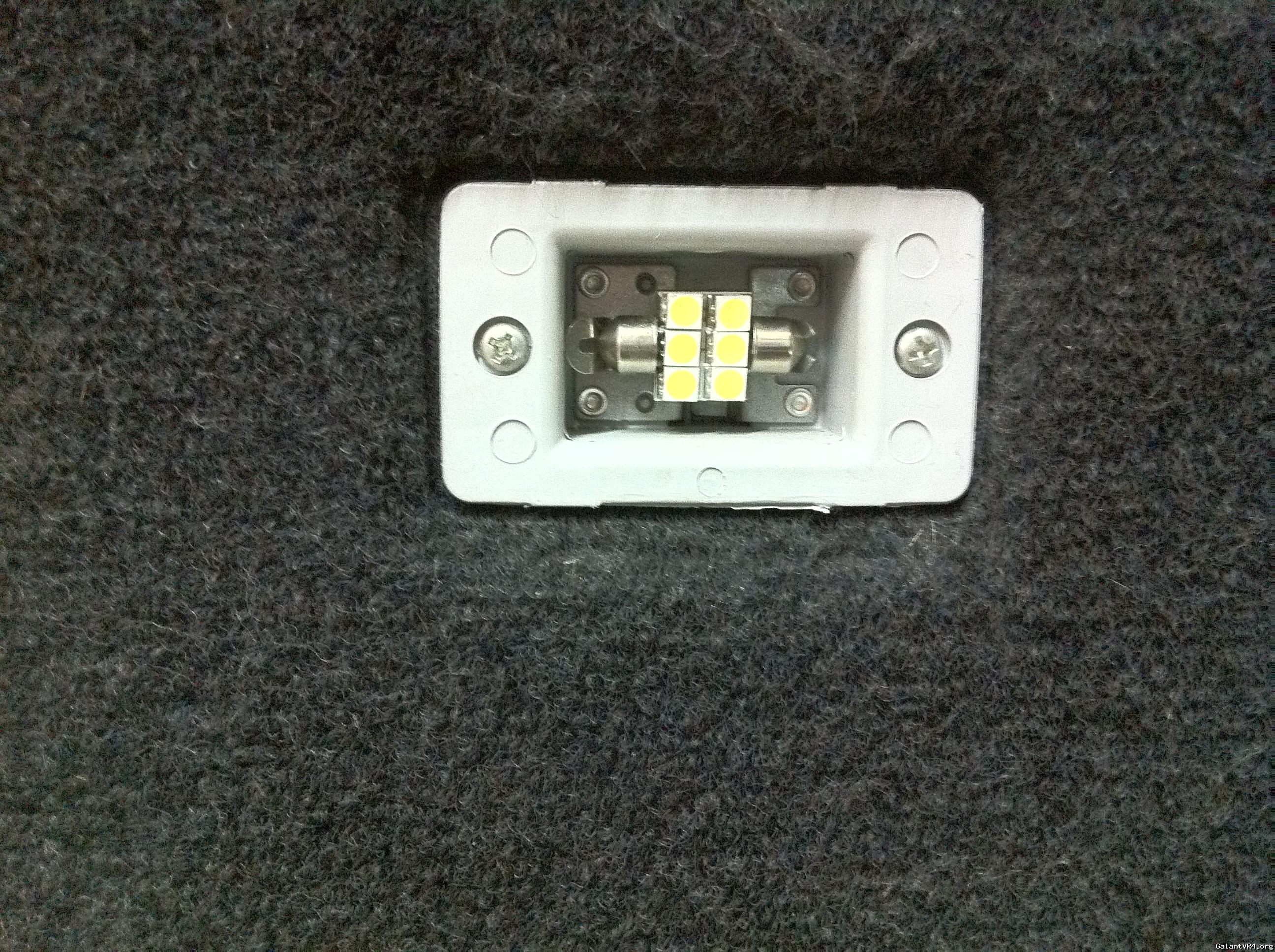

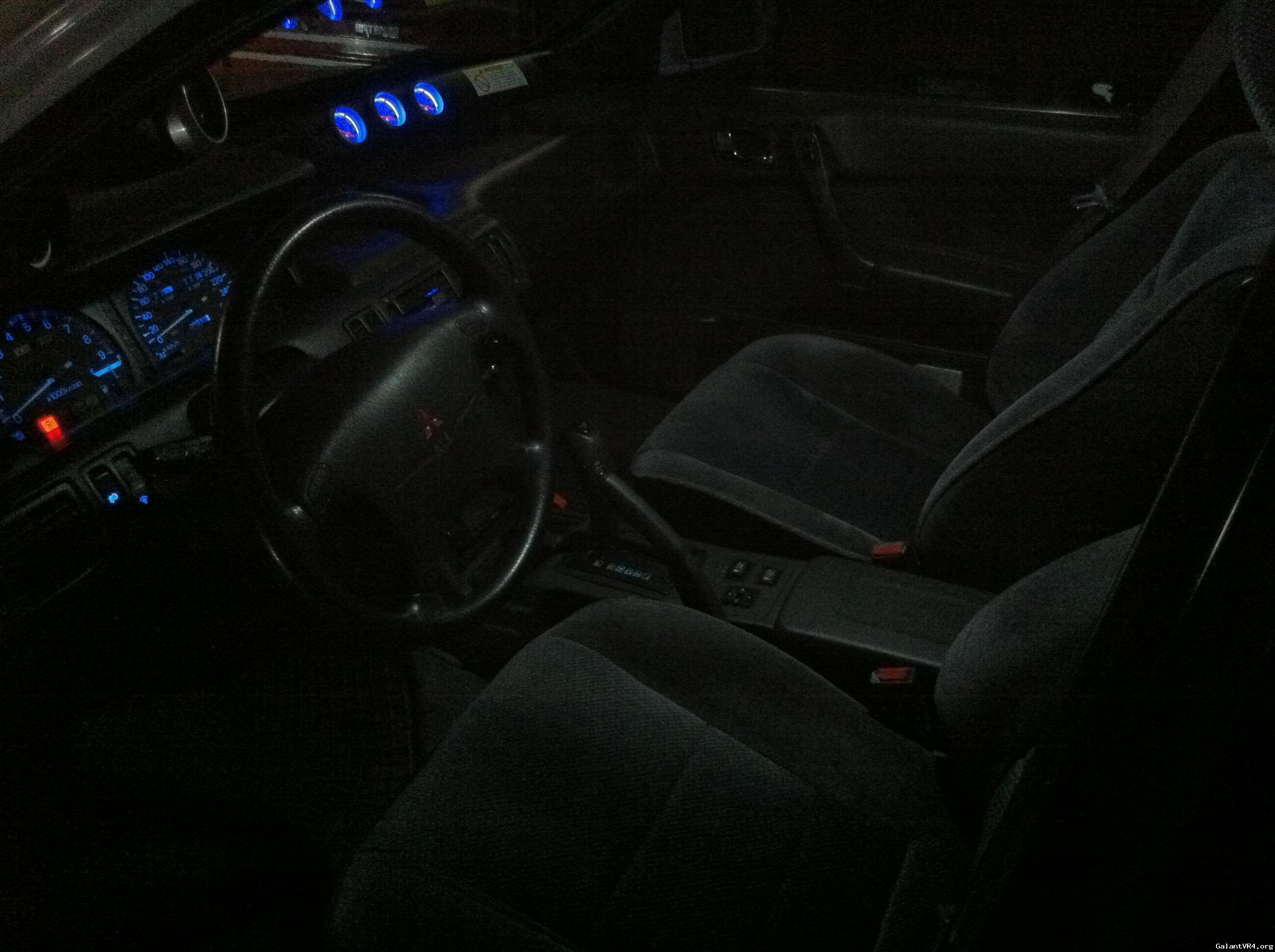

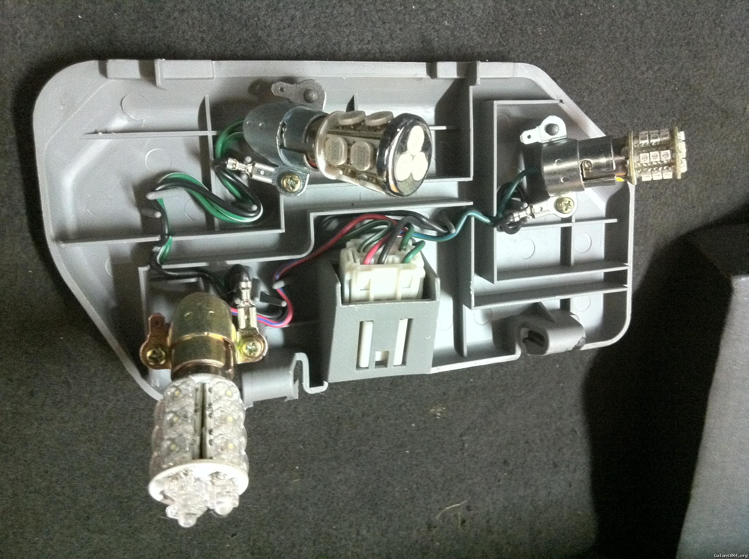

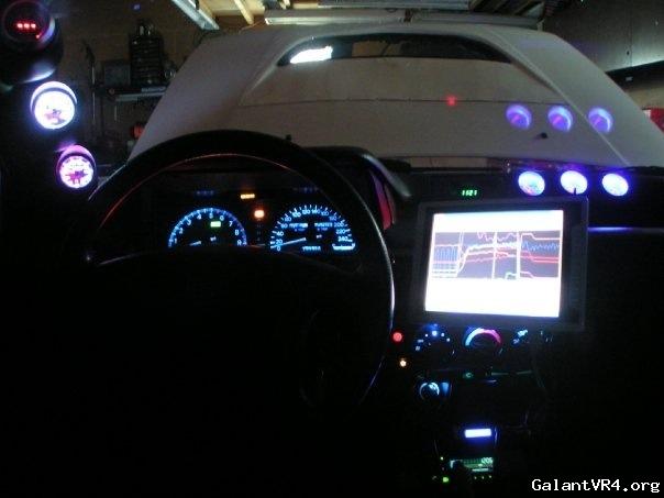

I can`t find it, but here is the result and bulb I used.

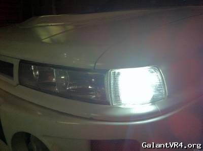

I use LED FOR Everything exept Headlight, I order 9005 LED for headlight, but it only for Show, it is dangerous to use them on road.

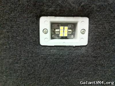

Door LED

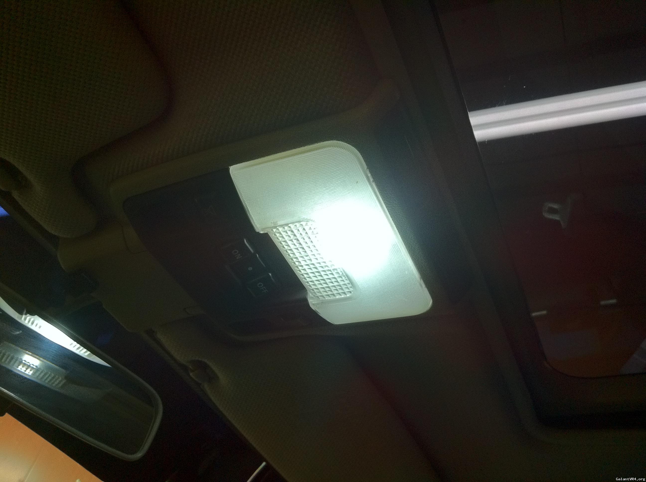

Roof LED
Interior at total darkness with LED roof on

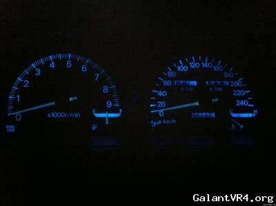

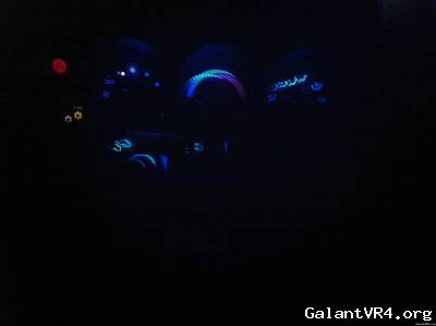

Cluster
Climate control

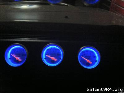

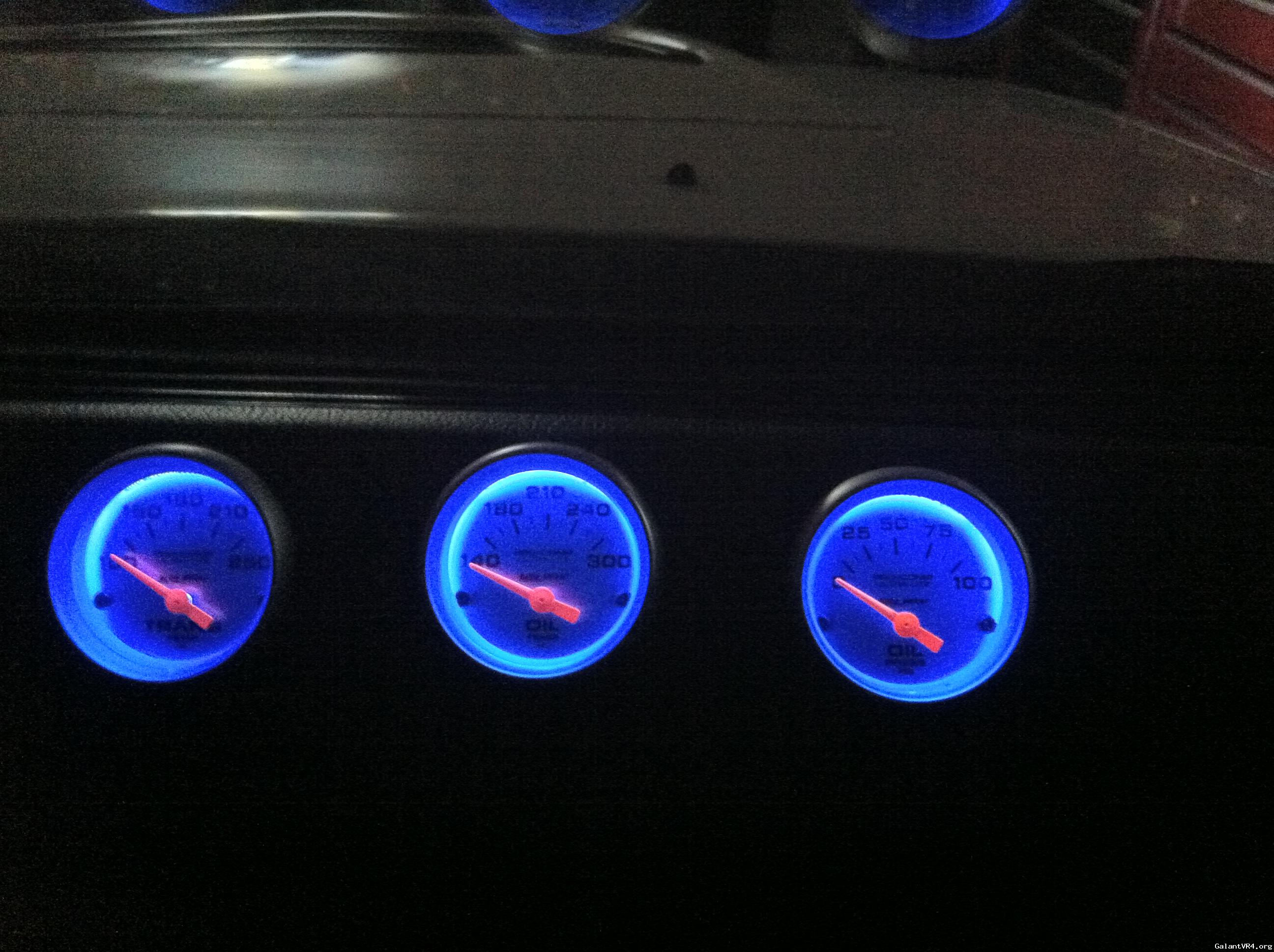

Autometer with LED retrofit

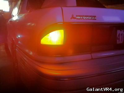

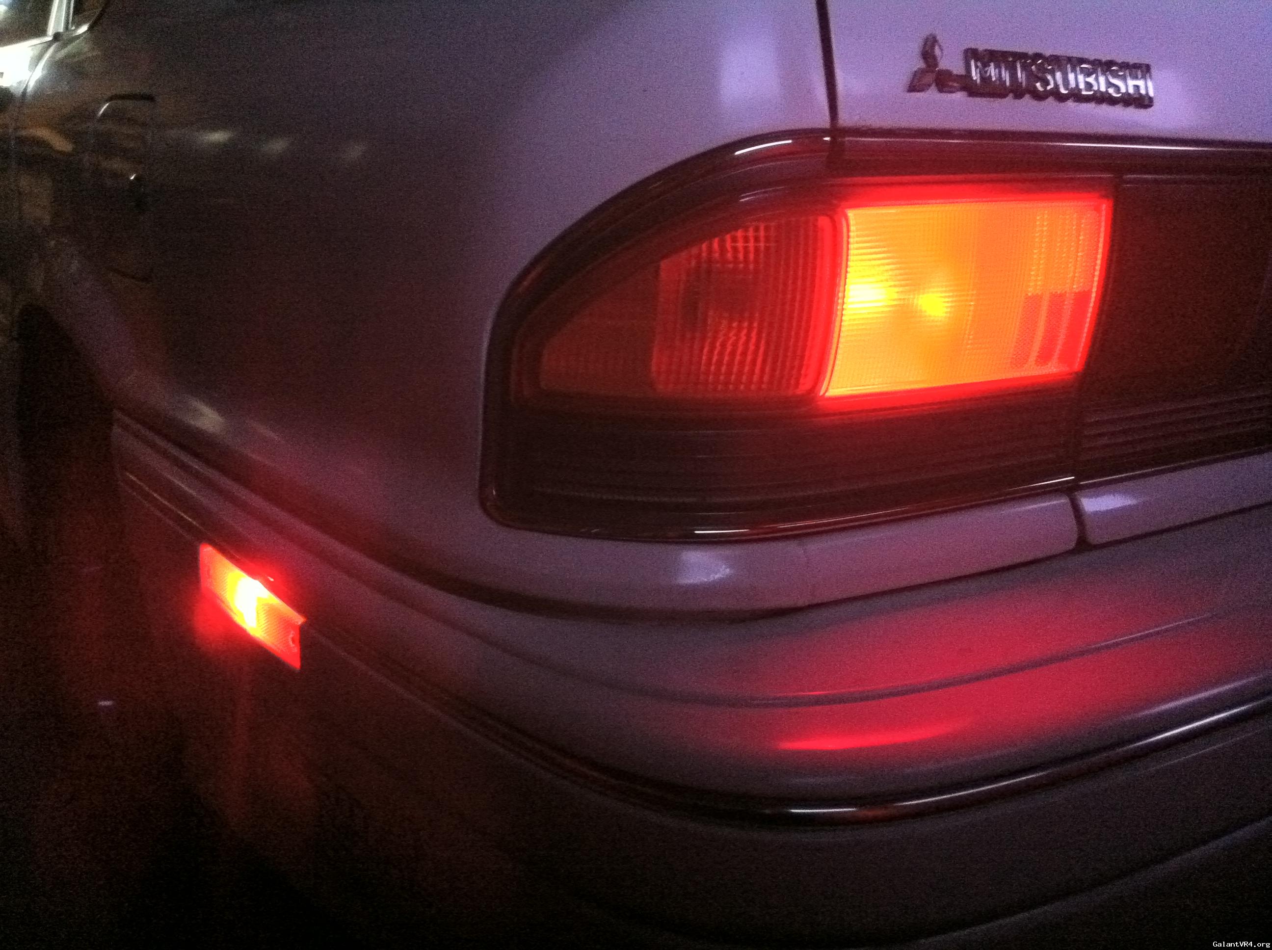

Corner light
Parking and stop light
V-LEDS.com LED I use for Parking light, Corner light, Cluster, AUtometer gauge and climate control

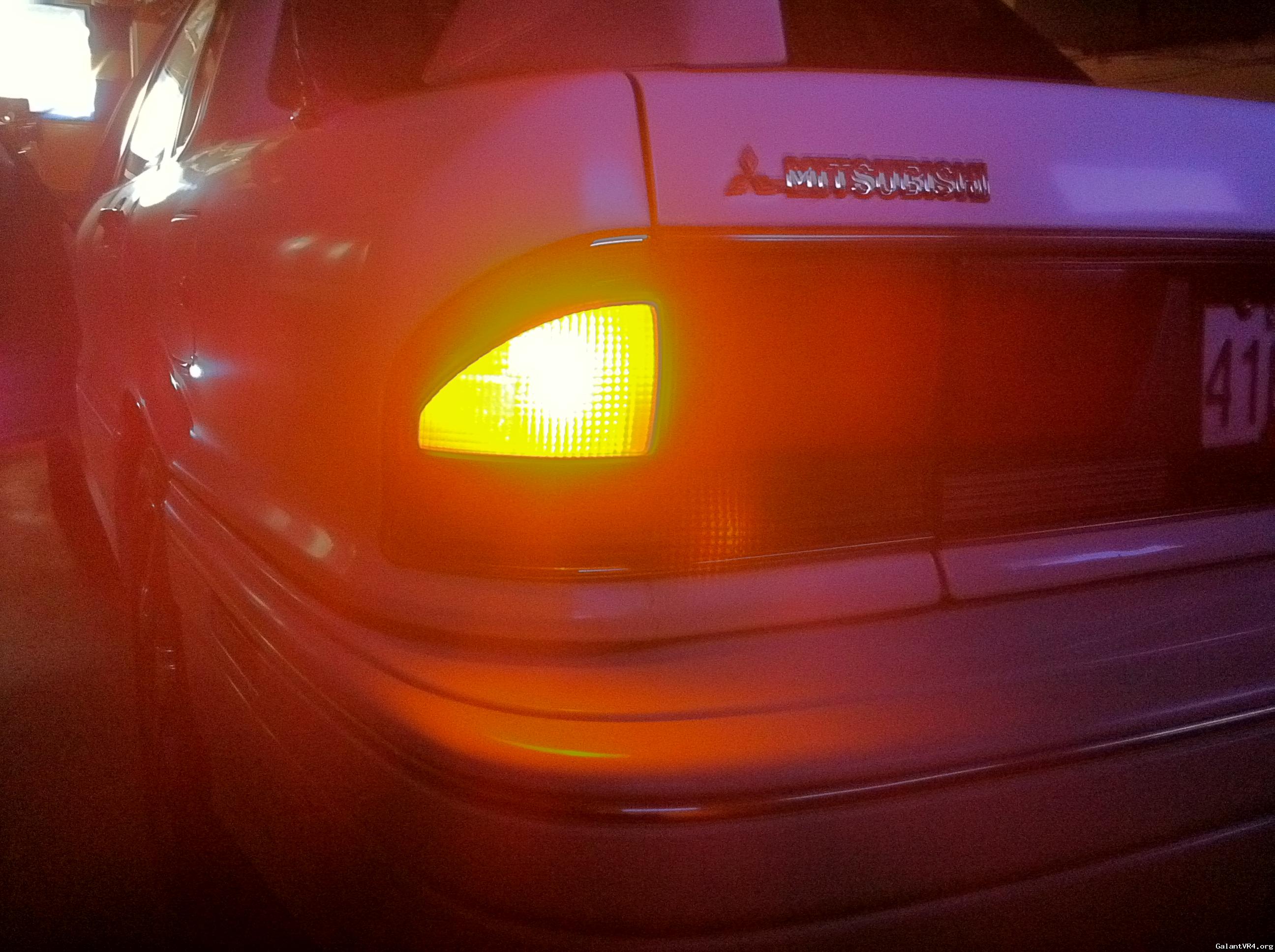

Flasher
V-LEDS.com LED I use for Backup, Flasher & Parking/brake

Do these have that instant on-off action? Like you see on cars with LED lights from the factory? That is the main reason I'd be interested in LED bulbs. I love the way the lights don't lazily come on and off.
Alainb7
Mar 24, 2011
60
Montreal, Quebec, Canada
Yes.
You have to change the flashes relay for an Electronic one because regular relay made flasher flash almost Like a stroboscope!
There is no fade in, fade off effect as regular bulb. LED is on or off, there is no fade.

I have leds in the cluster just as yours, same color, and the result is same too. I think its a bit dark/dull than the stock bulbs. What do ya say?

Quoting Specter:
I take these picture with my iPhone, here is one I take after install with a digital camera, you see better. The intensity is better than regular bulb.

Quoting AlainB7:
Quoting Specter:
Yes now that makes the result much more clear. Can you explain how many leds did you use for the cluster? What i did was, i modified the stock bulb housing and fitted a 2mm led with a small resistor in there. I guess my leds are too small.

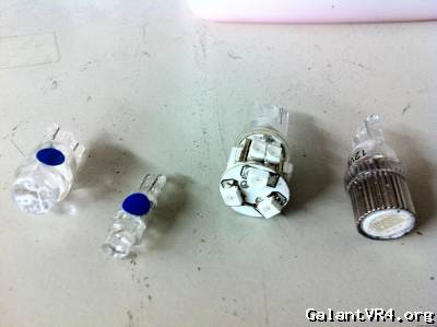

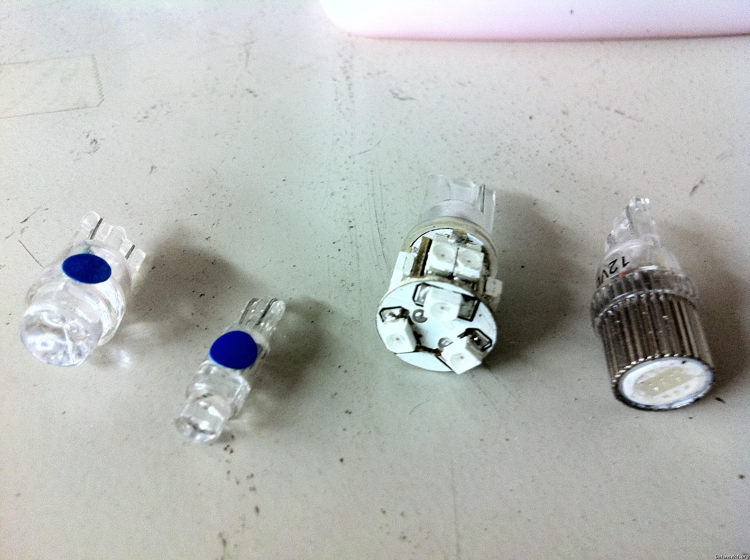

If you look at the picture with the only 4 led I put, the first is the one I tok to replace the cluster bulb and the second led is the one I use for climate control.
Now it look that they have more choice in LED and the LED with difusing lens is a bit different, but use them. click
When installing, just be shure that they are on god side for polarity because if positive lead is not on positive contact, LED will not light up.
Just have to replace existing #194 bulb for "#194 2 BLUE 1.5W LED BULBS W/ DIFFUSING LENS item" they came in 2 pack for 15$
