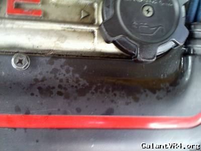

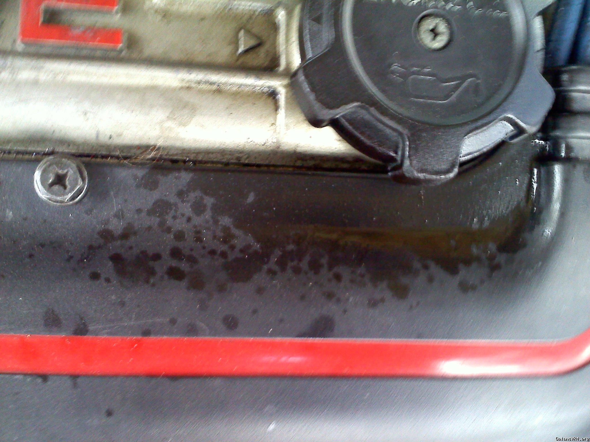

heres a picture of my oil cap leaking.....
is that a problem or should i just let it be
and if it is a problem will a new oil cap fix that?
The gaskets wear out and leak after awhile. A new cap or gasket will fix this.
mr.mitsu
Apr 28, 2003
798
canada
Replace the gasket or the next time you're at a junkers grab one from a car that looks kosher /ubbthreads/images/graemlins/smile.gif
replace the gasket. if i remember right they are only like 8 bucks or so for the gasket,or you could put a new cap on they run about 15
Quoting SleepinGVR4:
Or just stack 2 old gaskets on top of each other. I've done it before and works fine.
what he said no more leaks
