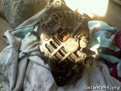

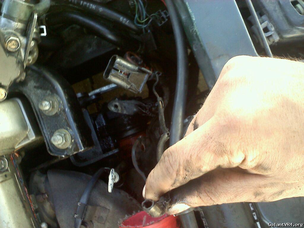

i FORGOT how where to hook up wires on alt
the only one i remember is the obvious the 2 prong plug
any 1 got any wiring diagrams for alternator or point me in the right direction
i just do not wanna hook it up wrong and then the first time i fire it up blow the alt.

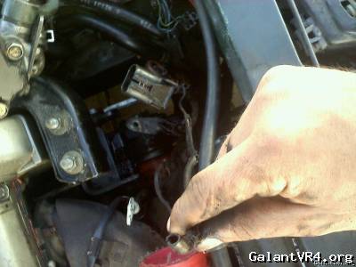

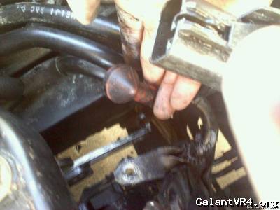

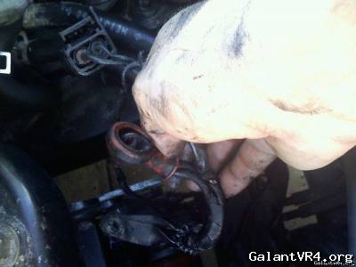

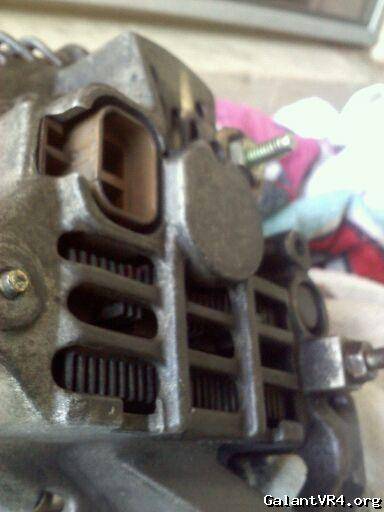

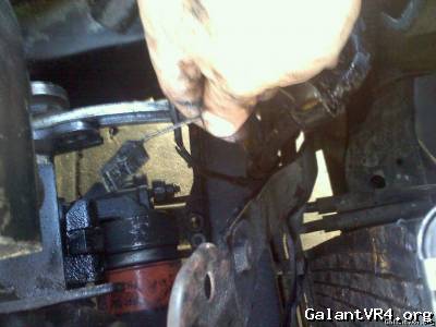

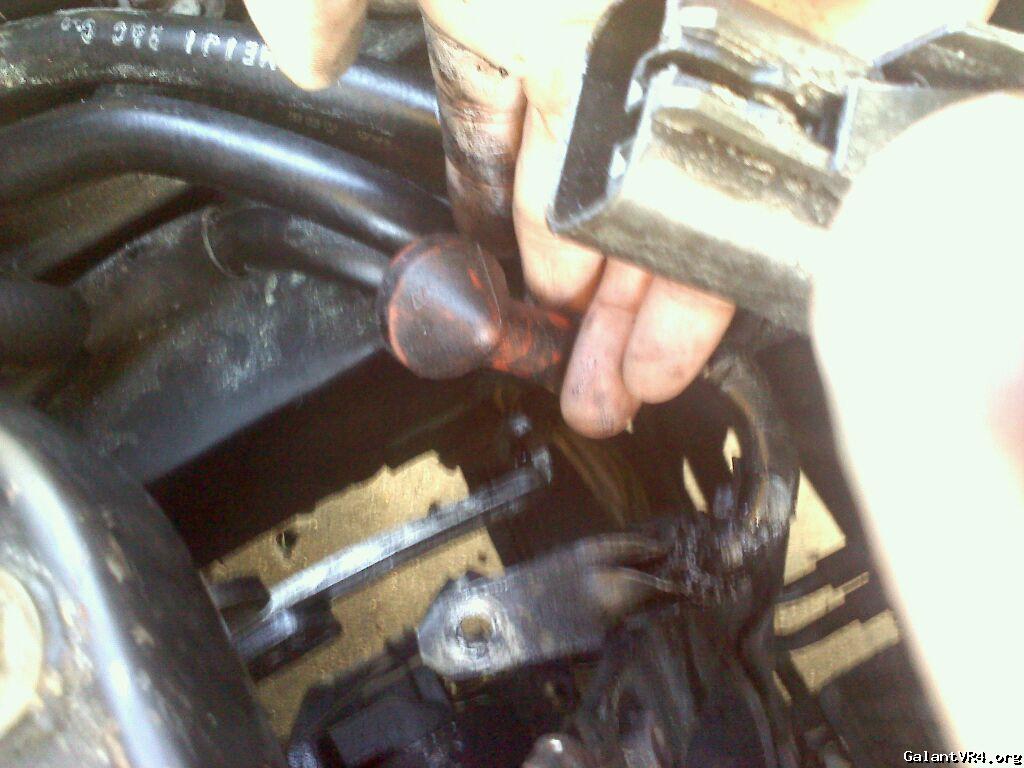

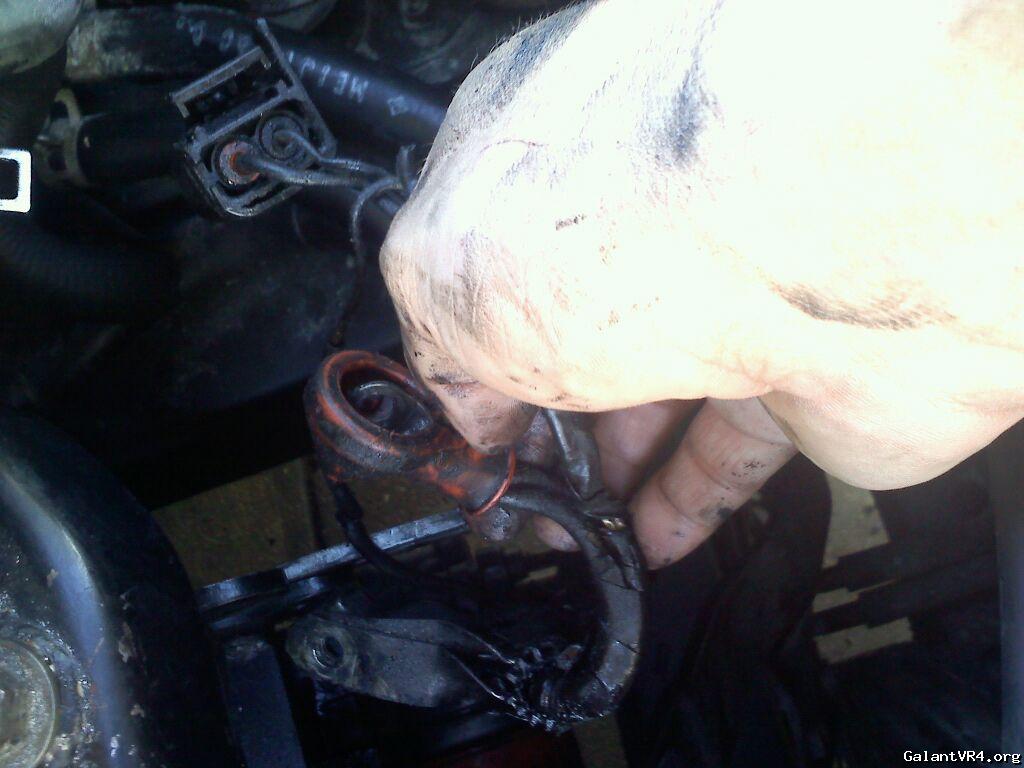

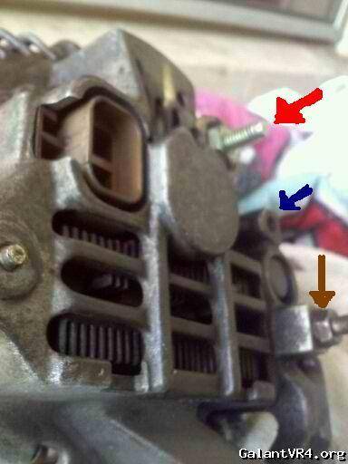

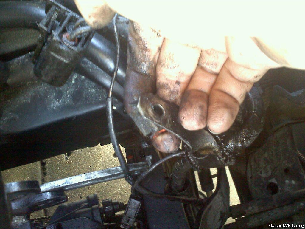

Quoting yeti:
That's the power wire that connects the alty output to the battery thru the 100amp fuse
Quoting Jepherz:
Wire in the 2nd pic probably goes to the dummy oil pressure sender.
I believe that is correct /ubbthreads/images/graemlins/smile.gif
This is just a bracket that gets a bolt thru it in the hole marked with a blue arrowin the bottom pic. All that bracket does is keep the the cable/wiring harness from getting intimate with the downpipe/exhaust.
This round guy plugs onto a stud style sender on the front of the power steering pump.
Power wire to stud indicated by red arrow
Bracket to blue arrow with a bolt (not shown in pic)
Bonus points for a ground wire installed on stud indicated by brown arrow. /ubbthreads/images/graemlins/smile.gif
You'll have to make your own wire.
A black 10awg wire works well, just put a ring terminal on this stud, and run the wire over to a ring terminal under one of the bolts that holds the power steering bracket to the block. It will help the alty case "see" a more consistent ground, and I've had good luck including it on all the alty's I've installed over the years.
[edit]
(yes, I know the alty should "see" ground thru the mounting brackets, but I've seen system performance increase/stabilise on every car I've installed this jumper ground on.)
ymmv /ubbthreads/images/graemlins/smile.gif
