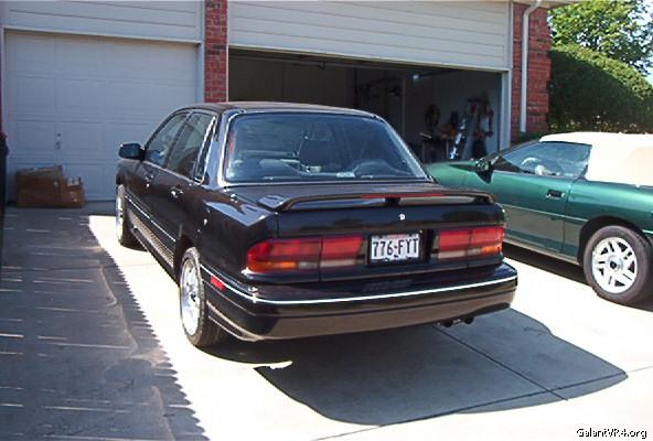

kschwab's 1991 141/2000
This used to be pisces' car, then Mika's.
It was already modded pretty well before I got it.

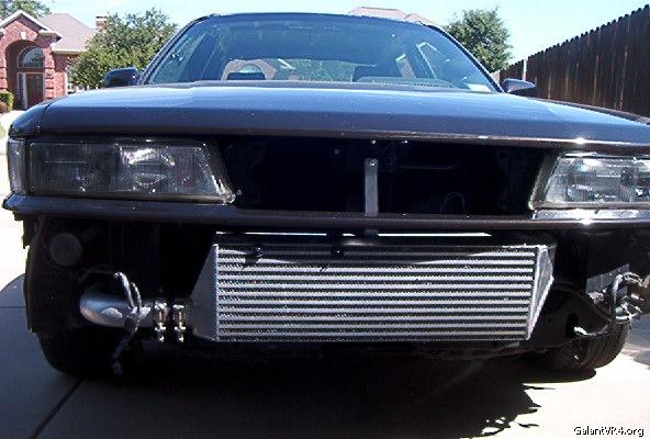

o Installed the intercooler, piping, added a nice Forge BOV

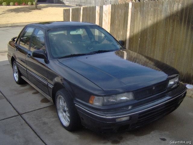

o Destroyed, then replaced the hood.

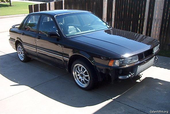

o New paint

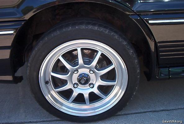

o 16x7 rota wheels with 225/40ZR16 Falkens

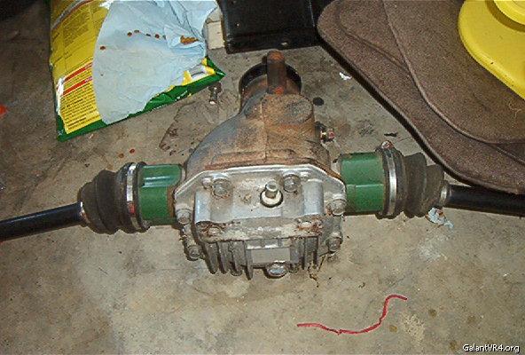

o Install the 4 bolt innards into my 3 bolt pumpkin ( want to keep 4ws )

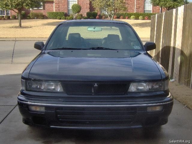

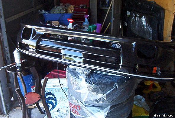

My freshly painted bumper cover

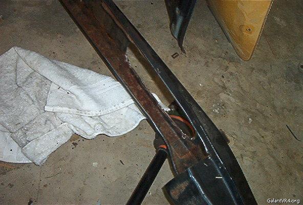

The hacked up bumper support
My 4 bolt. Plan is to buy a new 4ws gear, pin, and bearings, and install the guts
and axles into my 3 bolt pumpkin so I can keep the 4ws.

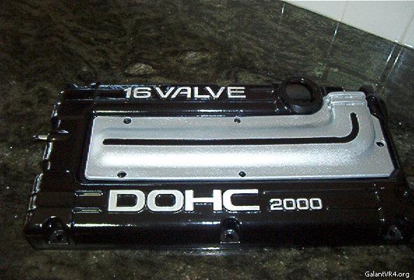

The ghetto-rific valve cover. Did this myself. Some minor imperfections, but I like
the way it matches the car.

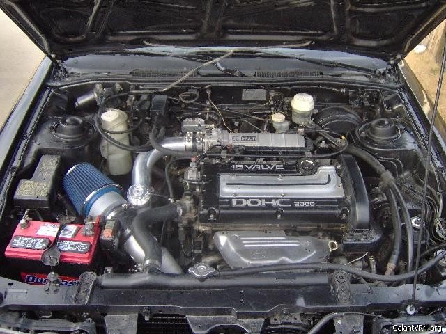

Engine Bay
Bumper Cover Back On
I love new paint

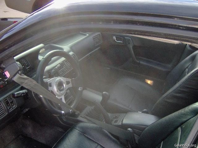

Interior 1
Interior 2
