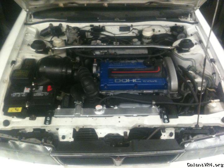

I have the Evo 3 installed in my Galant, the specs listed on their website are pretty accurate but don't paint the whole picture.
These are the measurements I took with my mic when I put it in.
OEM Radiator:
End Tank top/bottom: 55mm
Core: 34mm
Koyo Evo III Radiator:
End Tank top/bottom: 61mm
Core: 53mm
The 61mm end tanks on the top and bottom are pretty big and will require a fabricator with a deft touch to get piping to go the stock/ets route for a front mount. Also, as mentioned before it does sit an inch lower than a stocker so you'll either need spacers at the bottom or not mind it sitting a hair lower than stock.

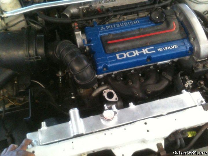

I have an Evo3 Aftermarket Aluminum Radiator in 1855.
It fits very well, I only needed to shim the bottom mounts using spare piece of silicone hose that was around 1/4 inch tall (can't recall exact measurement). To get the top Galant mounts to "hold" the Radiator correctly.
As far as the OEM fans bolting up, I didn’t use the OEM fans so I don’t now if they mount up correctly. I did a slim puller and pusher set up in the OEM configuration.

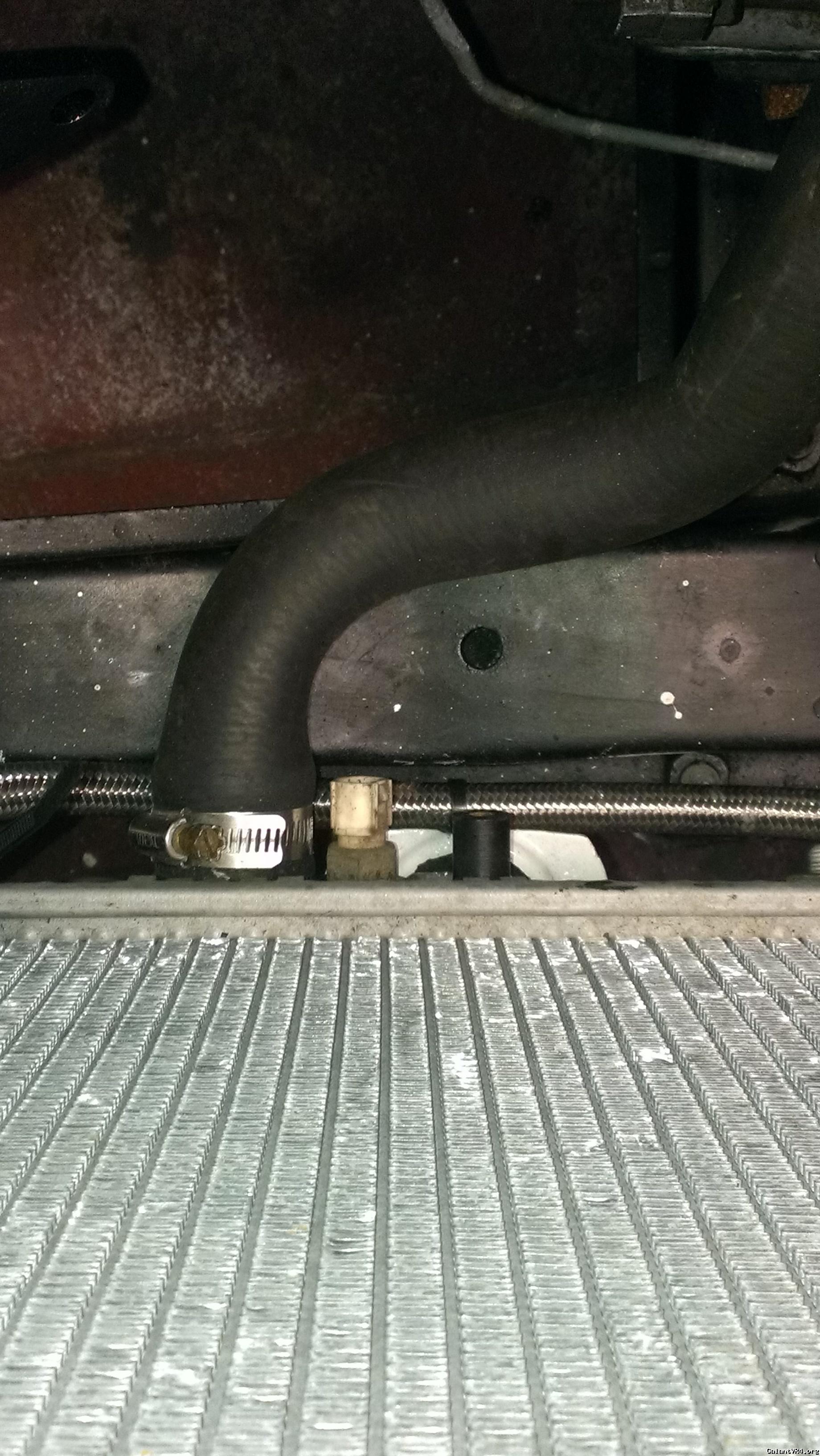

I have a DSM rad and the top is low like everyone states but the bottom connector is a little too close to the lower cross member for my likeing. It should ideally be angled up some. Just throwing that out there.
Edit: Actually after closer inspection the bottom port should be about 2 inches toward the driver side. to where this nice groove is.

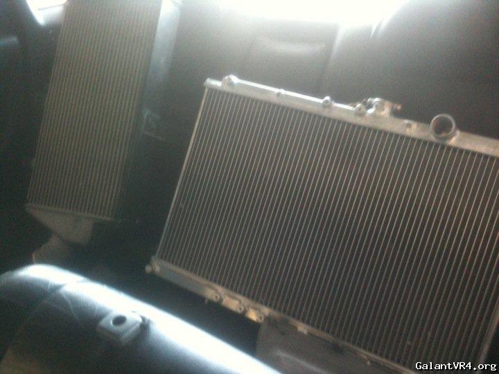

Bringing it back from the dead, but I ordered a Koyo EVO 3 radiator for 570. I'm fine with it being a little shorter than stock, but I am not alright with it not having a bung for the fan switch! I will see if the part number was on the box and post that as well, but if anyone else has the KOYO, will you chime in if yours has a bung for a fan switch or not?
Edit-Apparently their are 2 part numbers R/HH030561. The "R" model is a 53mm core while "HH" is a 48mm core. I'll measure mine and update which is which.
