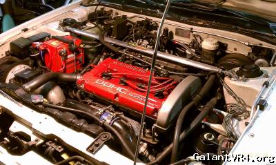

With either one of these radiator fans, will I be able to fit another fan on the driver side? I was thinking running 2 14" fans to run together inside the engine bay and leave the AC fan alone with its original function.
Post a picture of your current setup. What I did was stuff a 10" fan in front of the condenser on the passenger side next to the condenser fan. It's a very tight fit & I had to trim some of the meat off the fan housing. The factory condenser fan is badass & you're not going to get any aftermarket fan to outperform it.

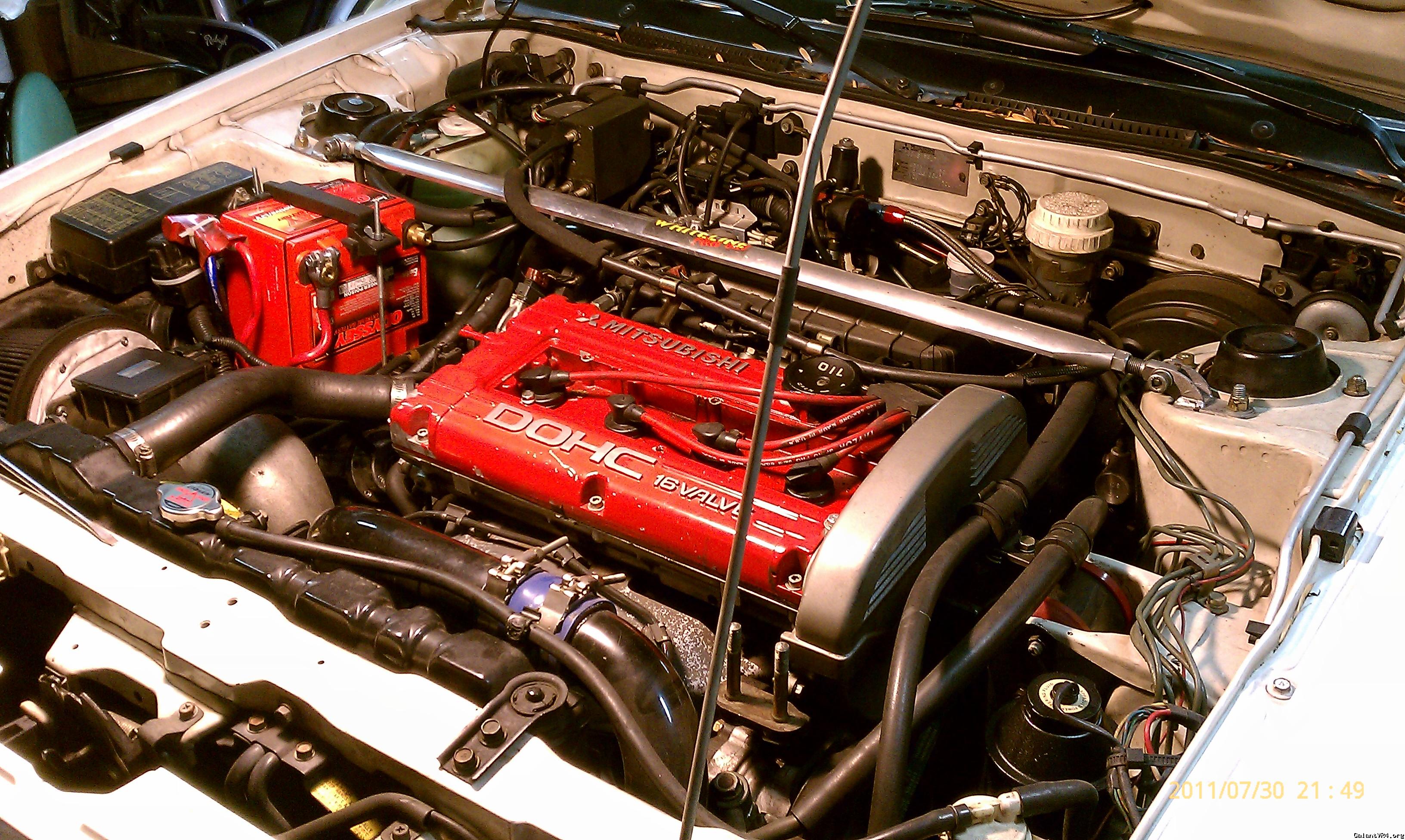

Here is a picture of my engine bay that I had on my phone. I'll take a top to bottom later today:
Evo3 Turbo, ETS Piping going through the top.
