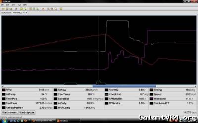

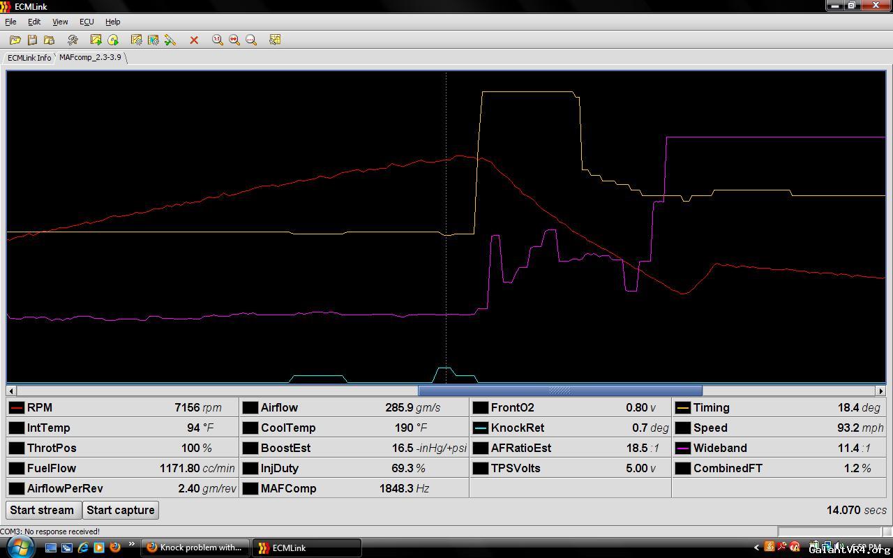

Thanks so much for the input guys! I'm learning a lot through this process. This knock will be a huge benefit in the long run.
So here is what I've done. I lowered the fuel pressure to 37psi using the ECMlink diagnostic mode. I then set my global to -53 and deadtime to 330. Started the car up and fuel pressure was at roughly 39psi. Left it at that for now (getting eatin alive by mosquitos and was running out of time /ubbthreads/images/graemlins/banghead.gif) until I really learn how to tune....when I do, I will then start from scratch. I then played with global and deadtime a little, since FP was not exactly 37, and got the idle A/F's and part throttle pretty decent Averaging 14.9ish over a period of time.
From here I tweaked MAFcomp a little to bring down my A/F ratio to low 11's. I know I am missing some steps in my tuning process, but I am in the learning process and have huge overload from all the reading I've been doing. I have questions about tuning with ECMlink and will get to that in my next post. After adjusting MAFcomp to enrichin the A/F ratio, this is what I ended up with:
From this log you can see that the knock dropped to almost zero counts across the board!! The 3 logs right before this one (as I was adjusting the MAFcomp) showed similar signs of knock to the knock I was getting before these fuel adjustment (richer), but was improving after each adjustment towards low 11 A/F ratios.
ALSO I MUST NOTE: All of these logs were done with 92octane gas from WAWA(cheap gas). I will be filling up with Sunoco 93 octane fuel only from this point on and now that I'm actually learning to tune and do things right.

As far as tuning you should really be at 11:1. You need to post logs too, that is 1000x more useful then a screen shot. We can go into the log and see all the settings you have your car set to.
