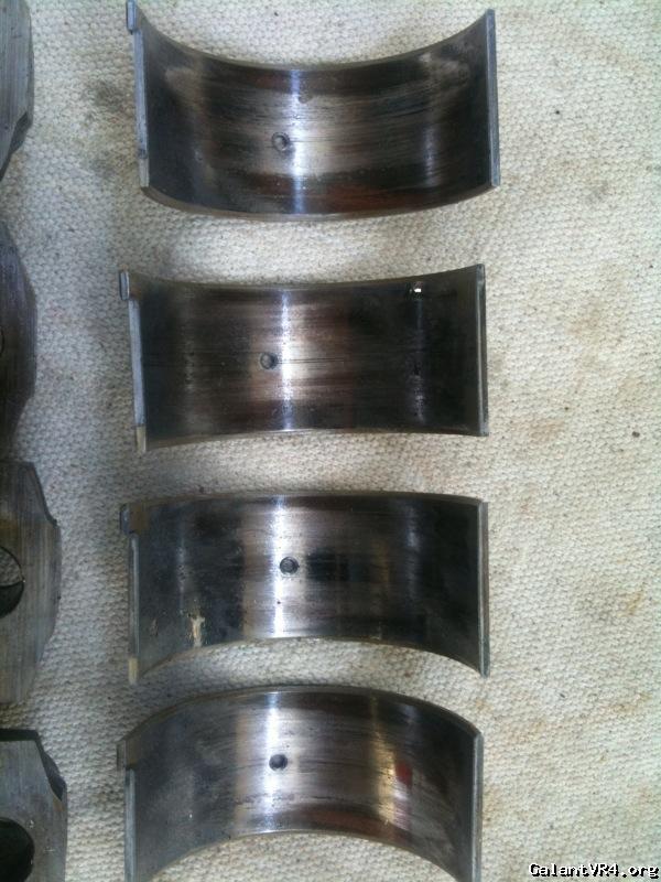

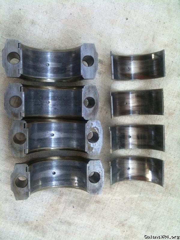

I took the rod bearings out and they don't look as bad as this would have caused the knocking. Or does it?
The surface does feel like a very fine sandpaper though.

The marking on the bearings are D9F
Are these standard or over sized?

OK so the new rod bearings are in and the engine still knocks the same way as it did before. WTF?

Quoting Rausch:
^ Those bearings are chewed.
Yeah, you do have a point. Reminds me of when 1051 had a flywheel bolt back out. Mark and co thought it was a rod bearing. Take the bearings out, they are fine, but well worn. So not really a bad thing since they tossed some fresh ones in.
