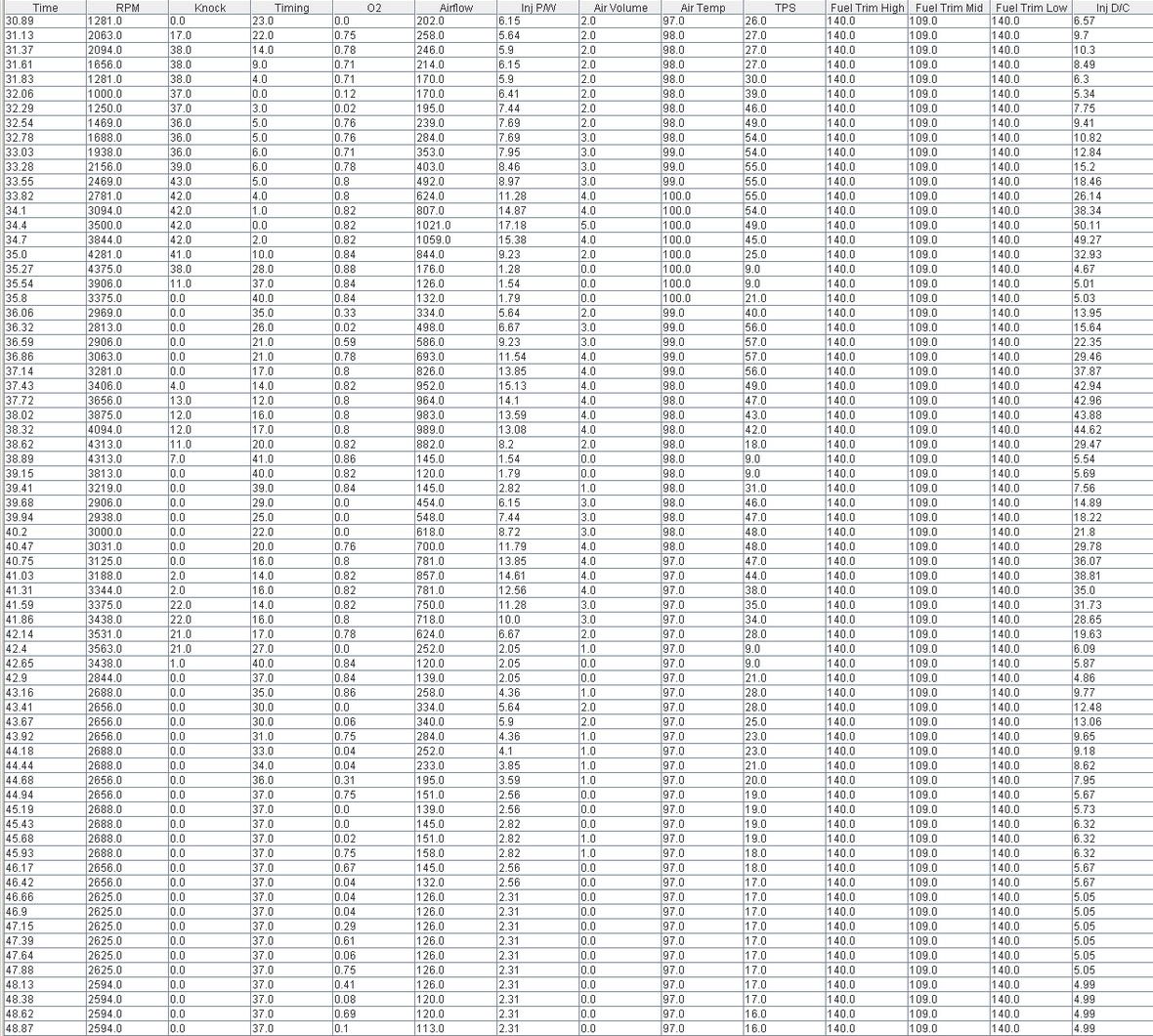

Basically, I'm seeing huge knock counts in the lower RPM range and lower TPS position. If I go WOT, the knock never, if rarely shows up, but it does occasionally. If I baby it (50% tps or less), it shows it's face the most, but not always, and it's really messing with any driveability the Galant once had. It seems to be staying steadily the same, but perhaps just getting slightly worse if any.
The only mods are FMIC, 2.5" in/out, Small 16g @ 12 psi, stock MAF, stock FPR, Walbro 190, 2.5" DP back exhaust, stock 450's. Rebuilt top and bottom end, possible 2g piston swap (unsure about that one, not sure if it matters for the issue). I previously had a 14b and stock fuel pump, and I was still feeling the timing pull before putting the Small 16g and 190 pump on. I originally thought it was the 14b living out it's death.
The knock only starts at the onset of boost. Stay out of boost all the time, there is zero knock.
I have replaced the O2 sensor and Knock sensor with brand new units. The knock sensor is BWD, the O2 is Bosch. With that, I almost have ruled out Phantom knock, but I suppose it could very well be. I have also replaced the top and tranny mount with Prothane inserts, but I don't recall seeing knock after swapping those, and I just recently put the front Prothane in as well, although I doubt any of those are the issue, shouldn't be anyway.
Pretty much at a loss here, as I've done everything possible including new NGK's gapped properly. It does not seem to misfire one bit either.
All I have to go on is the most recent log. Hopefully it can be of some help, or any of the above, any help is much appreciated.
I'm almost at the point of believing it's a bottom end issue and should be torn down, however at the time of purchase, I was told the motor top and bottom has been rebuilt, the head looked fresh, that was about 12,000 miles ago. There is also an unusual tinny rattle sound as the RPM's increase and consistent with the RPM's, no where near a rod-knock sound, not a lifter tick. It actually sounds like a failed hydraulic t-belt tensioner as I've experienced in the past, but that feels solid and there seems to be no more than normal slack in the timing belt. It also has a BSEK with the stub shaft. I suppose it's possible something may have failed there possibly?
The timing, both mechanical and electronic is dead on as well. I thought about pulling the timing back to around 2-3 degrees advance instead of 5 degrees where it is currently set, but with the mods and relatively stock boost level, there is really no reason it should be knocking at stock timing.
Anyway, I'm hoping one of you can chime in with easy things to eliminate as a possible cause before I dig deep into the motor.
Any help much appreciated.
Thanks!
What's with the 140 fueltrims? That's VERY lean. Are you leaning it out with an AFC or something?
Does the knock stop as soon as you let off the gas, even the slightest?

Like Jeff mentions the trims show a massive lean condition.

I have zero tuning ability. Only pocket logger. The knock seems to stop the second I take my foot out, it mainly knocks right at the onset of boost, which is what is really making me confused as to why it would knock at only 1-3 psi, but I can at most times WOT at 10-12 psi see only 1 or 2 counts.

That's also what I was thinking. Although the trims are a long-term reading, I can definitely see the lean condition there now that it has been mentioned. The spark plugs also showed a slight whiteness to them when I had them out the other day (right after replacing them and a good drive) and the number 4 plug was slightly fouled with white speckles before I replaced them.
The condition did not seem to improve or get worse after I replaced the stock pump with the Walbro 190, other than starting. The first few days after the pump swap, it took 8 or 9 cranks before it would start, for whatever reason I started it today and it fired right up. I have been suspecting crappy gas, and after pumping 5 gallons out to stick in the new GSX, the next day was when it started right up. It has also done so the last few attempts, although it seems to be a crank more than it used to, but that's cold start. So far, the GSX seems to have no problem with the gas that was in the Galant. I'm not sure that crap gas could create a lean condition, but correct me if I'm wrong.

One more thing I forgot to mention, do the IDC's look low?!? Or is that consistent with the 1g Maf/ECU and what the ECU would be calling for?
I'm looking at the airflow of 1,021 Hz and an IDC of 50.11. It seems like the injectors should be more than halfway maxed considering the ECU reads a max of 1,600 Hz, but I could be way off in my presumption.
The ECU can read a WHOLE LOT more than 1606 Hz, you just can't log anything higher than that.
As lean as you are, I'm going to have to go with the suggestion to do a boost leak test ASAP.
