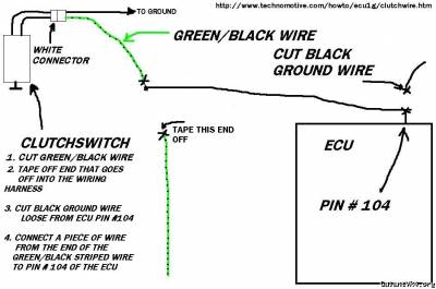

Yep. Also requires that the clutch wire switch be wired to the ECU per keydiver instructions. If it doesn't bounce off the two step with the clutch in (somewhere around 4500-5500 rpm depending where you set it), then its not hooked up right.

^^^I had no use for a stutterbox, so I didn't have you burn it to the chip Jeff.
Chad: remember that one of those clutch switches is unplugged so you don't have to push the pedal in to start the car.

ah the keydiver studderbox is nice you will love it if you get it burned into your chip. Very easy to wire in also. Make sure you cut the pin 104 wire.. i didnt and the car would not start...opps. I was out using mine tonight. I've found the 3rd setting works the best /ubbthreads/images/graemlins/laugh.gif
