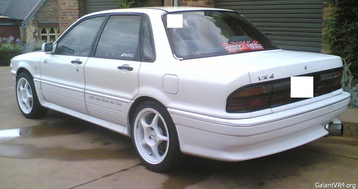

Car:
Mithsubishi Galant VR4 Jap Spec Jap Imported 91 Model E39a
Soon To Be 2.4LT Conversion So Aiming For 360Kw @All 4 Wheels
And Ragoli Racing Australia Auto With 3300 High Stall
Power 150Kw @All 4 Wheels @ 7700rpm (7psi)
Power: 320Kw @All 4 Wheels @ 7700rpm (22psi)
Weight: 1380kg with driver.
Time WAs: 12.59sec On (7Psi)
Havent Run it On Track Yet On (22Psi)

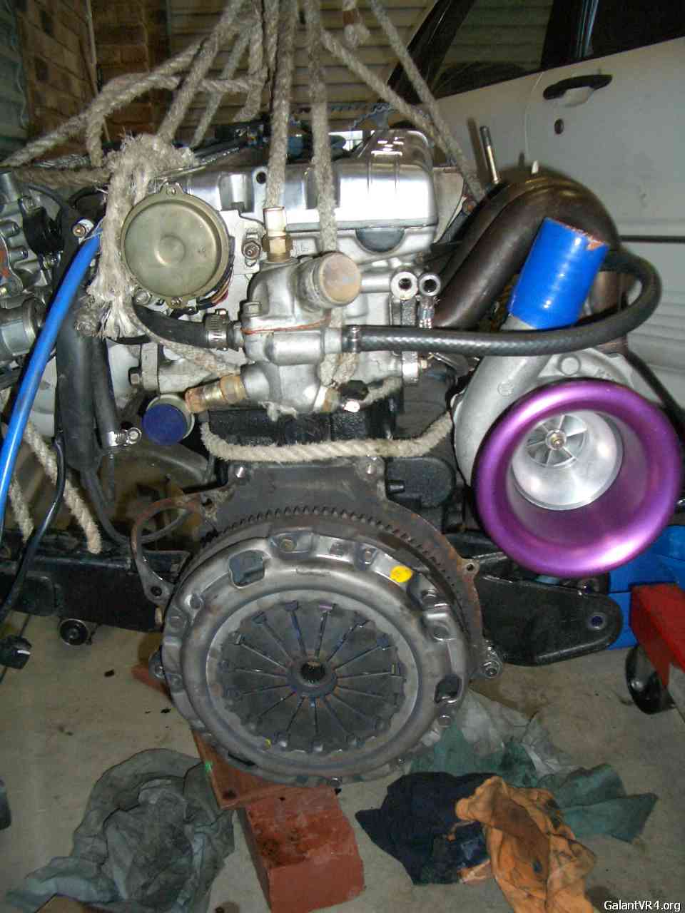

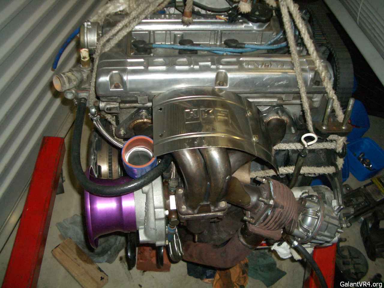

Motor:
4G63T
ARIAS - Arias Forged Pistons Mitsubishi 4g63 Vr4 86mm Bore .826 Pin Supplied With Rings
Eagle - H-beam Conrod Set Forged 5.906" With .827" Bushed Pin, 3/8" Rod Bolts
ARP - Head Stud Kit 12-point (under Cut)
HKS 3.00MM Head Gasket

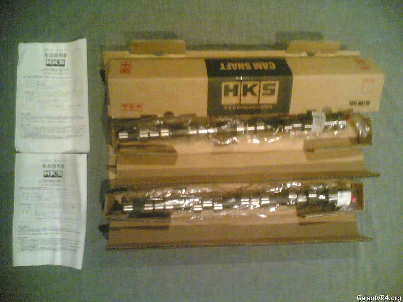

HKS 272's Cams Intake 272Deg Exhaust 272Deg With 10.3 Lift
Custom 13mm Lift Valve Srings
ECU: Microtech LTX8 With Bosh Coil Packs
Speed Freaks Radiator Header Tank
Induction:

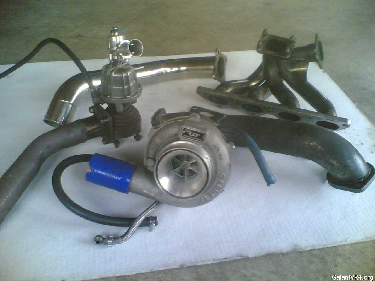

HKS GT 3037S Pro Roller Bearing Turbo 550ps
HKS 3037s Pro Turbo 550PS
HKS Intake BellMouth
HKS Cam Gears
HKS 820 Injecters
HKS Fuel Rail
HKS Sprak Plugs
HKS Turbo Timer
HKS Timing Belt
HKS Oil Pump Belt

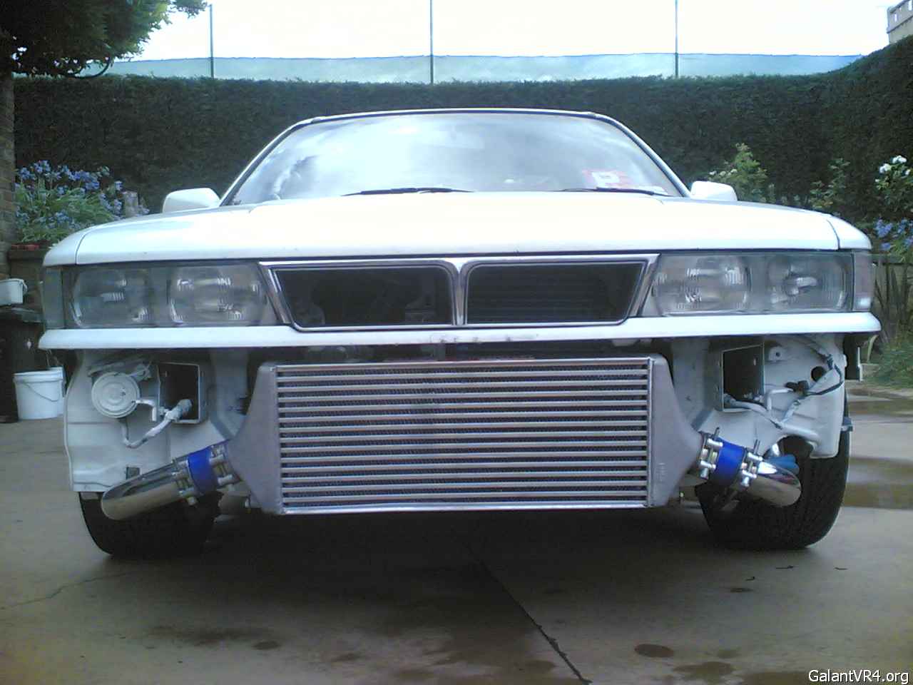

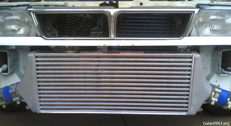

Custom Intake Plenum With HSV Gen III 90.00MM Throttle Body
Stailess Steel Polished inlet and intercooler piping.

Gready/Trust 58.00mm External Pro WasteGate With Screamer Pipe

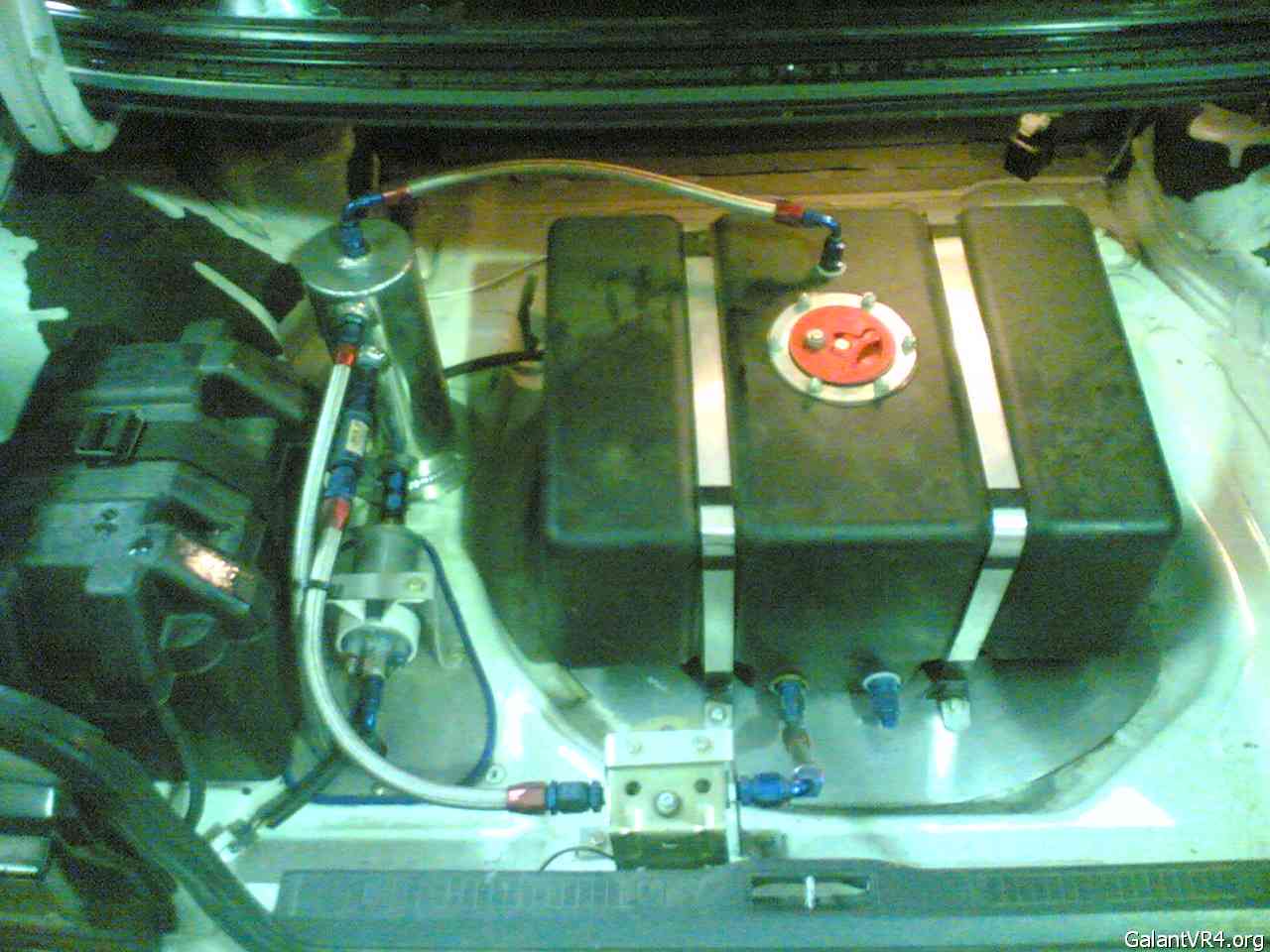

Fuel System:
38 LT Race In Boost Tank
External Lift Pump
Bosh 044 External 700HP Pump
MALPASSI 1:1.7 Fuel Pressure Regulator Kit

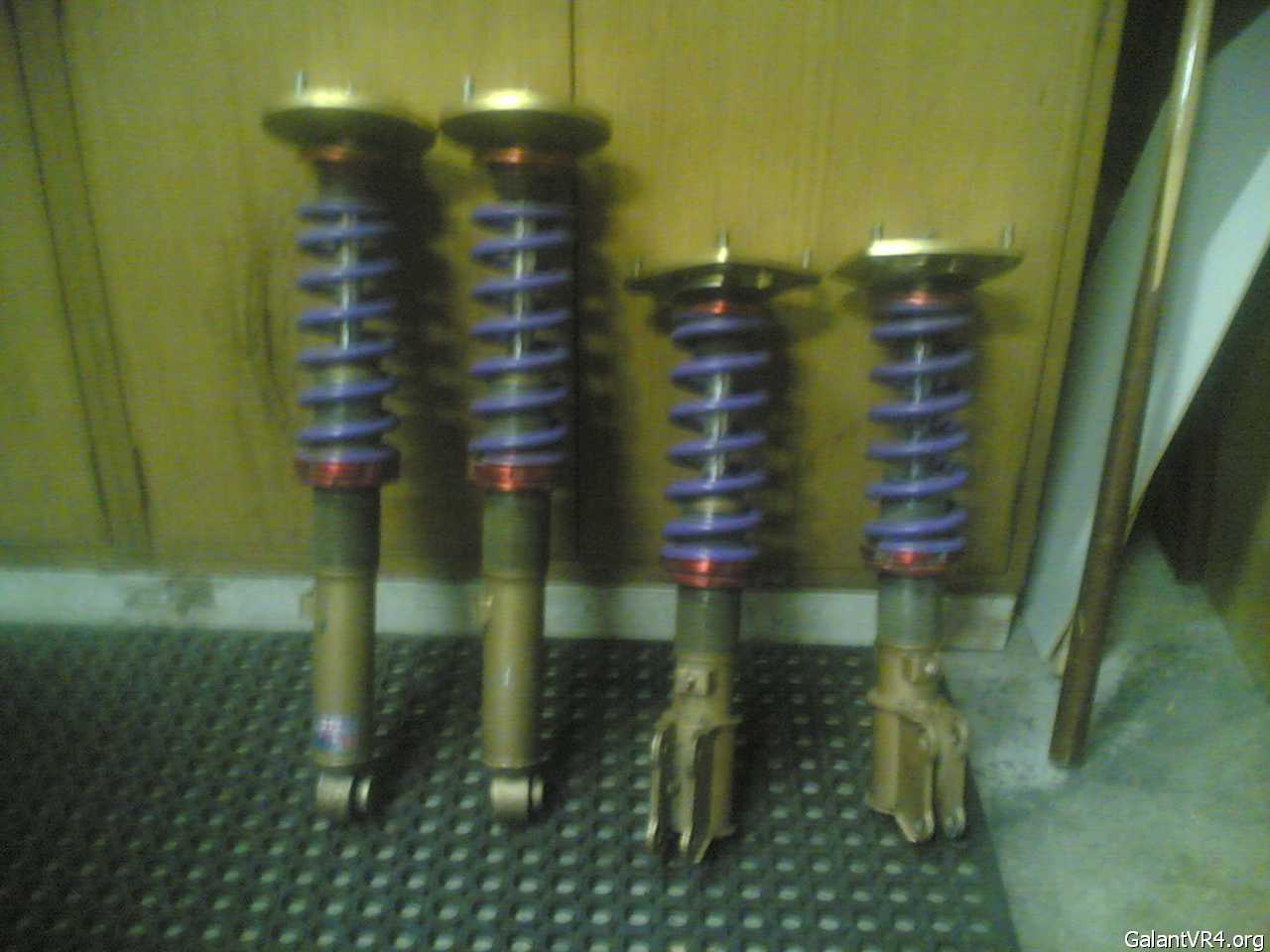

Suspension:
JIC Coilover's With 4 Cambertops

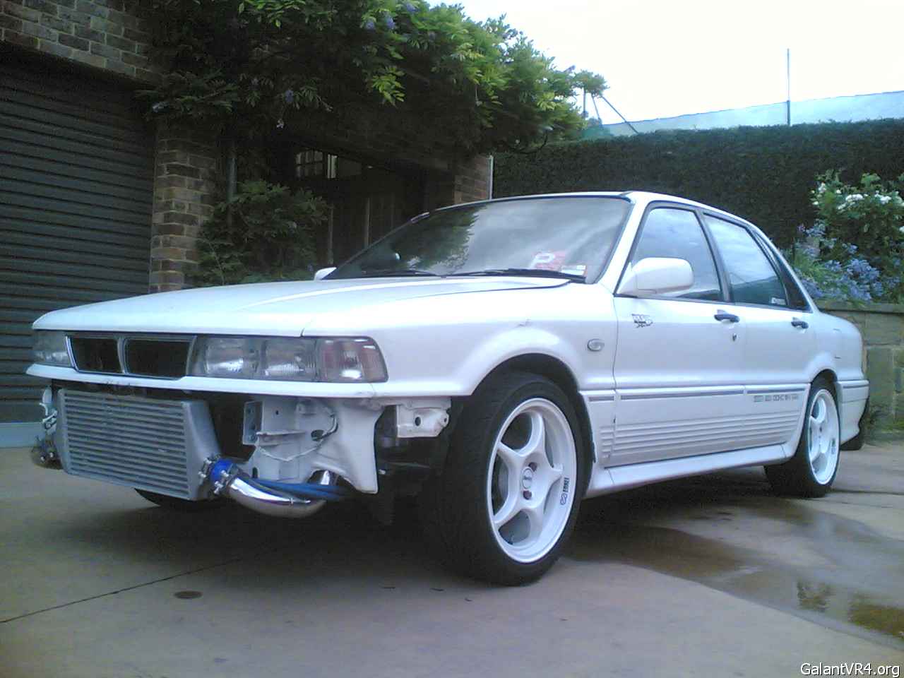

Exterior:
Standard Jap Spec Factory Body Kit
Soon Evo 7.5 Bonnet Vent
Custom Alpine White With A hint Of Blue
Under Car Neon Kit All Round
