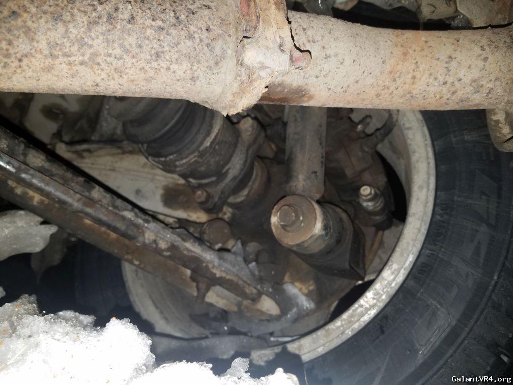

just need to know if this is a 3 or 4 bolt rear end (pic)

I have read that some 92 models came with a 4 bolt rear end. Although mine is a 92, this looks like a 3 bolt one if I am going by axles bolts.

ALL USDM GVR-4s were 3-bolt, it was the DSM that was 4-bolt but I am unsure of the years, think it was 1G-B 92ish onwards but I'm sure someone will correct me.
The JDM GVR-4 had 4-bolt from 1990 onwards but only the Evolution models. They also had LSD's - a 1 way clutch pack LSD for the E38A RS without 4WS or a viscous LSD for the E39A with 4WS.

Might have LSD in the AWD cars, but if they are all 90s they won't be 4 bolts. For your type of activity though you probably don't really need a 4 bolt.

The differentials say LSD right on them. If it has popup headlights and has not been modified then they are 3 bolt rear ends.

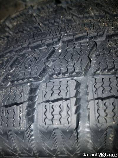

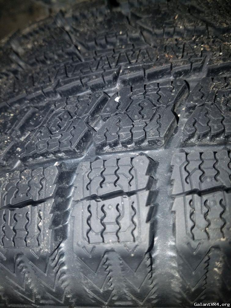

What kind of tires are you running on the ice? Ice style winters and or studded versions of same?

90-91 DSM's that don't have ABS had LSD 3 bolts, 1G's with ABS & galants all had non-LSD 3 bolts, and obviously 92+ DSM had the 4bolt LSD.

Good ice racing yesterday. I use Toyo Observe GSi 5 tires. Only a 2012 Suburu STi beat me, but I was on his tail within 20 feet the last 5 laps! Passing is the tense part because no one really wants to get scraped! But for the most part, we made it another race day here in Alaska. The Galant is rather impressive and people gather around each time I exit since I am running with and ahead of 20K+ dollar cars. Very little body roll and nice flat cornering. It gets revved to redline a few times. And at the straights, we'll be almost 60 in third before tossing it into a 20mph corner and powering out in 2nd. Believe it or not, a 93 Talon, stock to the bone (with excellent nonstudded ice tires as we all have) is the most formidable, but he snow-banked it on the 6th lap. The Talon has a 4 bolt and LSD rear. So he really powers out of the corner beautifully! Thus, my pursuit of just a little more wheel traction. Drivetrain wise, with all the ice giving way, I don't believe the drivetrains are stressed. They just rev up faster! I'll post a clip here shortly. Here is my daughter who drove one race as well. The car is literally in perfect shape, missing nothing but balance shafts with no dents and original paint all around. I lost my driver's dog leg trim behind the rear door on an "offtrack" excursion when i rushed a corner too fast, but picked it up undamaged afterwards. so that part you can just see, is missing. It's in the back seat.

That is a great grippy type tire, we have quite a few of our customers cars using them here. In fact we equipped my dads '15 Forester with the same setup and it handles great.
